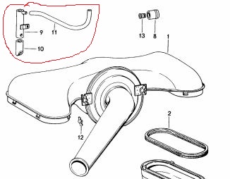

I have an aircleaner box that still has the squirter manifolds and the fuel line that feeds them.
I thought it would be cool to leave them in and mock up the connection.
Does anyone have a pix or know where the feed line for these connected and how was it routed??
Could not find it in PET or the shop manual. From what I can learn, the 911 one was connected to a T and a solenoid that was in the tunnel. What about the six??

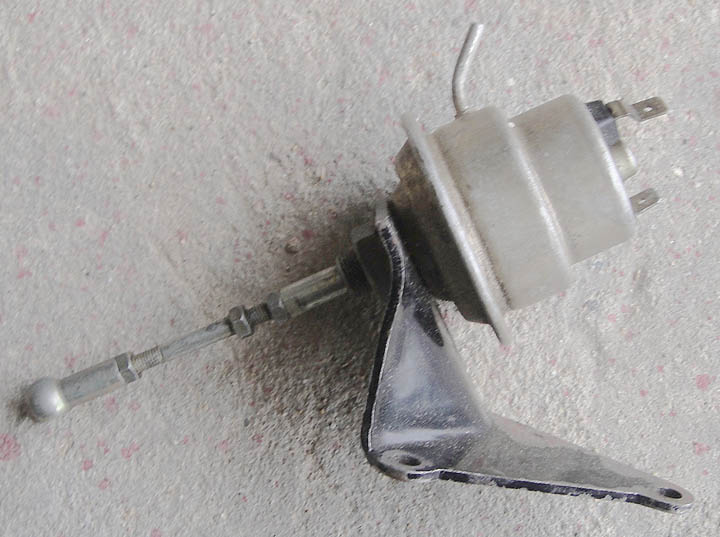

Also, here is a couple things about the 'dashpot'.

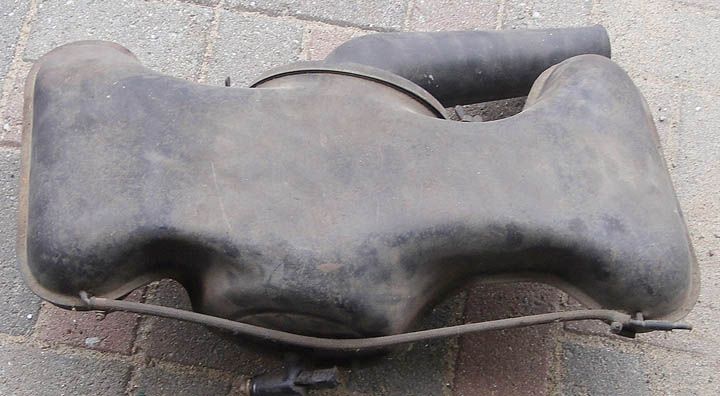

Here is all I found
You can barely see in the airbox the two holes that were plugged and the
clips that hold the lines, which may not be the lines in my pic.

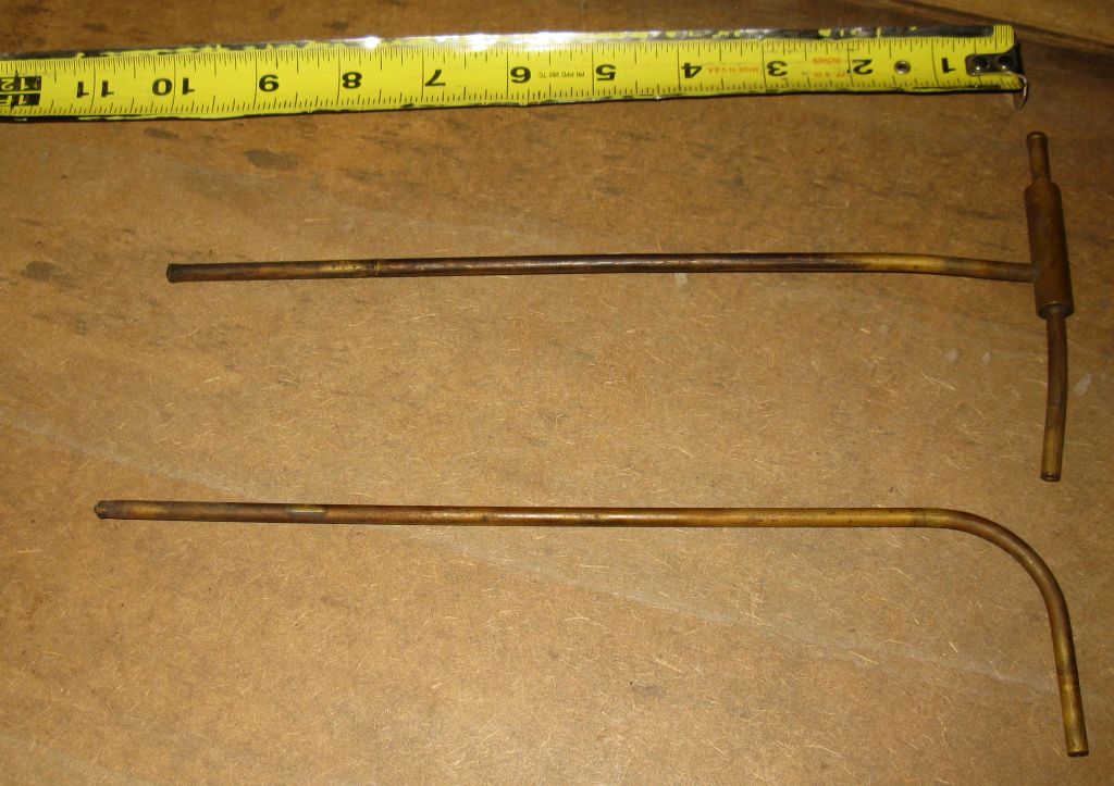

Yep, those are the lines that fit in the air box. I actually have two of the 90 degree ones and one of the tee's. I also have the outside braided fuel line that connects them. That's all I got.
Fiddle with them a bit and you will see how they fit in the air cleaner box holes and clips.
I am traveling this week and can not get pix.

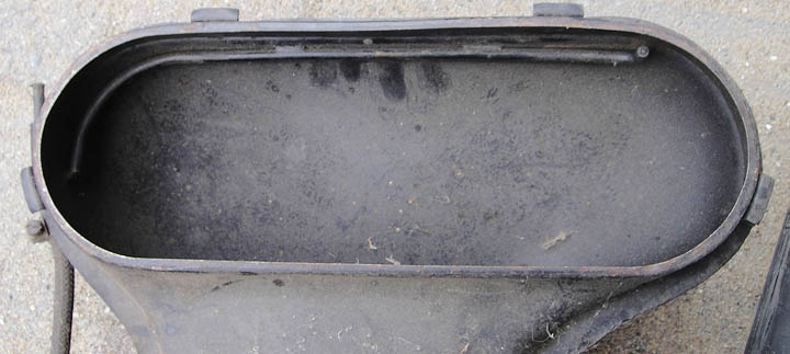

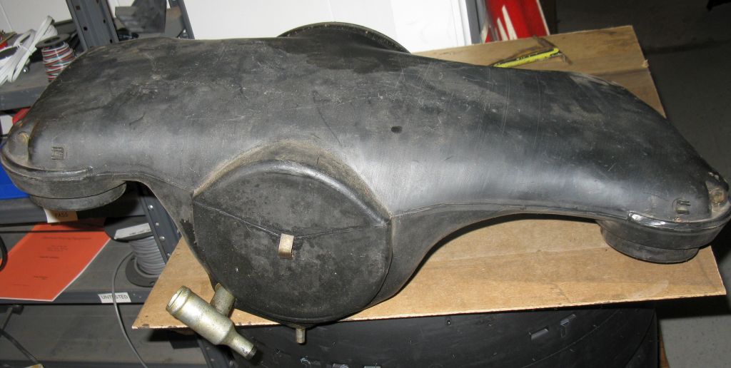

Here is the dashpot that was removed from my car back in 1973.
Being a packrat, I kept it.

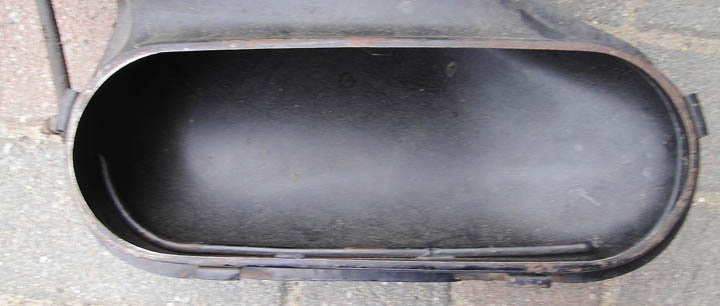

This is a metal airbox from a 1970 era 911. Probably Zenith Carbs.
It still has the cold start stuff inside it, but it is welded in place on these metal
ones. This one still has the fuel line connecting them together.
But I have never seen the solenoid or the fuel line tee that fed them.

Cool. It appears that the metal box squirters were centered over the carb intakes. The plastic ones are Tucked. Along the side
No w the stuff is coming out to the light of day. Someone must have the rest
Is that a six snorkel? I thought all of the 911 ones pointed the other way

Snorkel may be from a six..
Here is the inside of the metal airbox with the
fuel lines attached..
mskala

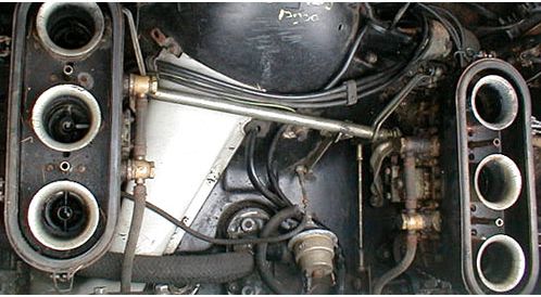

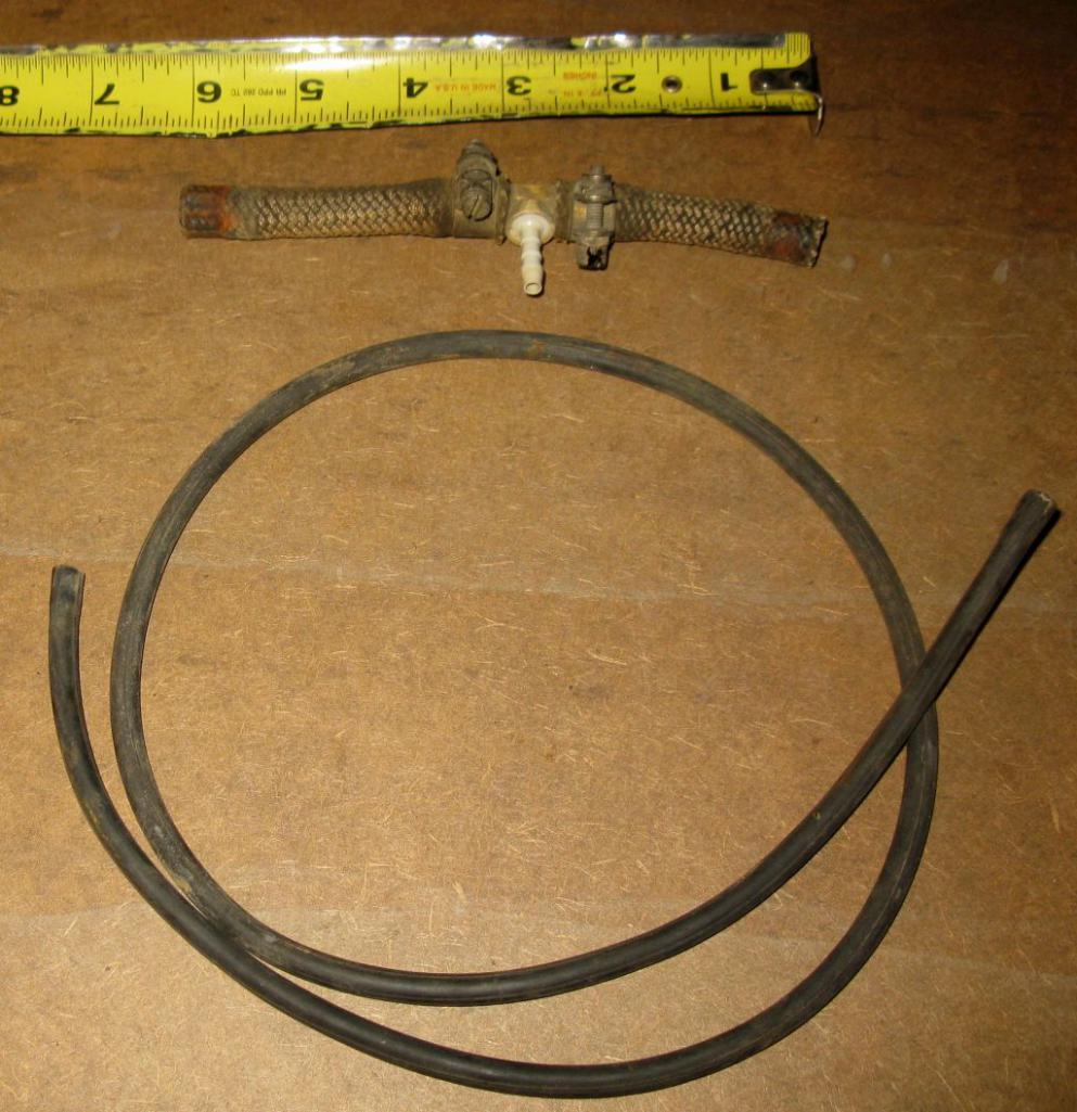

Found this T and this un-braided hose.

yea, sorry. So the squirters enter at the center but then bend to the sides like the plastic box ones.

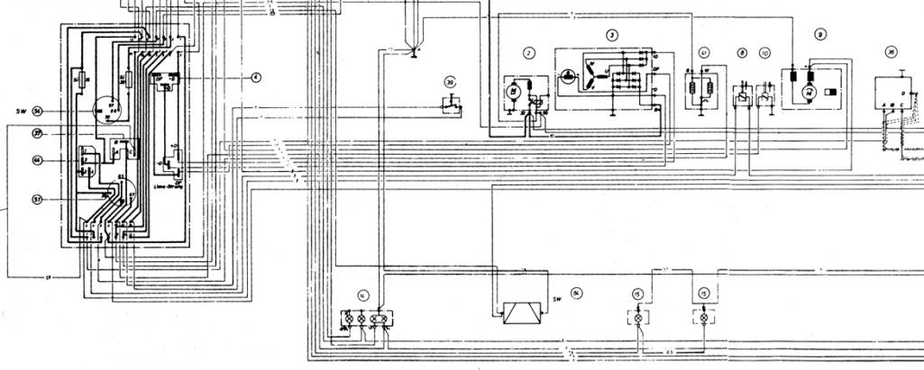

Here are a few images that show
The exhaust emissions control and a speed switch attached to the relay board.
Although it mentions the fuel squirters in the airbox, it doesn't say anything more about them.
Also, I can't remember ever seeing the water drain they mention.
A solenoid in the tunnel would mean the fuel lines were not 1 piece going through there.
I haven't replaced my original plastic fuel lines yet, but have never heard anyone mentioning a splice in them??

Not the greatest wiring schematic.. But it does show # 10
is for cold start..
