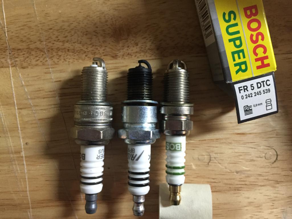

Cyl touching? (Does it have High CR pistons? does that bank run a lot hotter then the others?)
Dropped during installation?
Running SOOO hot it is melting the electrode? (highly unlikely in an aircooled engine or likely toast by now?)

The only thing I know that would cause this would be the wrong plug (thread body too long). Your pistons are making contact with the plugs. Bad deal.

After reviewing the photos again, I believe this is your problem. The fact that some are touching and others are not leads me to this result. The plugs are certainly carbon fouled. I also agree that shimming the plugs would be a temporary fix. Getting to the source of the over rich situation is the real issue. Fuel, valve adjustment, timing etc. Good Luck!

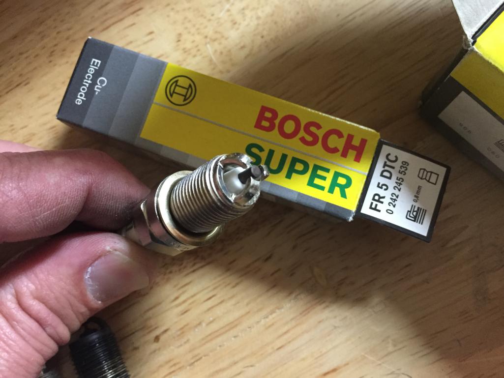

I don't think the plug length is the issue. The plugs were installed by the shop that built the engine and they use them all the time.
I also had several other new plugs in the garage are various brands for Porsche six cylinder engines, and they were all the same length.
So, just to test, I installed a new set of FR5DTC plugs. They aren't the best for this 2.0 engine (they are correct for the 964 3.6) but everything runs and sounds fine. Vrooom. I've ordered a set of WR5DC (what CDI box mfgr/PartsKlassik recommends) that I'll replace these with.
The tach seems more bouncy than normal with the CDI box, but I'll take a look at the points (or maybe replace with Pertronix).
I'll have to hook up my Air/Fuel ratio meter to see whats up. A boroscope would be nice, but I don't have one... Hmmm...

New plugs.

In there now.
