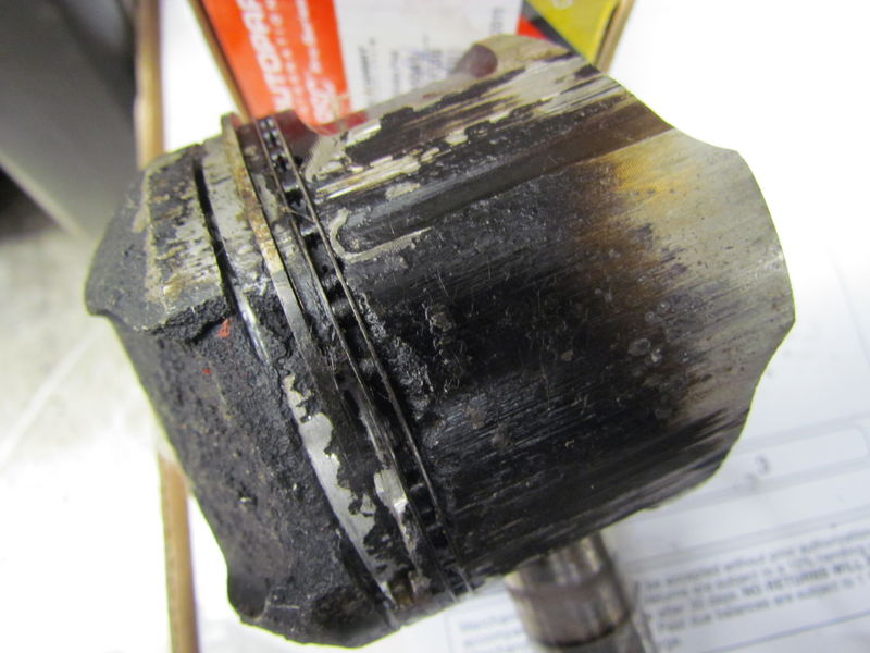

Click to view attachment (Pelican Pix)
They can look as bad as this before they leave the engine.
