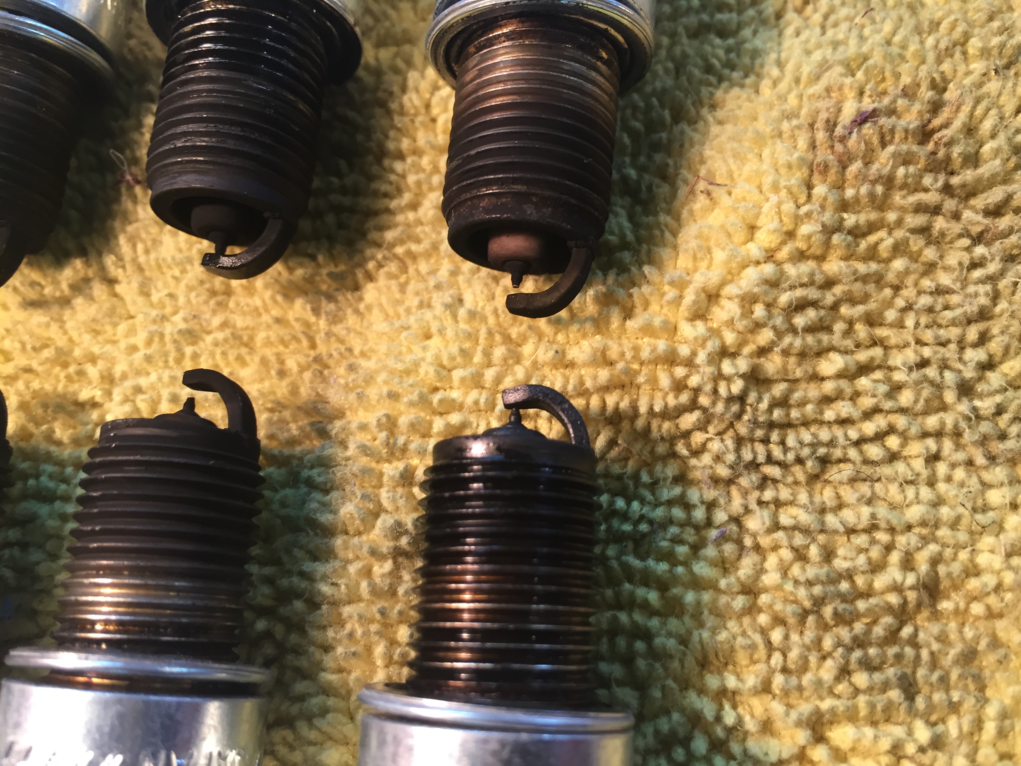

> spark plug gap closed on two plugs, what causes this?
siverson
post Jun 13 2016, 09:23 PM
Posts: 2,464
Joined: 5-May 03
From: San Diego, CA
Member No.: 654
hi - quick question from the garage. cdi box died on my six. got replacement and car starts right up (good). but runs like crapola right away. pulled the plugs and on two the electrode (term?) is no touching the plug.
is this why my cdi boxed died?
or is this a result of it dying?
or?
plugs were 1k miles old. cdi box was 46 years old.

The only thing I know that would cause this would be the wrong plug (thread body too long). Your pistons are making contact with the plugs. Bad deal.

Attached Image (Pelican Pix)
They can look as bad as this before they leave the engine.

"...pulled the plugs and on two,the cathodes are now touching the electrodes."(meaning,the gaps are closed)
The closed gap will indeed ruin the output transistors of the cdi amplifier.
Carbon buildup on the pistons are usually the culprits,running way rich and or lousy valve guides or poor ring sealing.
A short term fix is a shim for the plugs,to recess them up,away from the pistons.
For sure use copper formula antiseize on the plug threads.
https://www.google.ca/search?q=copper+anti+...RjOD2EQ_AUIBigB
A look inside to check the condition of the cylinders,with your recording borescope,will give a good reading of the overall condition.
https://www.google.ca/search?q=recording+cc...1JWDlQrLkBnM%3A
Roll the engine over to look at each valve in turn,(12),inspecting the seats and valve head.A comprehensive leakdown test is next.
A black,wet looking carbon deposit on pistons,chamber and valves means it's time for some headwork,at minimum.
A single plug six is sensitive,and must be maintained,otherwise..(Kaboom!).

Bill Jenkins found hp by indexing the plugs in his prostock 'sbc'engines,so too should the gap be pointed into the center of the cylinder of the 911 'hemi' engine.

I'm very unclear on how a mis shift or over revving could make a piston hit a spark plug....
I would suggest you may be using the wrong plugs...too much thread

After reviewing the photos again, I believe this is your problem. The fact that some are touching and others are not leads me to this result. The plugs are certainly carbon fouled. I also agree that shimming the plugs would be a temporary fix. Getting to the source of the over rich situation is the real issue. Fuel, valve adjustment, timing etc. Good Luck!

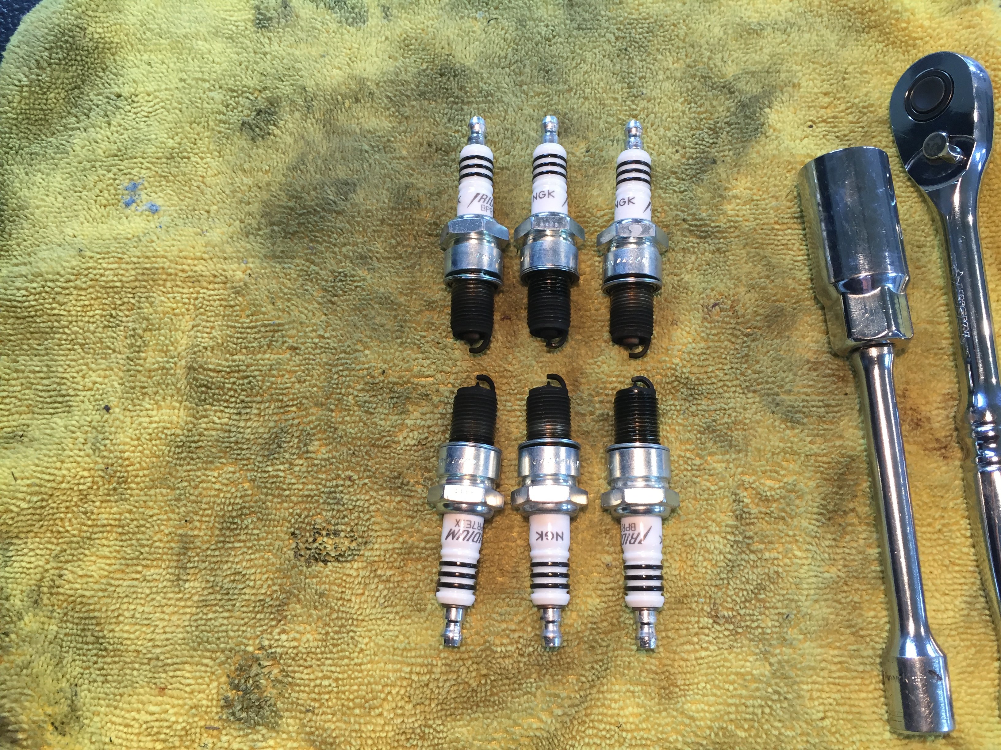

siverson

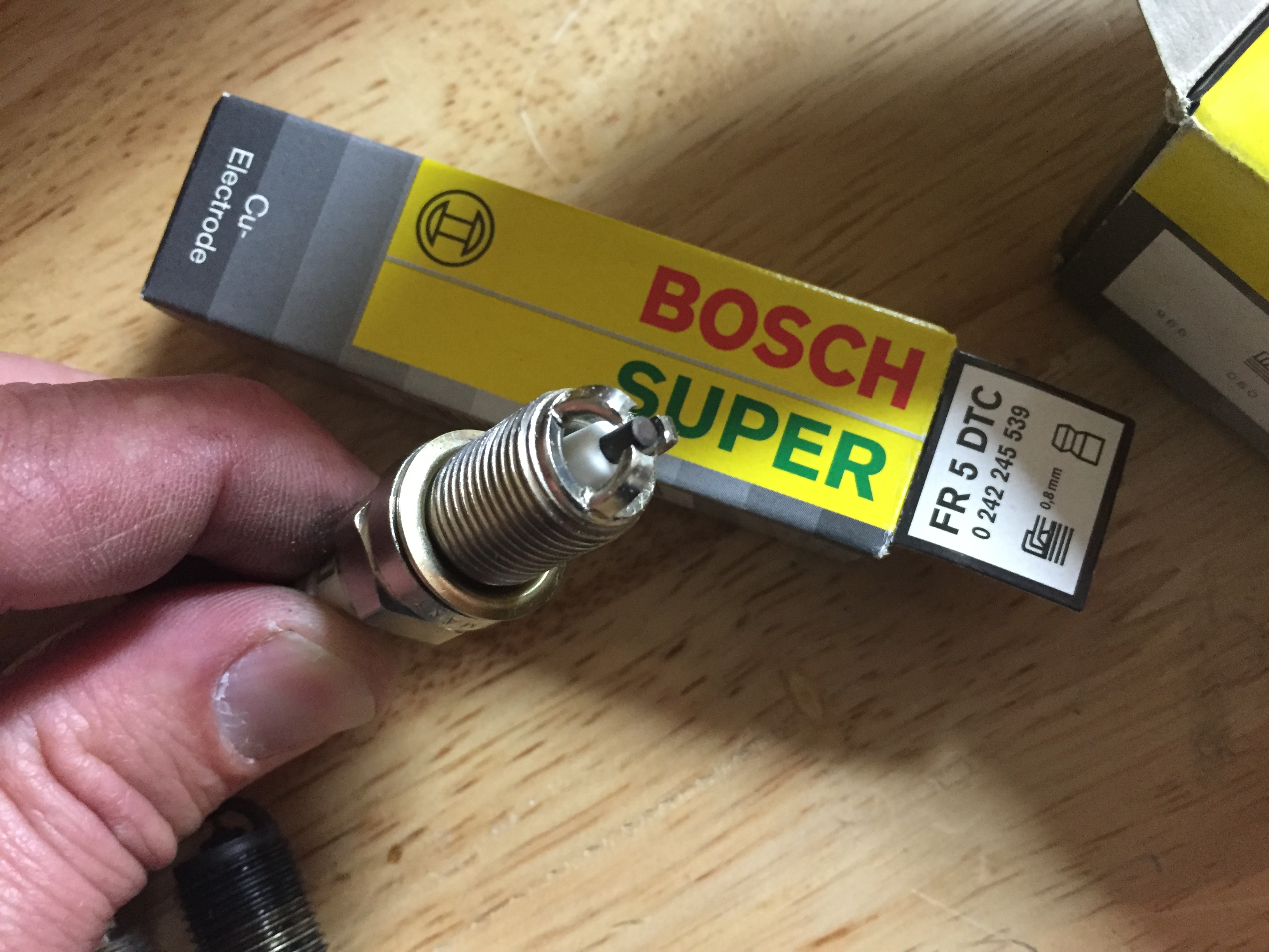

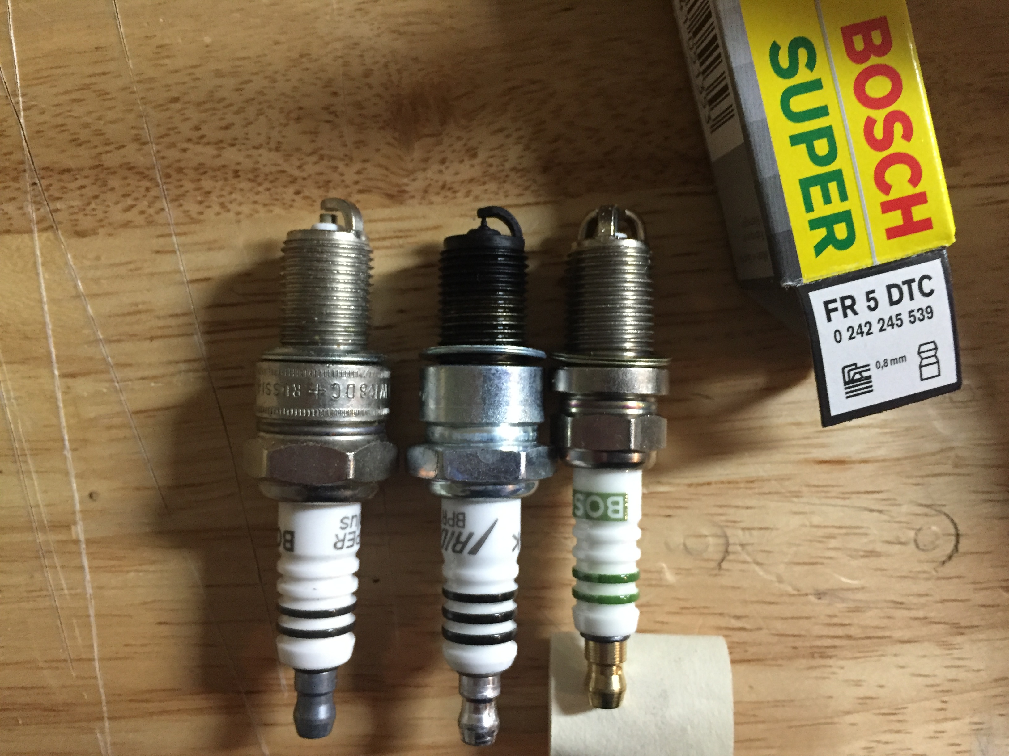

I don't think the plug length is the issue. The plugs were installed by the shop that built the engine and they use them all the time.
I also had several other new plugs in the garage are various brands for Porsche six cylinder engines, and they were all the same length.
So, just to test, I installed a new set of FR5DTC plugs. They aren't the best for this 2.0 engine (they are correct for the 964 3.6) but everything runs and sounds fine. Vrooom. I've ordered a set of WR5DC (what CDI box mfgr/PartsKlassik recommends) that I'll replace these with.
The tach seems more bouncy than normal with the CDI box, but I'll take a look at the points (or maybe replace with Pertronix).
I'll have to hook up my Air/Fuel ratio meter to see whats up. A boroscope would be nice, but I don't have one... Hmmm...
A piston hitting a spark plug on high rev doesn't really make sense to me either, but I also have WAY less experience with this stuff than brant.

post Jun 14 2016, 12:18 PM
Posts: 2,464
Joined: 5-May 03
From: San Diego, CA
Member No.: 654
New plugs.
-Steve

post Jun 14 2016, 12:19 PM
Posts: 2,464
Joined: 5-May 03
From: San Diego, CA
Member No.: 654
In there now.
