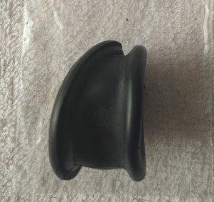

DO you mean this?
Yes I have obtained a sample and it is on the list maybe 6-8 weeks at this point.
