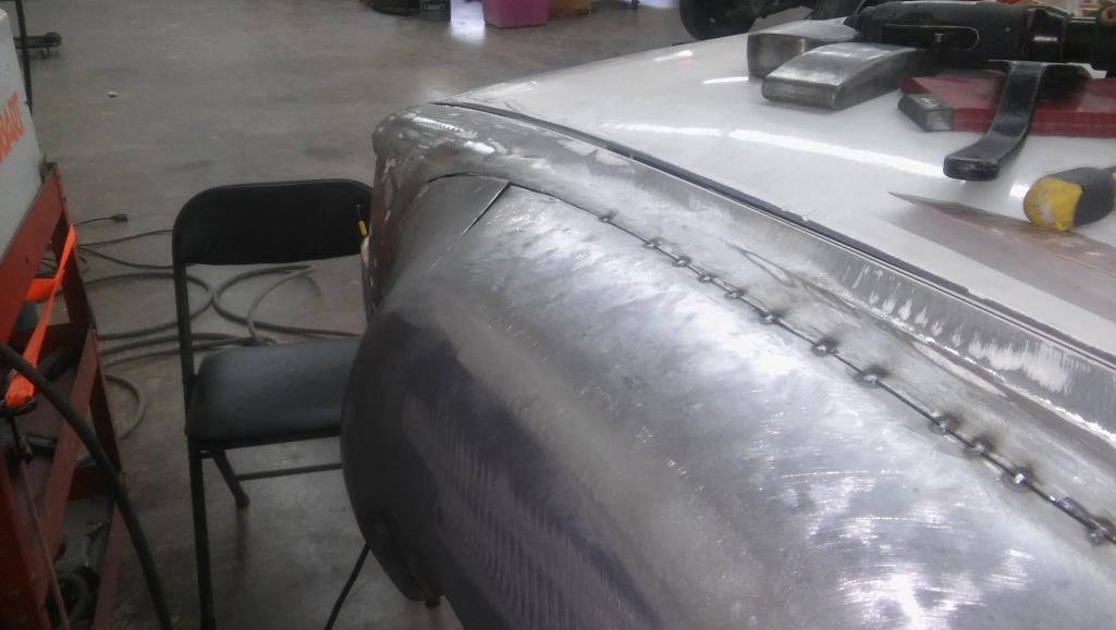

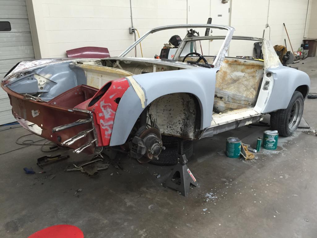

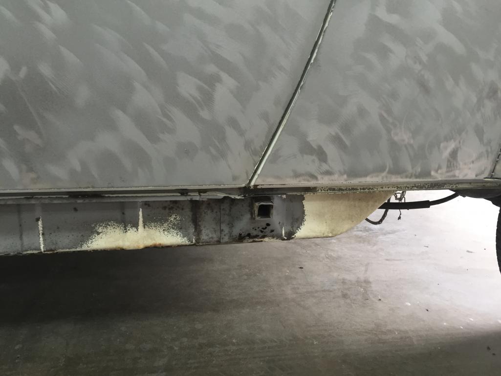

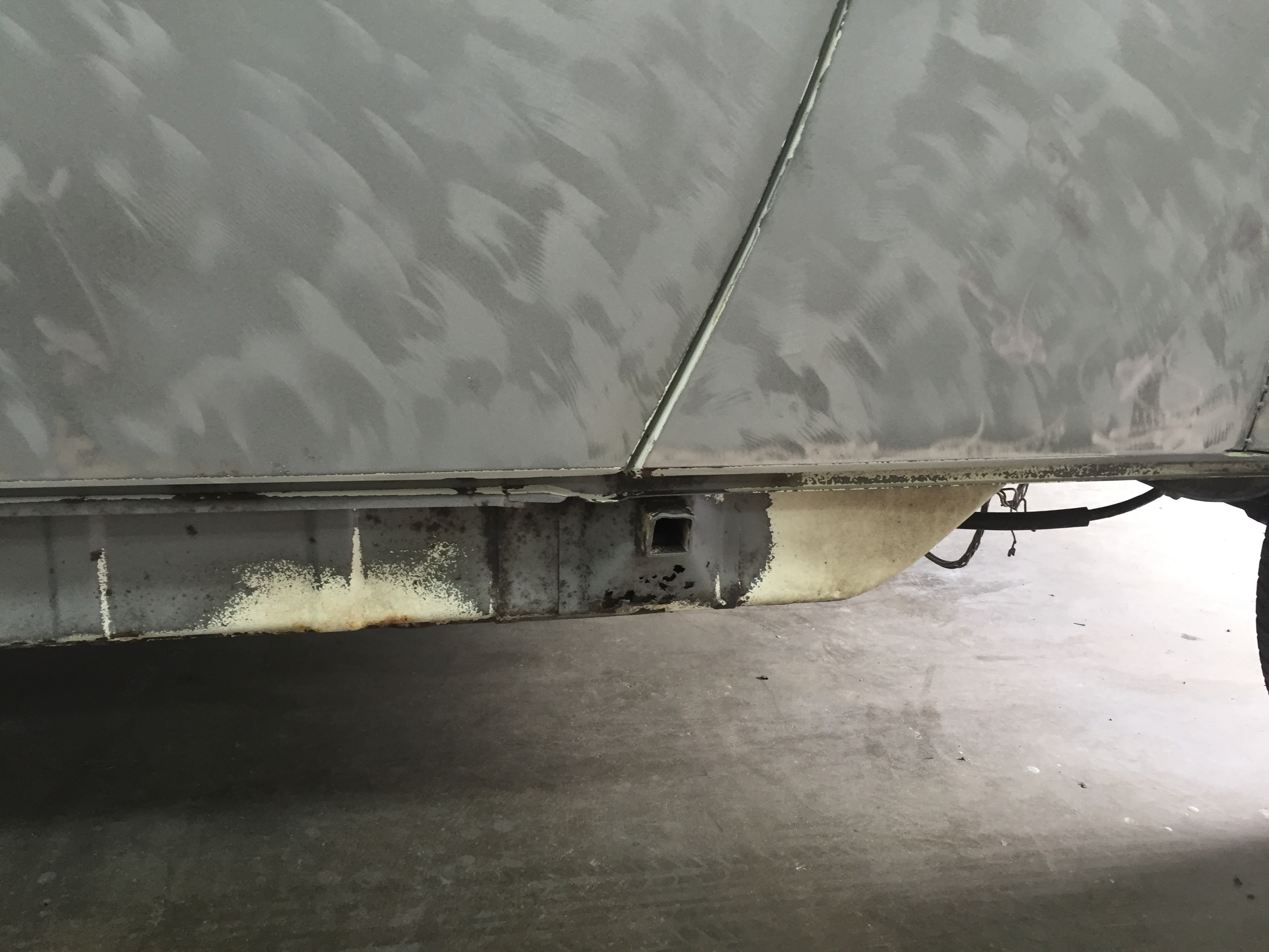

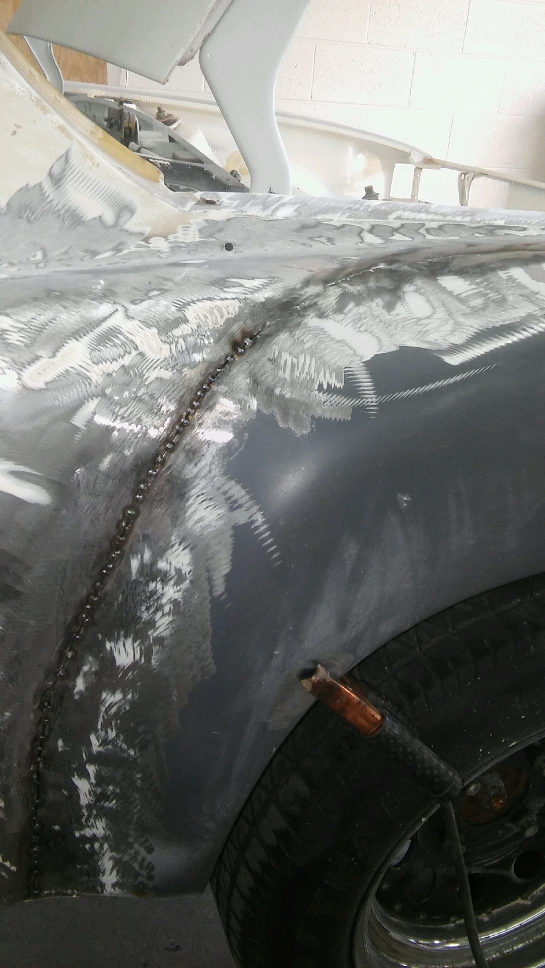

So, after many months, work finally begins in the GT. Heinz Peters is helping out with the body work and prep for paint. Found that the flares were lapped and welded, so the work begins there cutting and butt welding. One side was stripped to reveal the two fenders; only found a couple small spots of rust at the jack point.

Hopefully this is all of the rust there is- one can hope. Next week I'll be removing the dash, and starting to strip the flloor, so more to come.

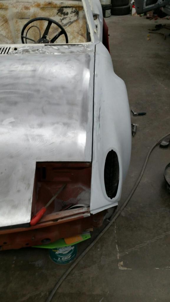

One fender is nearly complete. Still need to fill in a few pin holes in the seam, and needs a little shaping.

Heinz is starting to block the curves todayAttached Image

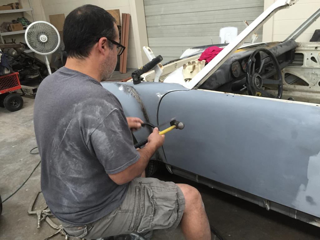

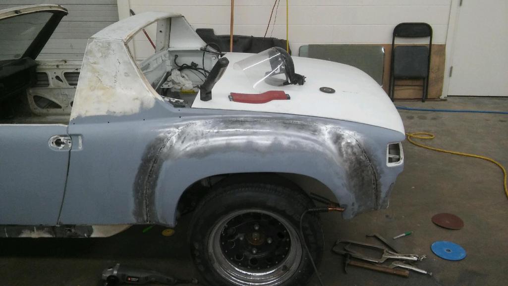

Disassembly continued today; removed the windshield, tank, some of the ventilation system and more trim work. While I did the easy work, Heinz started working the front flare correcting the weld and shaping the fender better.

Awesome...action shot!

Man, the front of that driver's side front fender looks a little rough. I know he hasn't started on that yet. Nice progress.
Yeah, that is the one area found so far that looks like it was hit at some time in the past. Thinking about cutting it out and grafting in a section from a donor; may be easier than fixing all of the wrinkles.

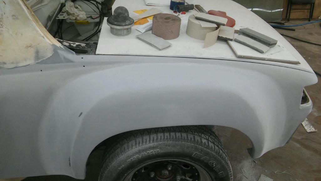

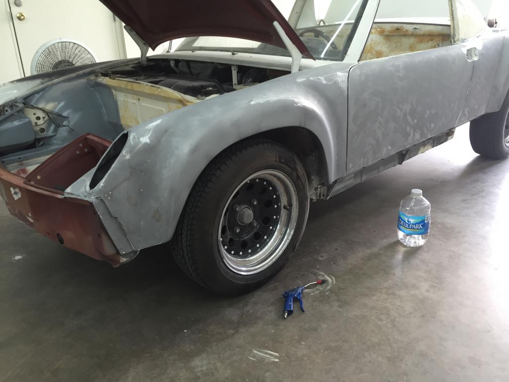

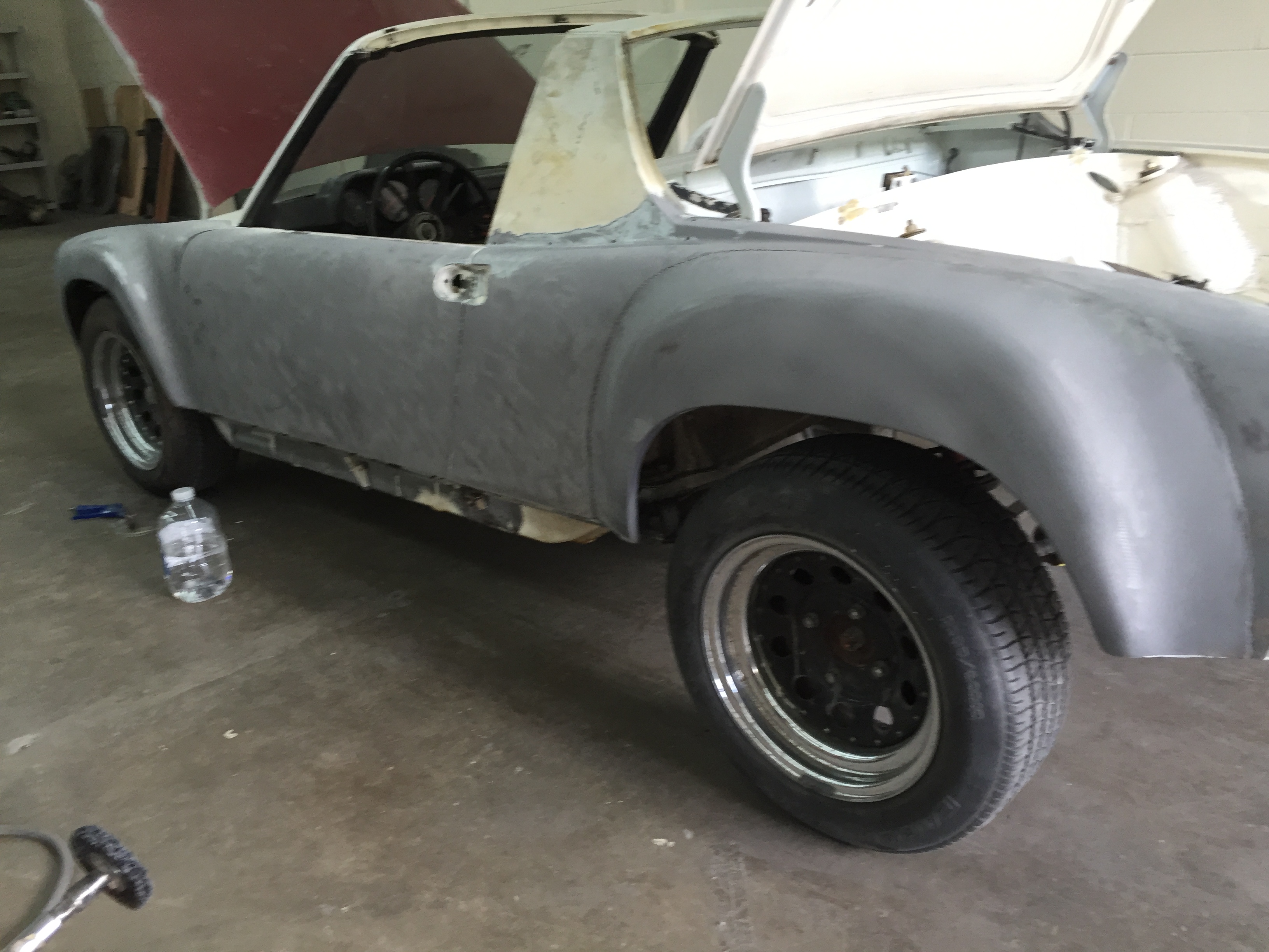

Third fender is now complete. I'm not sure where these flares came from, but they needed a tremendous amount of reshaping.

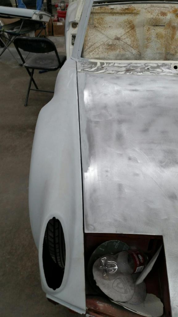

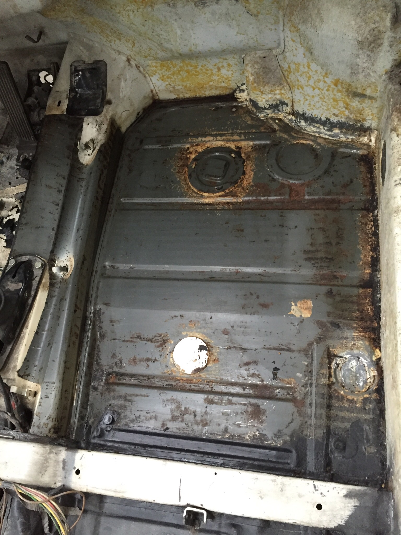

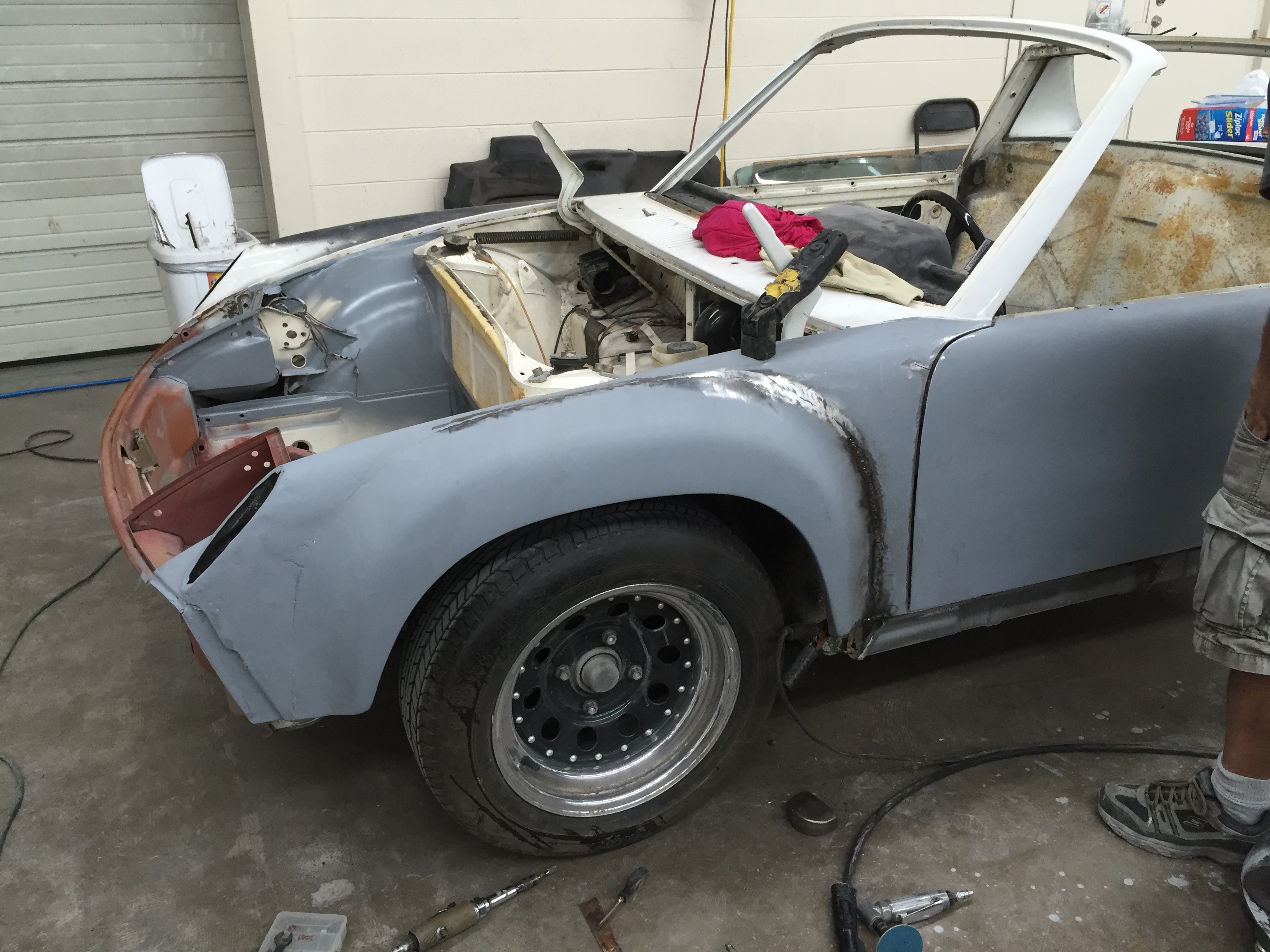

Time for an update. All four corners are complete, but the drivers side signal lite area needed to be replace (the original has been crushed sometime in the past). I stripped the floors inside - they're near perfect with no rust issues, so I'm happy with the progress there. Heinz has improved the front hood gaps significantly; can't wait to see it in person this weekend, but I have some pics to get me excited.

That looks beautiful. Your man definitely knows what he is doing. The gap between the hood and fenders looks outstanding.
