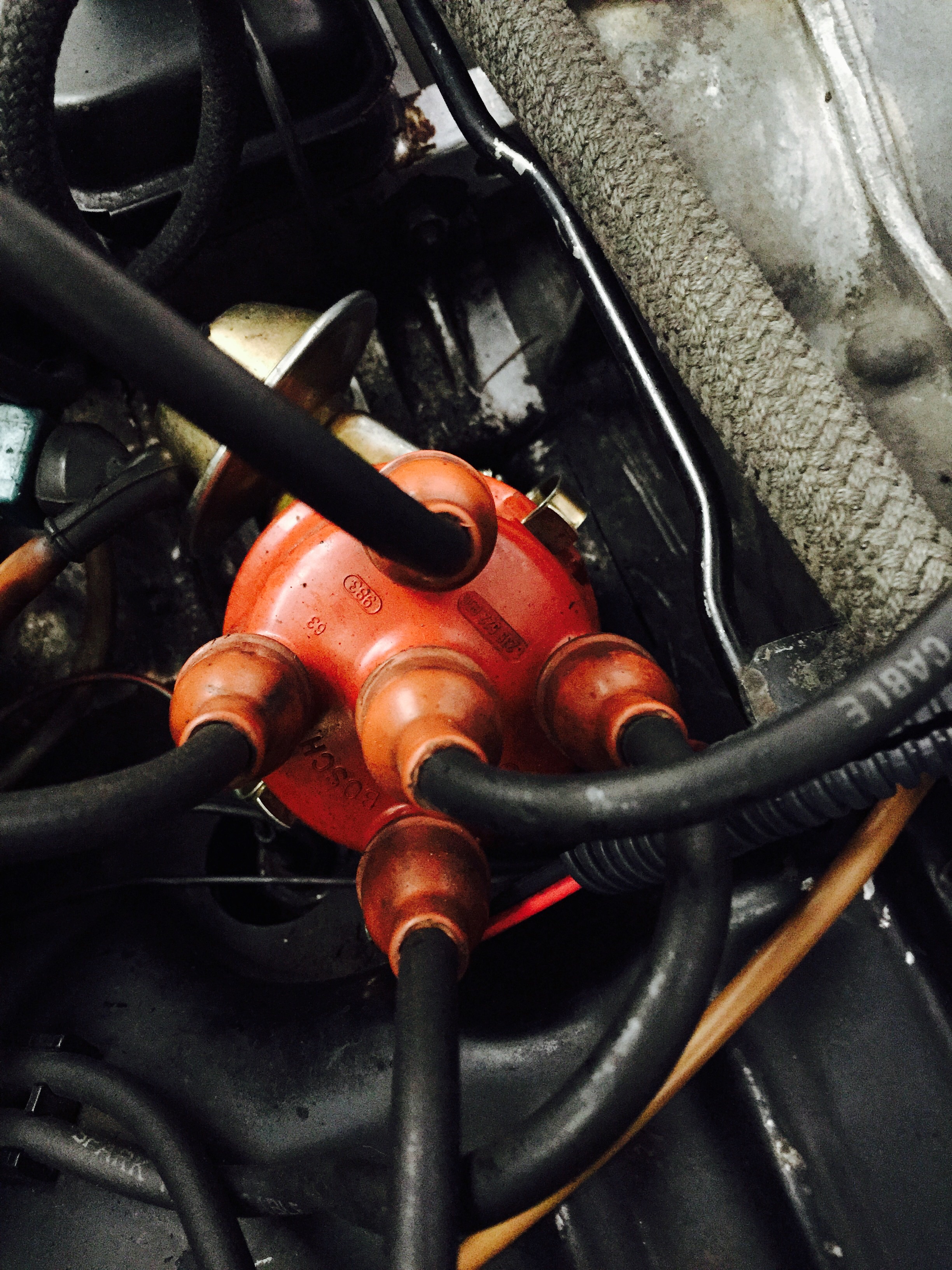

Close up of original distributor and coil. Is this an original factory cap? I have to figure out how to loosen the coil so I can turn it to expose the Bosch label ! Any help??

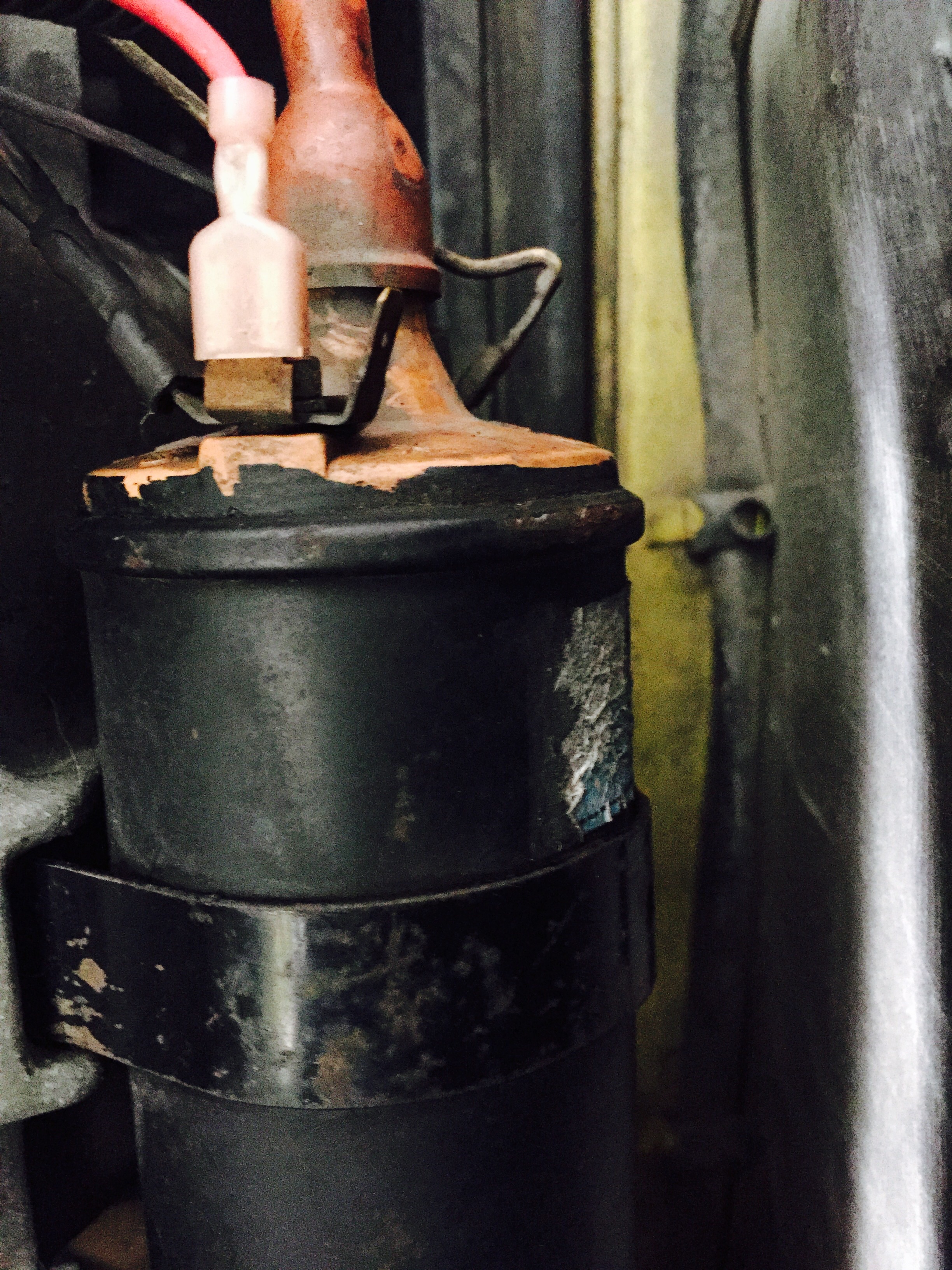

Here is the coil

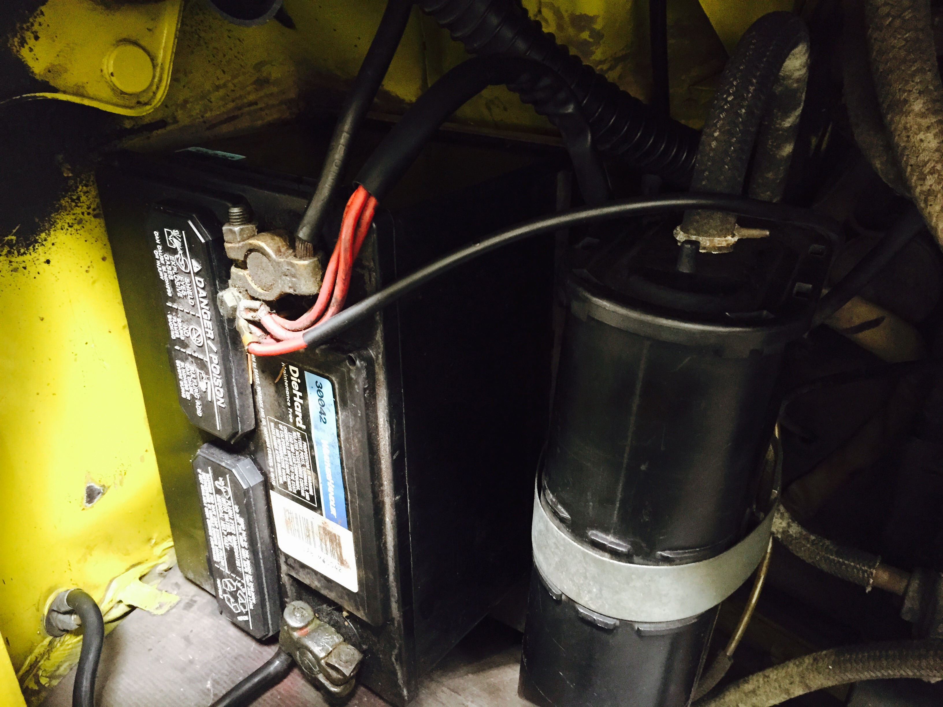

More engine photos

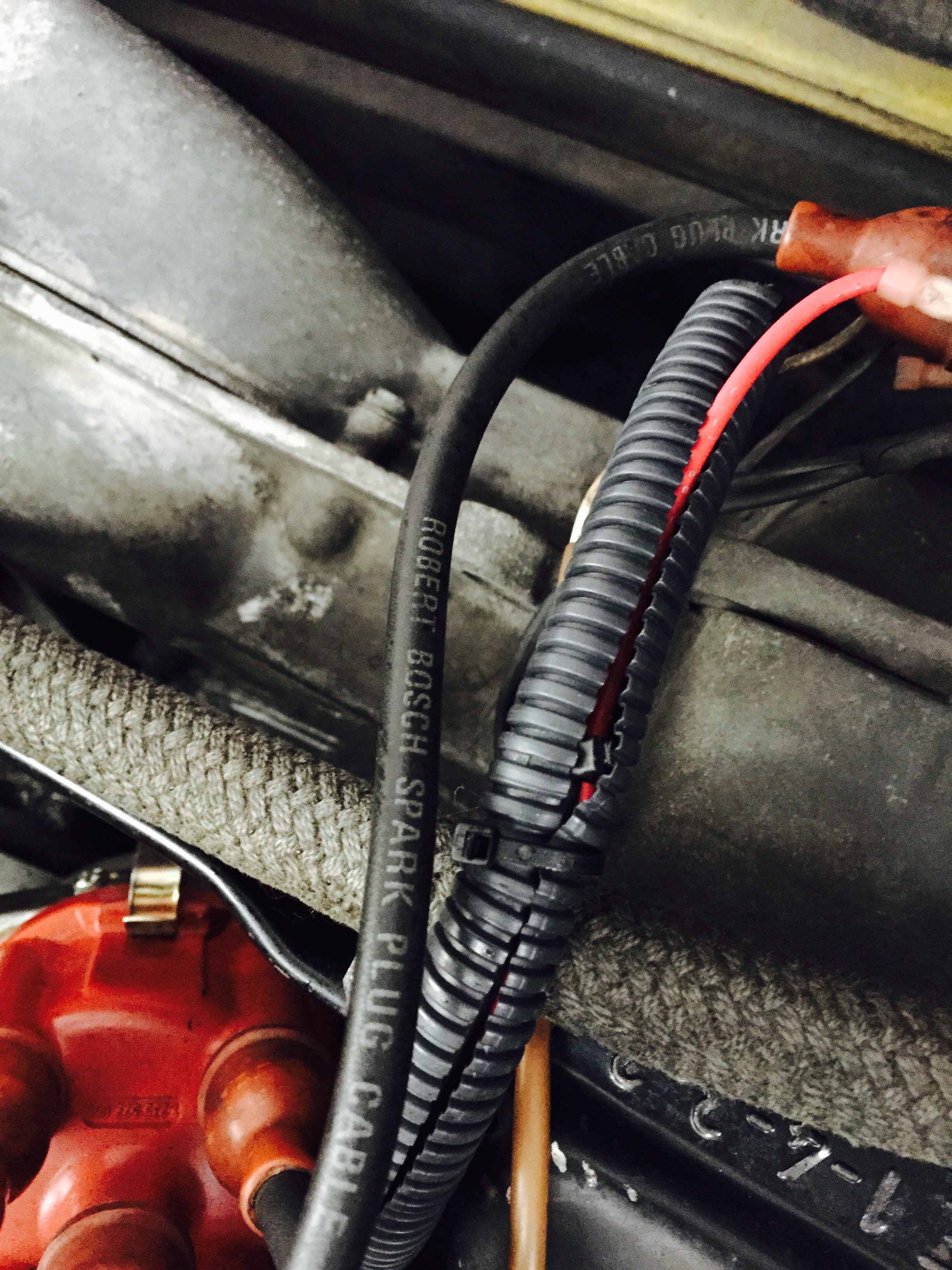

Are these the factory plug wires? Say Bosch on them and they appear to have been on there for many years do to them being memoried big time in there position and stiffness of the boots. Thoughts???

You might want to check out the "Engine Bays" thread in the upper section of this sub-forum. One of the things you might notice on Pat Garvey's engine bay is the different colored hoses. There should be green and red colored hoses, along with the charcoal gray that you normally see. FYI, the larger red hoses are very difficult to find. If you pursue this and find a source for the larger red replacement hoses, please let us know.
I'm sorry, but I don't know the answers to your other questions on originality.

Thankfully, its not as original as you might think. Someone has done some routine maintenance like changing the fuel/vacuum hoses, I am sure that has saved the car after 140K miles.
They didn't do any favors by putting the fuel filter in the engine bay, or the serrated hose clamps and a few other things, but those are all easily corrected.

Thanks for the info. Knew about the fuel filter. That will be fixed. Just curious, How do you know the vacuum lines were replaced? Thanks again

For example, your fuel hoses, at least at the cold start injector are replaced. Only an inexperienced mechanic would use that serrated hose clamp on a pressurized fuel hose. The photos do not depict it, but it looks like you have an electronic ignition? Not original.

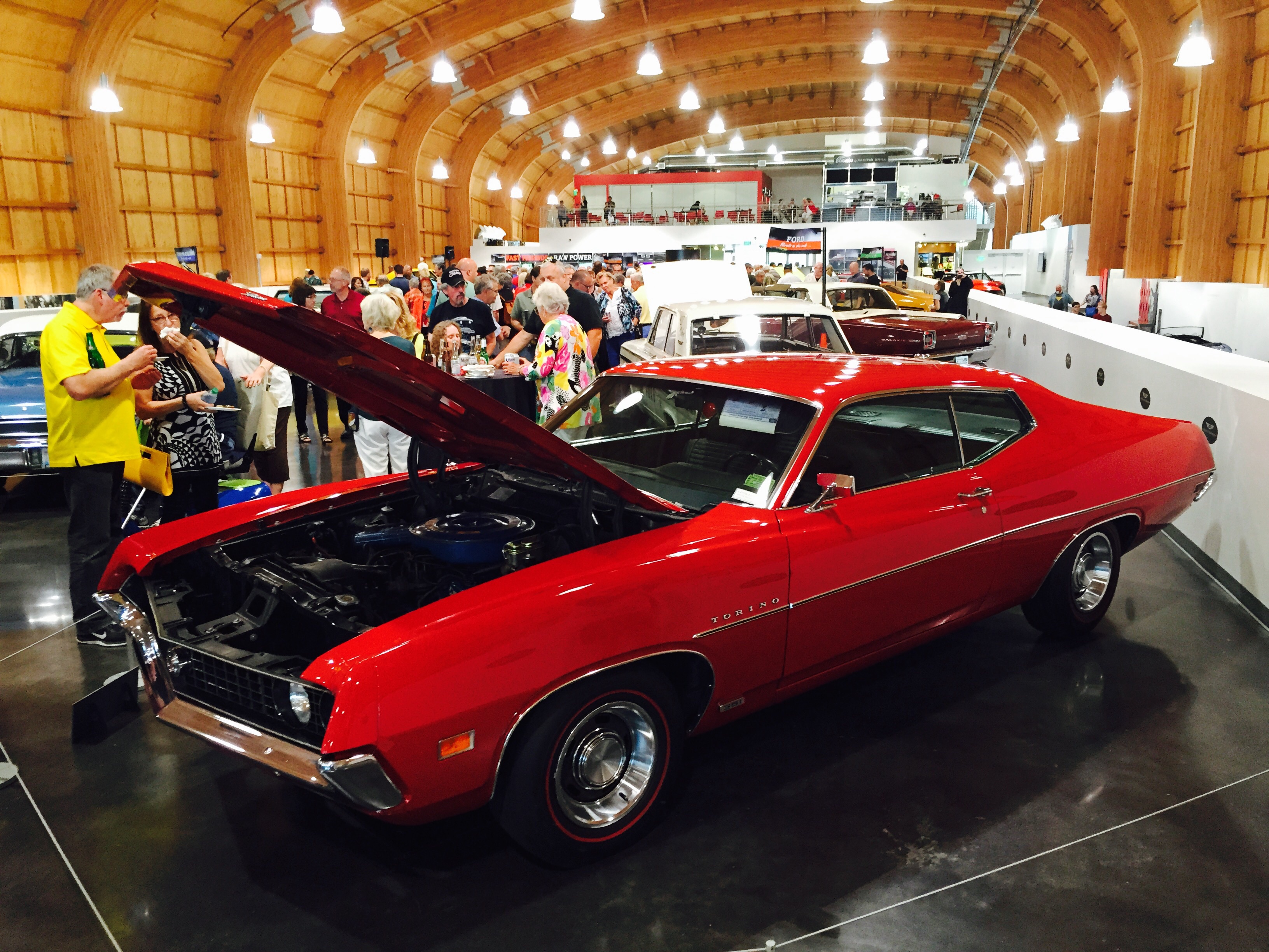

Ok. Here are a couple of shots of the car. One is the car in the LeMay Automotive Museum ( largest car collection in the USA housed here. They had a show. " American Muscle". My 1970 Torino was a feature car. Has a very rare factory NASCAR version of the 351 C-4V. Only 400 of these engines were built. The car is 99.99% untouched factory original. The others photo is the car winning first in class at the Pacific Northwest Concours d' Elegance last year. It has been invited to Amelia Island Concoyrs next year. A Pebble Beach judge who was at the show and was one of the judges said he has never seen an unrestored original car in that condition that was driven ( has 93,000 miles on it. Only not original to the car when made is the battery, oil filter, running tires and spark plugs. Everything else has never been touched
