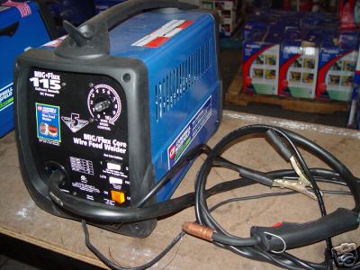

Everybody says buy the best welder you can afford and I think it's quite true.
Unfortunately there is alot of us who can't afford (for small work) a nice Miller, Hobart or Lincoln.
I am still very temted by this unit I saw at Wal-Mart the other day, it's MIG, you need a bottle but it has a regulator and hose but no gauges. It's $275 with a 5 year warranty made by Campbell Hausfeld, it's not a No-Name company but it ain't either one of the big ones in the welding equipment industry.
Maybe it will fit your budget, it would be fun for others to chime in with their opinion as I don't know for now if it's wortht the money or not, but it is another option.
