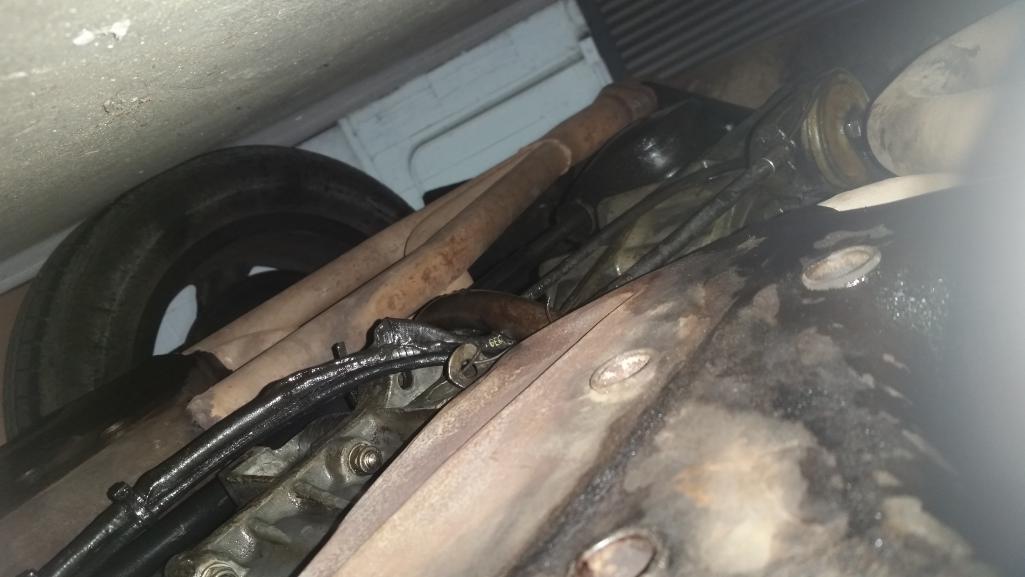

Yeah. We tightened it up yesterday and there's more slack in it now. It is dropping at the connector up front and going under the clutch cable.

I went back at lunch and looked a bit more.. Its getting caught on something or maybe the cable is frayed and catching the plastic tubing around it.
The pedal feels very tight, like I have to use a whole lot more force than what should be necessary.

The cable slid easy enough when we had it disconnected, not that it couldn't be failing apart now. Could be binding at the throttle body or pivot.

how did the cable get anywhere near the exhaust? it comes out of the firewall and goes directly up through the shelf to be routed. if the cable is suspect, get a new one. you can tow it here but i doubt AAA would cover it.

^^ -6 not 4

QUOTE(brant @ Sep 12 2016, 08:04 PM) *
Justin. How do the pedals feel when the cable is disconnected?
(There are ways for pedal shafts to fail too)
Rule out the clutch tube too
Did you guys put the new throttle cable on the way?
I'll have to check that tomorrow.
I can hear it pulling tight right at the point where it comes in the car but can't exactly see it.
We didn't.. I've learned my lesson on this one, take the help lol.. I have a bit of a problem with that.

Looks like those cables are the clutch and speedo cable and not the accelerator cable. Like what mentioned above, accelerator cable is by the firewall and goes up and it should not be closer to the heat exchanger or headers.
