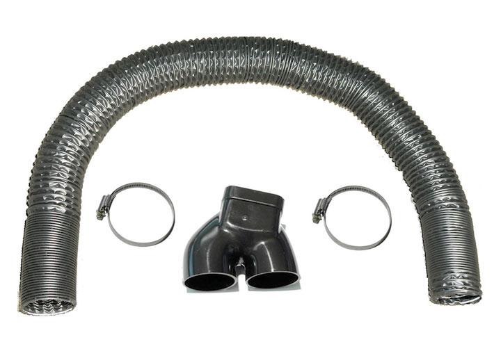

It's a plastic 'Y' that goes on the fan outlet. The cross over tubing to the pass side j tube is longer.

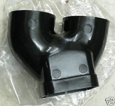

Ah, I Google'ed it and found a few pics. It looks like Auto Atlanta has them, but I'll try here in the classifieds. I'll bet someone here has one lying around. Pics I found are below.

The VW part number is 461261831 A .Google this number and you found pictures and parts. (IMG:style_emoticons/default/smile.gif)

The splitter was used on the 75-76 cars.

I bought the AA kit and thought the splitter did not fit very well--it left a huge gap where it attached to the blower.
