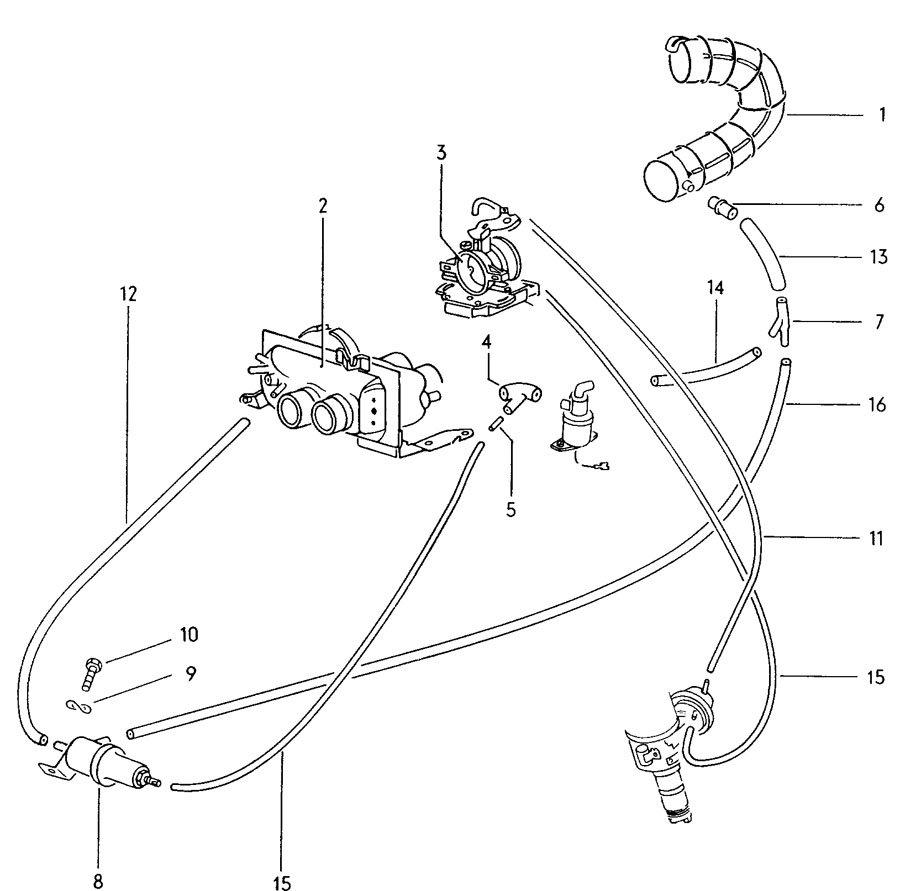

I don't see a 73 1.7 on Bowlsby's tech notebook. Here is the same drawing as your link. You should print it and start following the hoses. It is tuff to tell by your picture, but does the hose go to the vacuum can on the disty?

yes that is homemade...you need this 022.133.083 vacuum elbow

parts diagram...it's #4

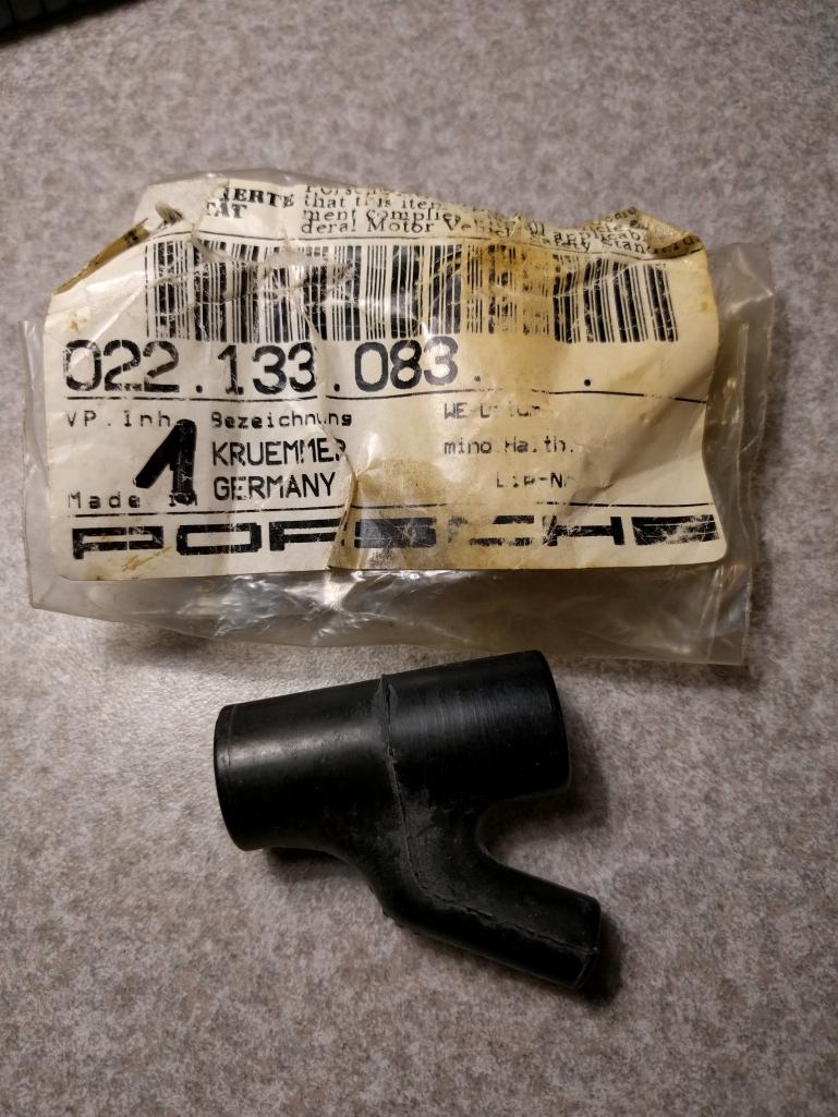

I found this part here
http://www.volkswagen-classic-parts.de/cat...lt/?q=022133083
There is no picture ,but the part number is correct.

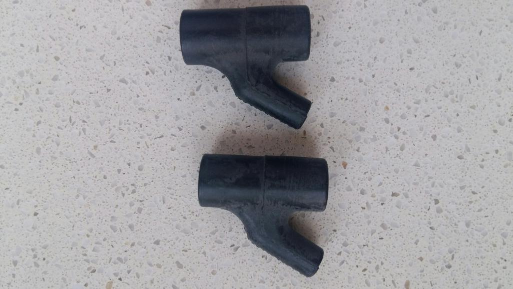

Note that 022133083D is NOT what you want. Wrong size. I see several people are advertising they have the 022133083, but I don't believe they have stock. I tried to order one from Bus Depot last year, and it sat on back order for 6 months before I cancelled the order. I may tweak them again to see if they found a source.

I can confirm that 022133083D is incorrect -- I have two of them down in the garage, with no idea what to actually do with them since they won't work.
I've been asking Mark at 914Rubber to make some for a while, but it's fallen kinda low on his priority list.

mh I think this is the correct part .This shop is from the Volkswagen AG .Look at Bildtafel 1 Part number 14
http://www.volkswagen-classic-parts.de/kruemmer.html

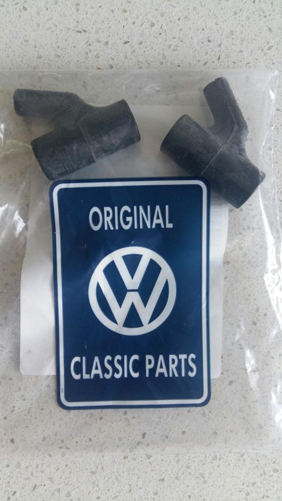

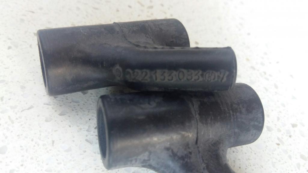

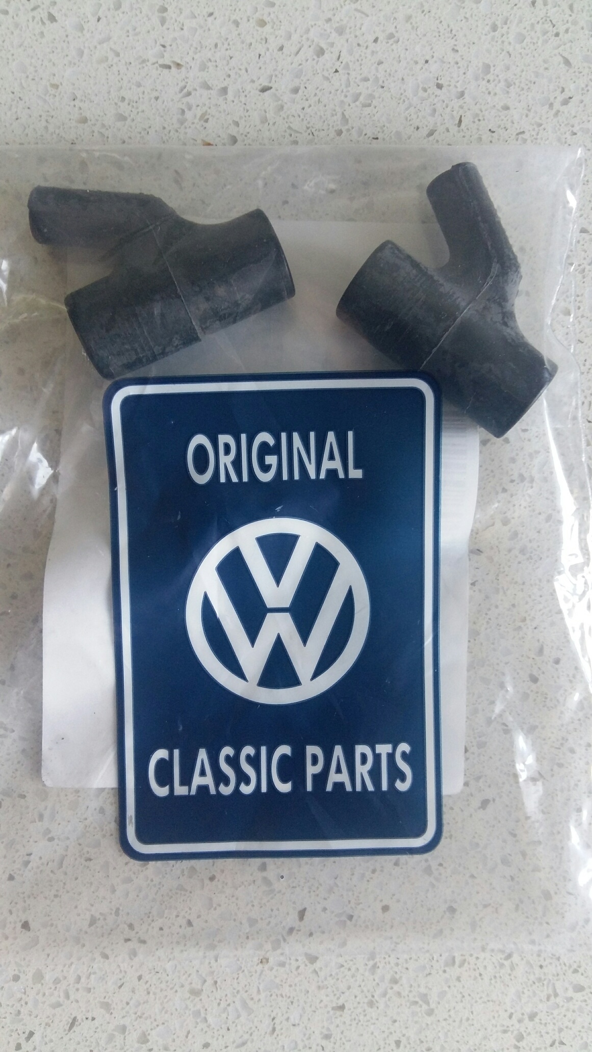

Ok, some parts arrived including the elbow that we spoke about in this topic.
unpack
It looks like the correct one !
So...I will replace the homemade part by the original elbow again.
Thanks JohnHora for the details and offering the part from USA, and thanks 914fahrer for the tip to a vendor/part closer to me and my car, thanks stinkindiesel/BillC for the remark on what not to order.
