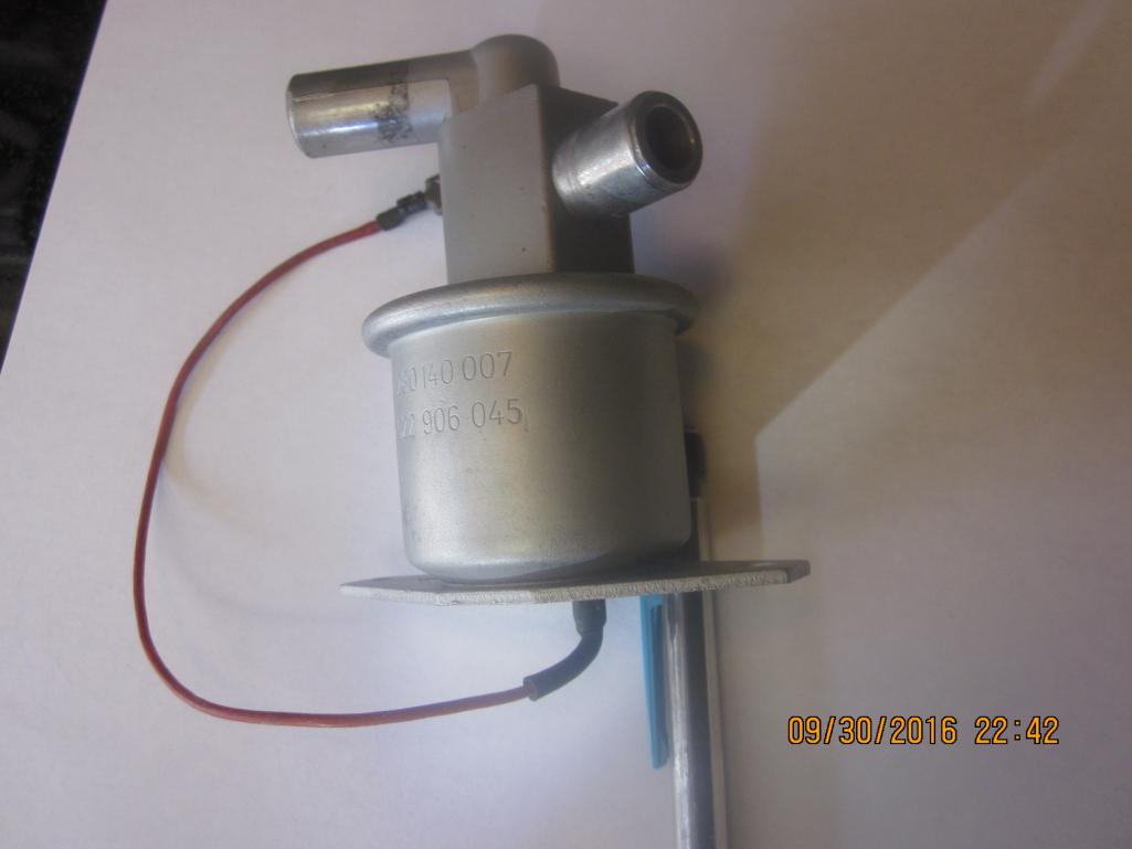

The missing connection should go to the AAR. Auxiliary Air Regular

The RED wire is what you should be looking for.

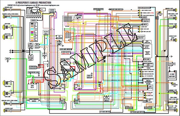

It is tuff for the forum to help with wiring. You are going to get 100 different ideas. If one end of that wire has a connector on it, look for the female (or male) part somewhere very damn close to it. If it is brown there might be a hidden case bolt with 4 or 5 spades on it that are all grounds, they should all have a wire on them, if one is missing.... TA DA. short of that......
I sing this guys praises every chance I get. The one I bought is not EXACTLY perfect, but it is a HUGE help.
PROSPERO'S GARAGE LINK
for $20 even an electrical illiterate like me can get things done. Look for your car in the list and buy one today.

The CHT does have that type of connector on it. So does the sender for the oil temp. But the one in the area you mention just about has to be the one for the AAR, as SMG posted.

I agree with Dave and smg. Only connector insulator like that in that area. If it grounds it blows the fuse on the relay board and the pump won't run. The aar wire just simply unplugged will not keep the car from running unless it shorts.
