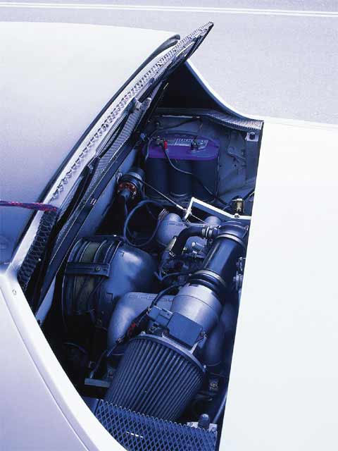

now that my 3.2 conversion is up and running I have a few bugs to work out, and i'm hoping to gain some knowledge from others that have been there done that.
My car is a 74 that previously had a 2.7 and now has a 3.2 with a KEP stage two clutch PP set up, stock DME 3.2 , and Rich Johnson mount.
My questions are:
1. How is your airfilter routed with pics please. My AFM is in it's semi orig location and my current cone filter is just barely hitting the lid. I have a smaller diameter cone on order, but wanted to see what others have done.
2. I was told, that my Pilot bearing on the tranny seems to be turning all the time. My engagement is closer to the floor than i'm used to but even with a small spacer on the clutch cable end, i'm still at the end of thread for the adjusting nuts. Is a bigger spacer the answer or am i missing something specific to the kennedy set up that I should do.
hopefully this made sense, I have pics on my home computer i can post later.
TIA
Ferg.

Here's a picture of the 3.2 from GPR.
They sell the whole kit.
Steve

Here's a picture of my motor with a Ford MAF.
All brackets, adapters and fittings are from home depot.
I'm also running the KEP stage 2 kit.
The instructions said to take out the washer which I did.
I can't tell if it helped or made it worse.
I still had to adjust the clutch pedal for maximum throw to the floor.
My throw out bearing also seems like its always touching the pressure plate.
GPR and PMS said they have never had this problem.
The instructions also say the throw out bearing should not touch the pressure plate.
They also recommended a spring on the throw out arm to make sure it doesn't rub.
I have to push the clutch all the way to the floor otherwise reverse will grind.
It was worse until I replaced the terry cable weltmeister special with a factory six clutch cable.
Ferg

Thanks Steve, those pics are very helpful, i'll post my pics when i get my home computer hooked up, (we just moved). Couple of questions...
What size home depot pipe is that 3 or 4 inch, I went there and was having problems constructing the same type of intake tube, seems like the plubing pipe is measured by inner diameter, and connection to AFM and cone filter would not work.
Which washer are you refering to be left out of the kennedy kit, i want to call the guy who did my install and find out if that was done
Which ford model MAF, I plan on keeping my stock one but it would be nice to know for the future.
Again thanks for the pics and advice, once i'm unpacked and settled in our new place i'll have a saturday to get the issues resolved. Right now i'm driving around with no engine lid, feels like a nova or somthing (IMG:http://www.914world.com/bbs2/html/emoticons/rolleyes.gif)
Ferg

Forgot I already posted some pics on another thread, so here's my current set up, that does NOT clear the GT lid by less than 1/4 inch...

I can see by your picture that you need the drain pipe to extend the air flow meter.
If you extend the air flow meter with a pipe it will allow you to mount the air flow meter lower so the air cleaner won't hit.
The pipe from home depot only comes in something like 4' lengths.
I had to cut it down.
The pipe says 3" PE CO EX solid drain pipe on it.
I also brought the air flow meter with me to home depot to match everything up.
The pipe is 3" on the inside.
Bring your air flow meter to home depot.
Find the 3" pipe and then find a matching adapter there to go between the pipe and the air flow meter.
You can also do it the more expensive way and call up GPR and buy there adapter and pipe.
When I get a chance today I will scan the instructions from KEP.
