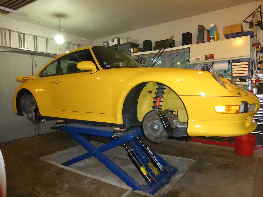

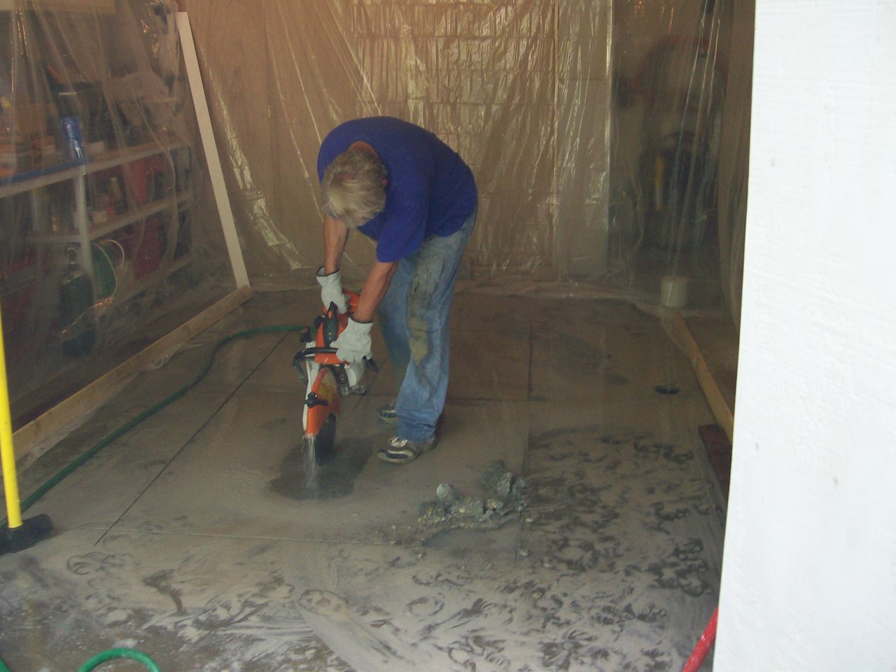

JustinP71, just cut a hole in the cement.......Easy afternoon job, nothing to trip over. Mine has a cover I can drive over or raise as an additional 4 x 8 work area. Best, MarkAttached Image

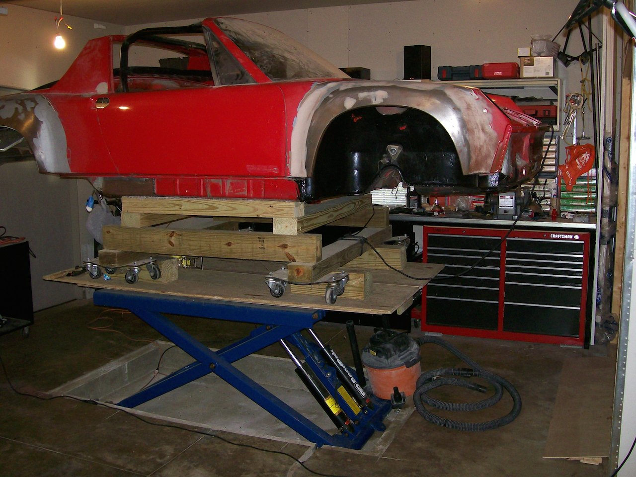

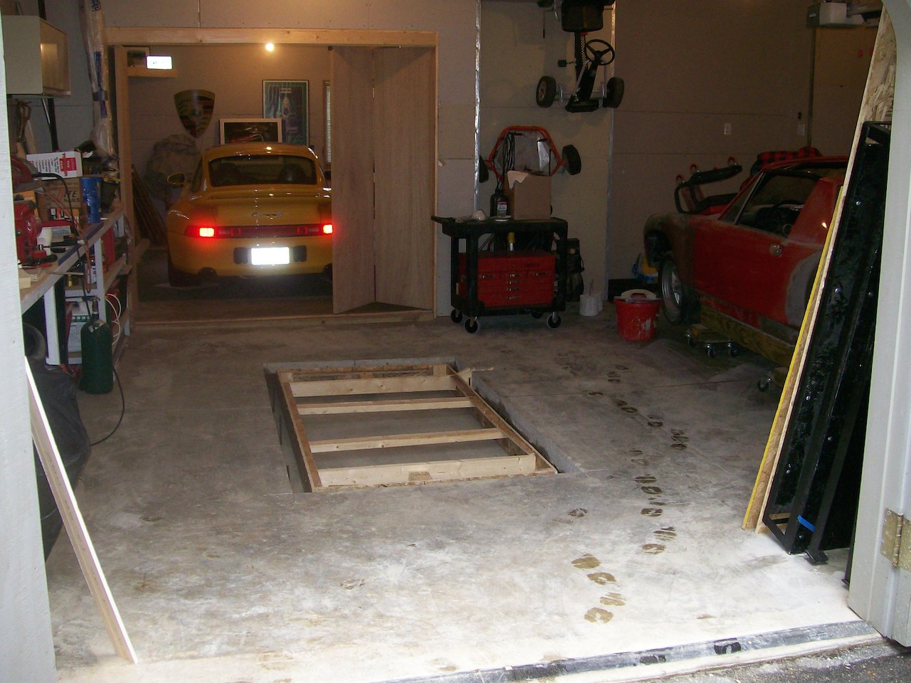

Just another shot, 914 on wood dolly on top of wood lift cover. Was great at getting to all the tough spots before repaint. MarkAttached Image

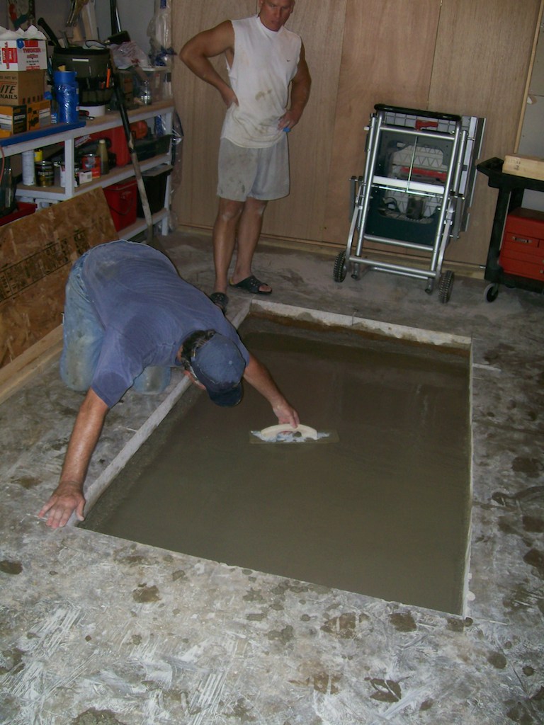

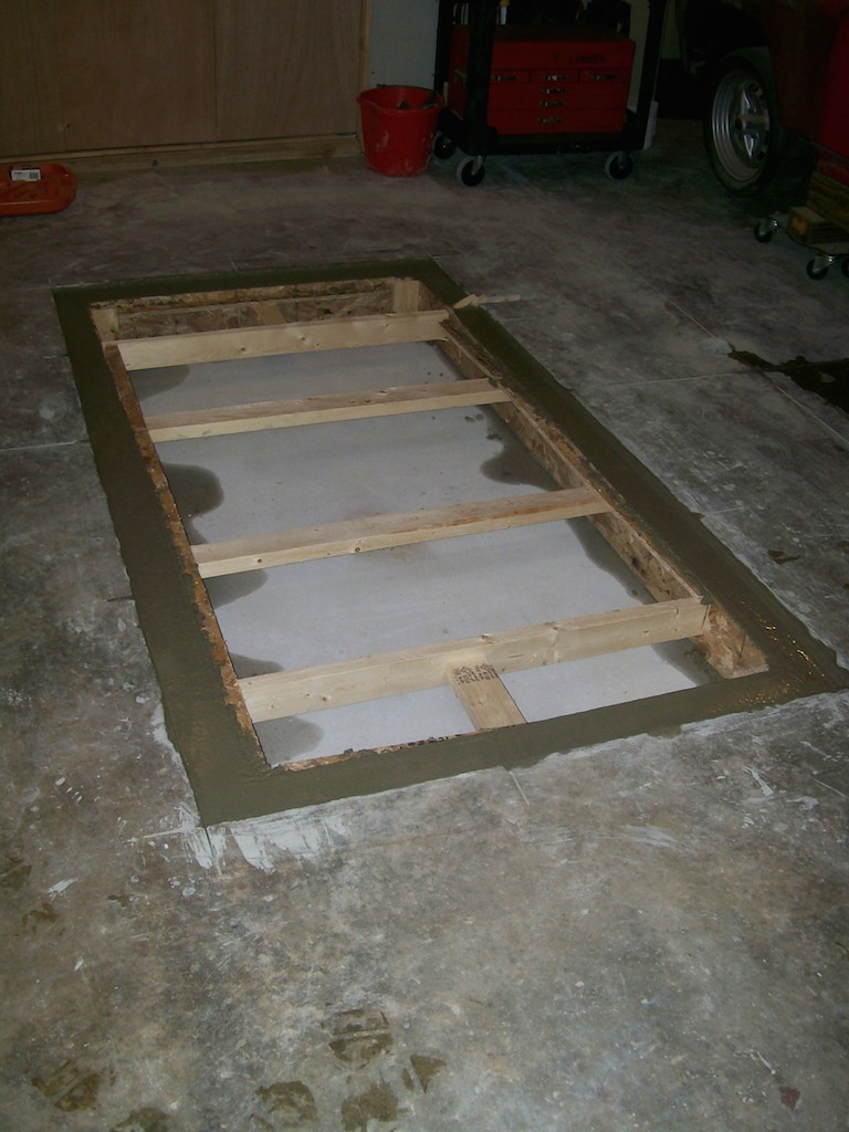

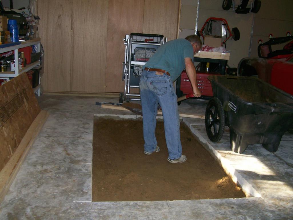

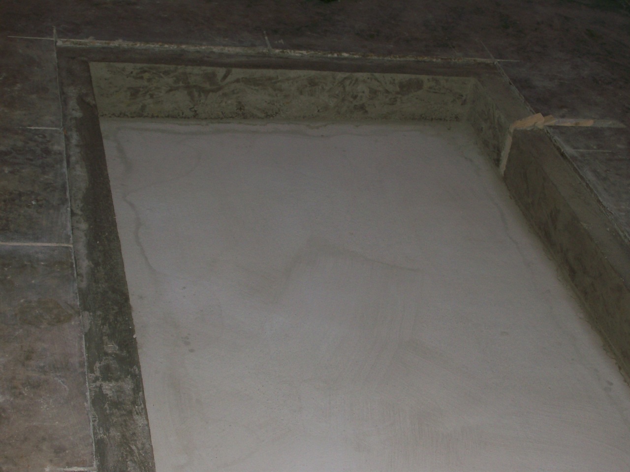

Harpo, I did have a friend to help....but the process went like this. Rent cement saw( the one I got was new with new blade) it cut the 6 bag mix almost as fast as cutting wood, could not believe. Then dug the sand out, down about 16 inches. The cement pour is a two step process, first pour base making sure it is level (my floor has a pitch to the floor drain). Then next morning framed up sides with a little rebar into the base. Second pour. Done.
I just used bag cement, and a little cement mixer that fit in the trunk of my wives Passat. If interested I can find pictures. NOTE, cutting cement is very dirty/dusty. I visqueened all sides of the garage off and had the hose/water going while cutting the cement. OK it took two days. still best thing I've ever done. Mark

Found a few pics, let see if I can post them all.Attached Image Attached Image Attached Image Attached Image Attached Image Attached Image

Sorry about the hijack Justin and thanks Mark for the photos. How thick is your new slab? It looks like you also cut a slot for your hydraulic line.
David
mlindner
post Oct 29 2016, 12:54 PM
Posts: 1,749
Joined: 11-November 11
From: Merrimac, WI
Member No.: 13,770
The old cement floor was only 3 1/2 inches thick with fiberglass imbedded, the new slab was 6 inches with a little rebar. Yes, sorry Justin, off the tracks we went.......mark PS with the scissor lift being lower in the floor, I can use the truck extensions for the lift making it possible to replace exhaust systems on newer VW Bettles and Jettas......for the Porsche's no problems.

Did you tie the old cement to the new cement using rebar and holes in your new cement?
Thanks again
DAvid
mlindner
post Oct 29 2016, 04:33 PM
Posts: 1,749
From: Merrimac, WI
Member No.: 13,770
Hi David, no, no need for that. The base for the lift (slab) is so stable, maybe five times needed. The six inch poor on compacted sand is enough to lift a commercial truck. I can give you a little schematic of the cement layout if you want. Best, Mark
