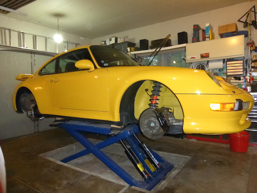

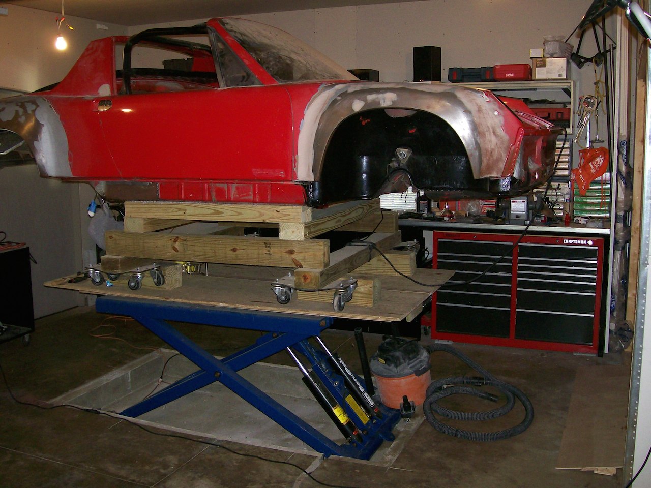

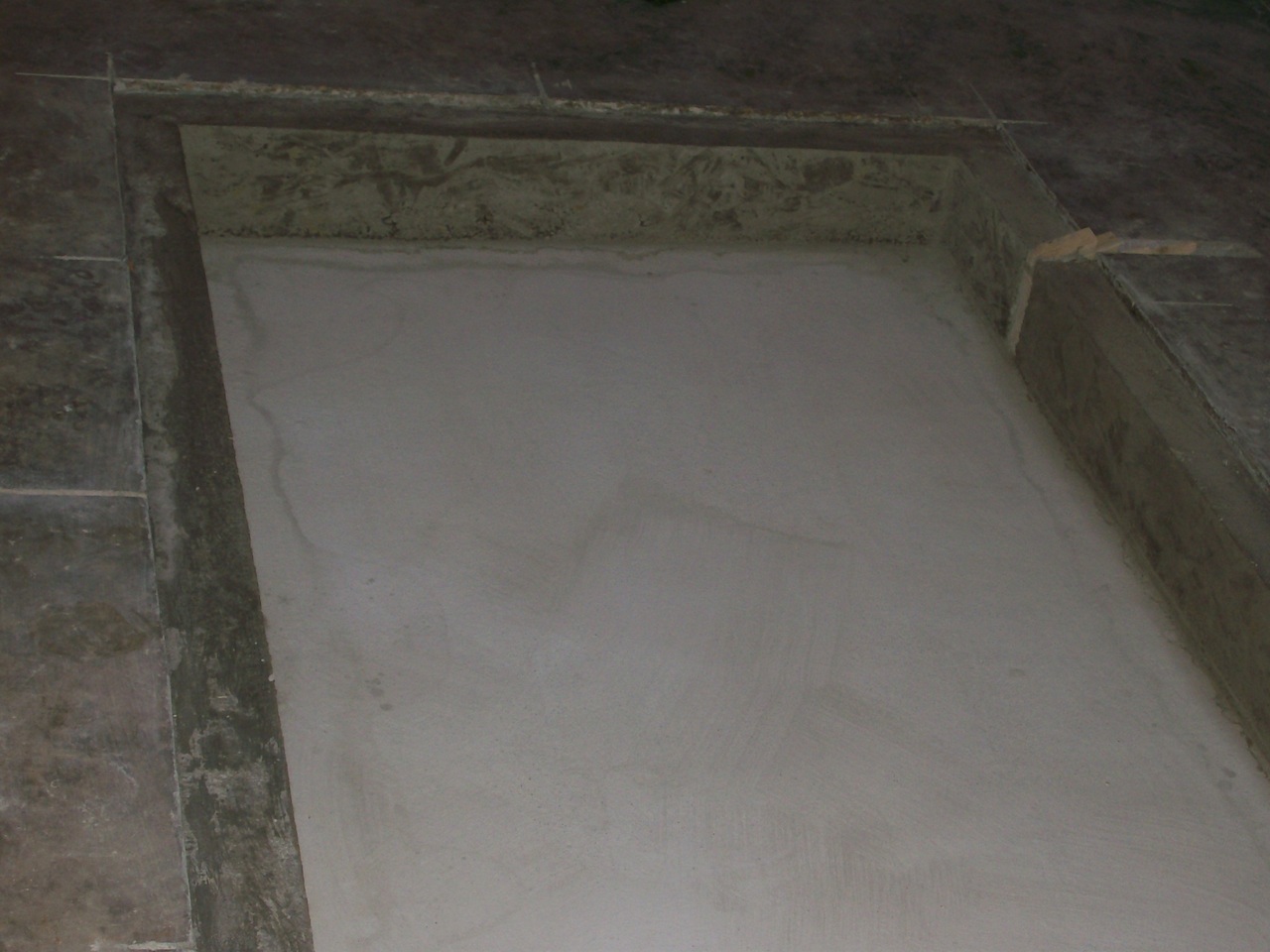

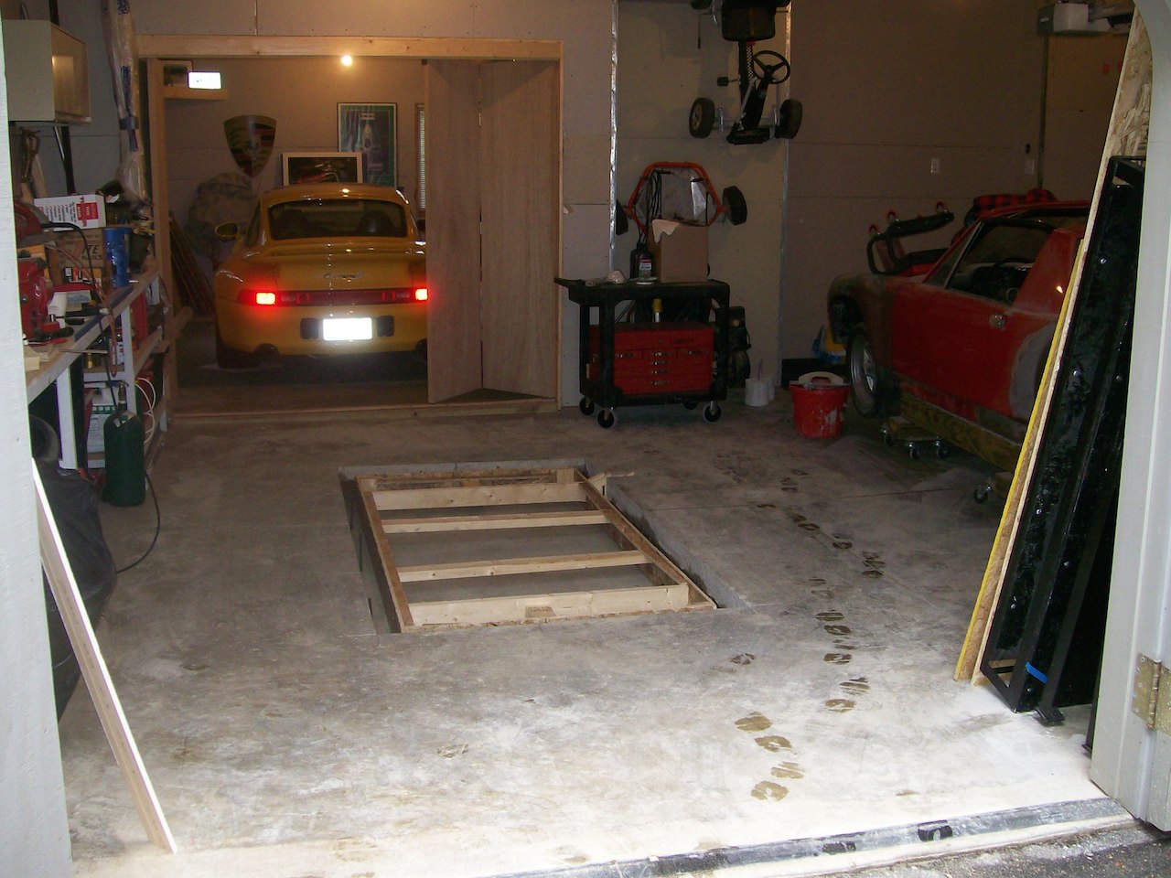

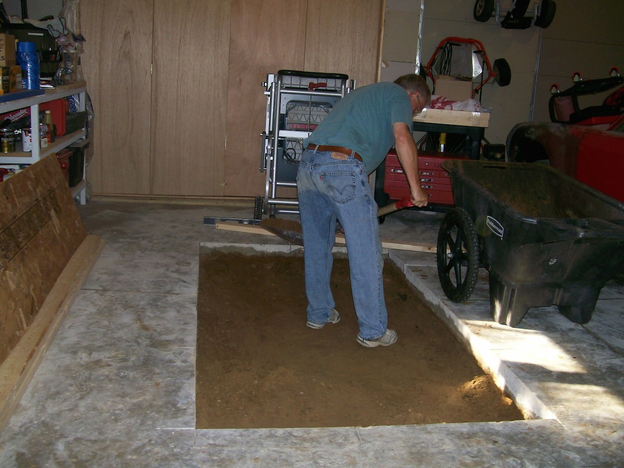

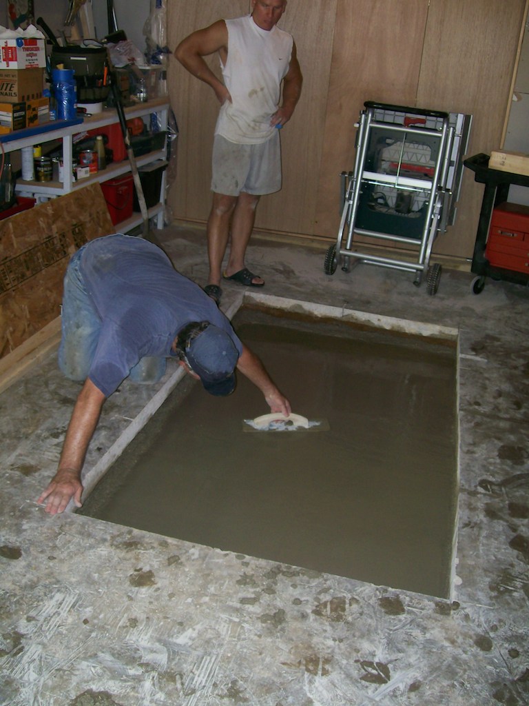

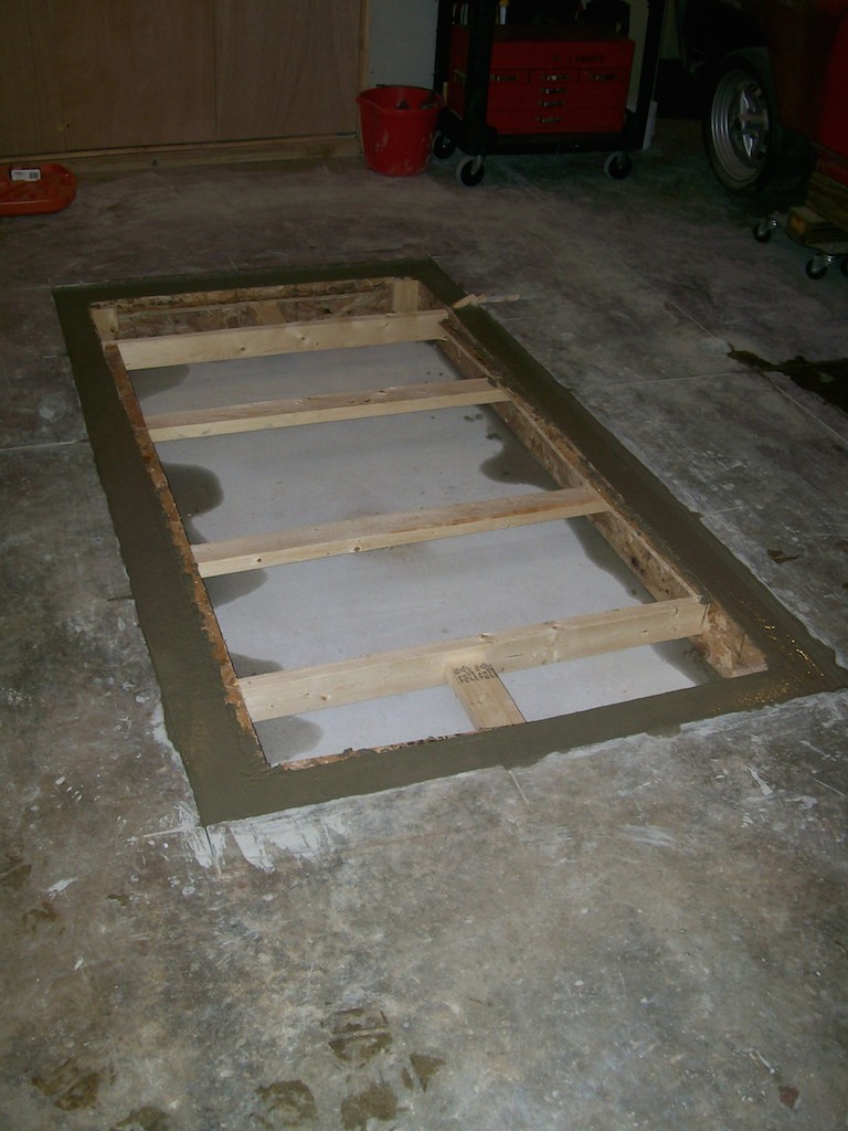

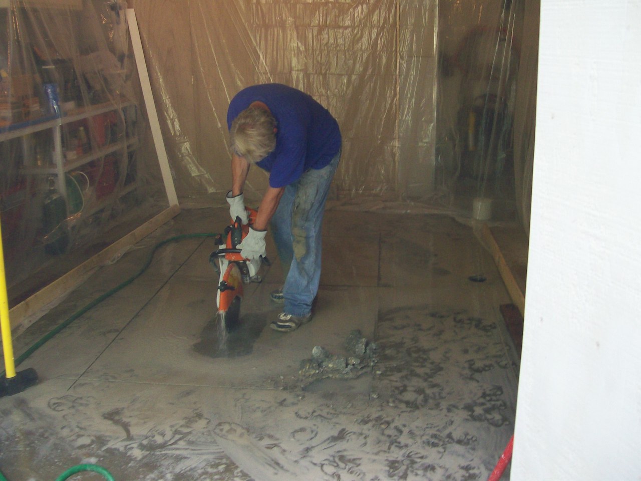

JustinP71, just cut a hole in the cement.......Easy afternoon job, nothing to trip over. Mine has a cover I can drive over or raise as an additional 4 x 8 work area. Best, Mark
mlindner
Oct 29 2016, 05:55 AM
Just another shot, 914 on wood dolly on top of wood lift cover. Was great at getting to all the tough spots before repaint. Mark

Click to view attachmentGood morning mlindner (Mark) please elaborate on your weekend project to cut a hole in your garage floor.

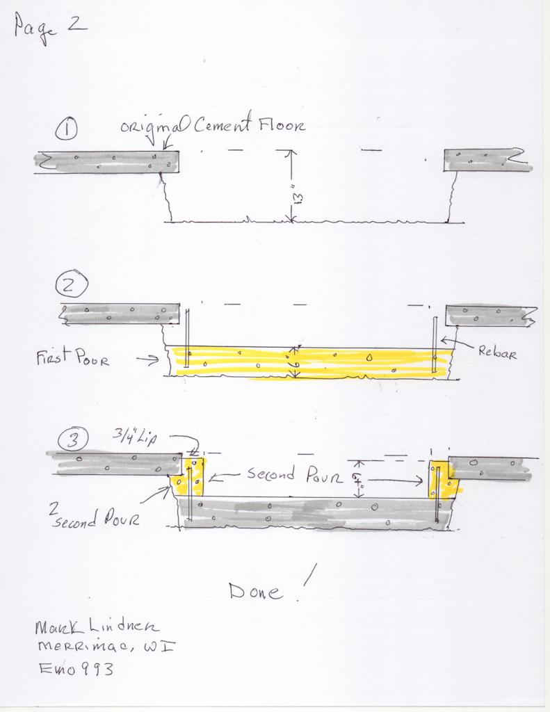

Harpo, I did have a friend to help....but the process went like this. Rent cement saw( the one I got was new with new blade) it cut the 6 bag mix almost as fast as cutting wood, could not believe. Then dug the sand out, down about 16 inches. The cement pour is a two step process, first pour base making sure it is level (my floor has a pitch to the floor drain). Then next morning framed up sides with a little rebar into the base. Second pour. Done.
I just used bag cement, and a little cement mixer that fit in the trunk of my wives Passat. If interested I can find pictures. NOTE, cutting cement is very dirty/dusty. I visqueened all sides of the garage off and had the hose/water going while cutting the cement. OK it took two days. still best thing I've ever done. Mark

Sorry about the hijack Justin and thanks Mark for the photos. How thick is your new slab? It looks like you also cut a slot for your hydraulic line.
David
mlindner
Oct 29 2016, 12:54 PM
The old cement floor was only 3 1/2 inches thick with fiberglass imbedded, the new slab was 6 inches with a little rebar. Yes, sorry Justin, off the tracks we went.......mark PS with the scissor lift being lower in the floor, I can use the truck extensions for the lift making it possible to replace exhaust systems on newer VW Bettles and Jettas......for the Porsche's no problems.
Harpo
Oct 29 2016, 03:47 PM
Did you tie the old cement to the new cement using rebar and holes in your new cement?
Thanks again
DAvid
mlindner
Oct 29 2016, 04:33 PM
Hi David, no, no need for that. The base for the lift (slab) is so stable, maybe five times needed. The six inch poor on compacted sand is enough to lift a commercial truck. I can give you a little schematic of the cement layout if you want. Best, Mark

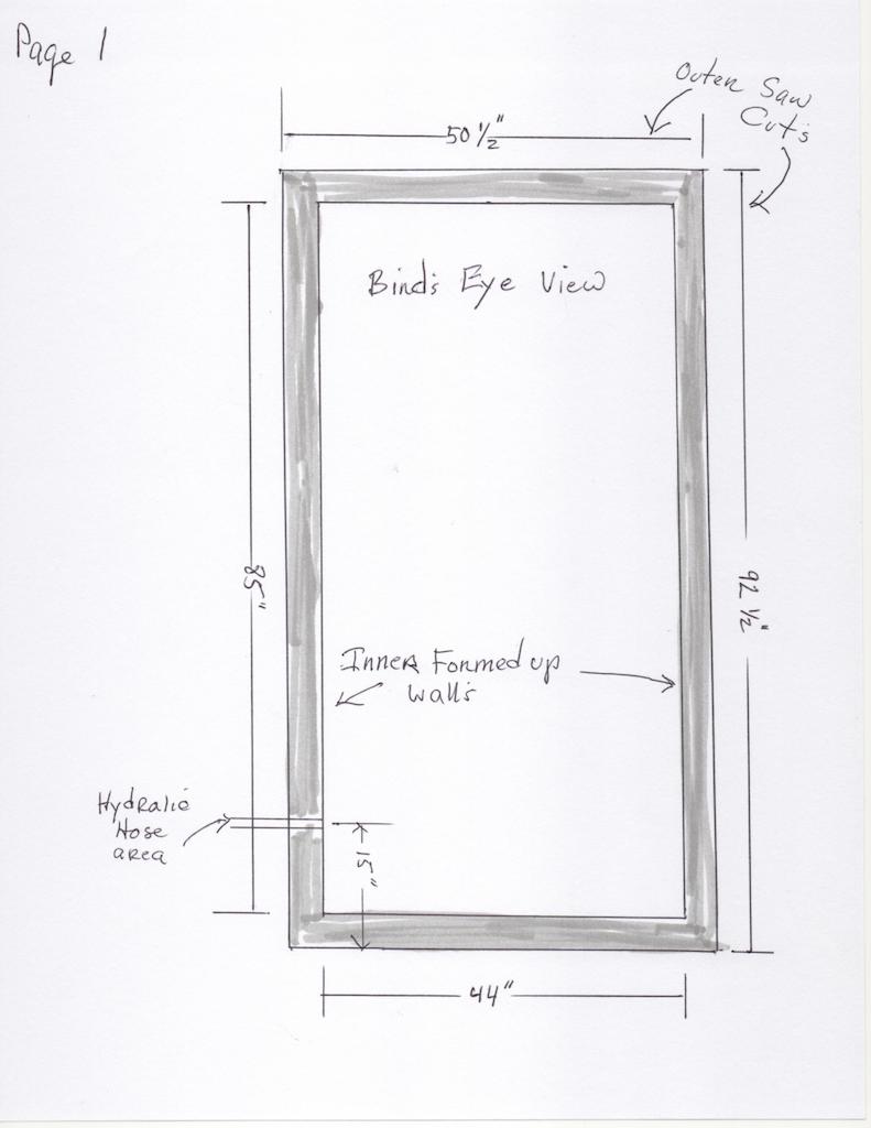

mlindner
Oct 30 2016, 07:49 AM
Hope this works, again this schematic is for my BenPak, but is the same size as most. Best, Mark

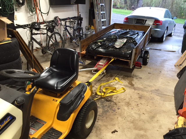

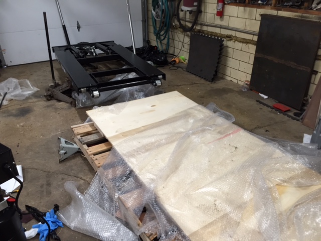

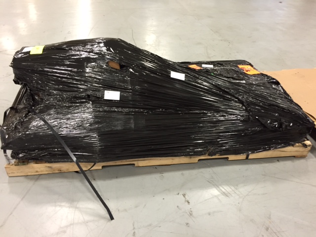

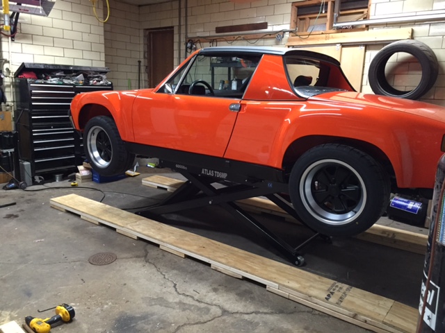

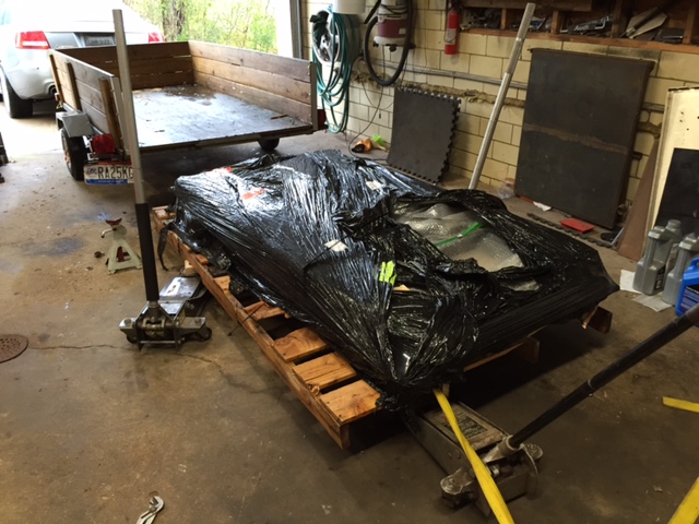

I got my TD6MR lift from Greg Smith Equip. last week and had it delivered to work. Thanks again “porsche913b” for getting us the $50 discount.
Click to view attachmentI used the forklift to load it into my trailer and backed it into the garage. I used my tractor to pull it out of the trailer enough to get three jacks under the skid and lower it to the floor.
Click to view attachmentClick to view attachmentI then used a steel bar to slide it slightly off the skid and then used the jacks to lift it off of the skid.

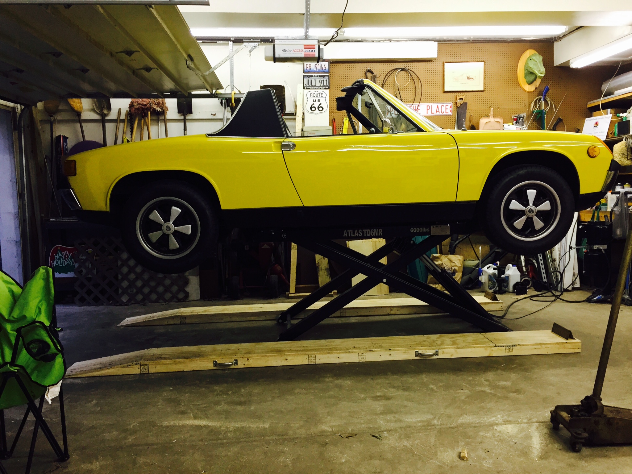

Click to view attachmentI built the ramps using one sheet of plywood and two layers of 2x4’s and they are a total of 14’ long. I started with just one layer of 2x4’s but it was just a little too low since my car is lower than shock. At some point I would like to sink it into the garage floor but this will work for now.
Click to view attachmentAs everyone has said previously I really wish I had bought this a long time ago since it works fantastic for my 914.
Unfortunately the arms aren’t long enough to use it on my wife’s 2008 A6 so I am going to have to figure something out to make it work for her car. I didn’t have time to check if it would work for my S5 or Cayman S yet but whatever I figure out for the A6 should work on all of my cars eventually.

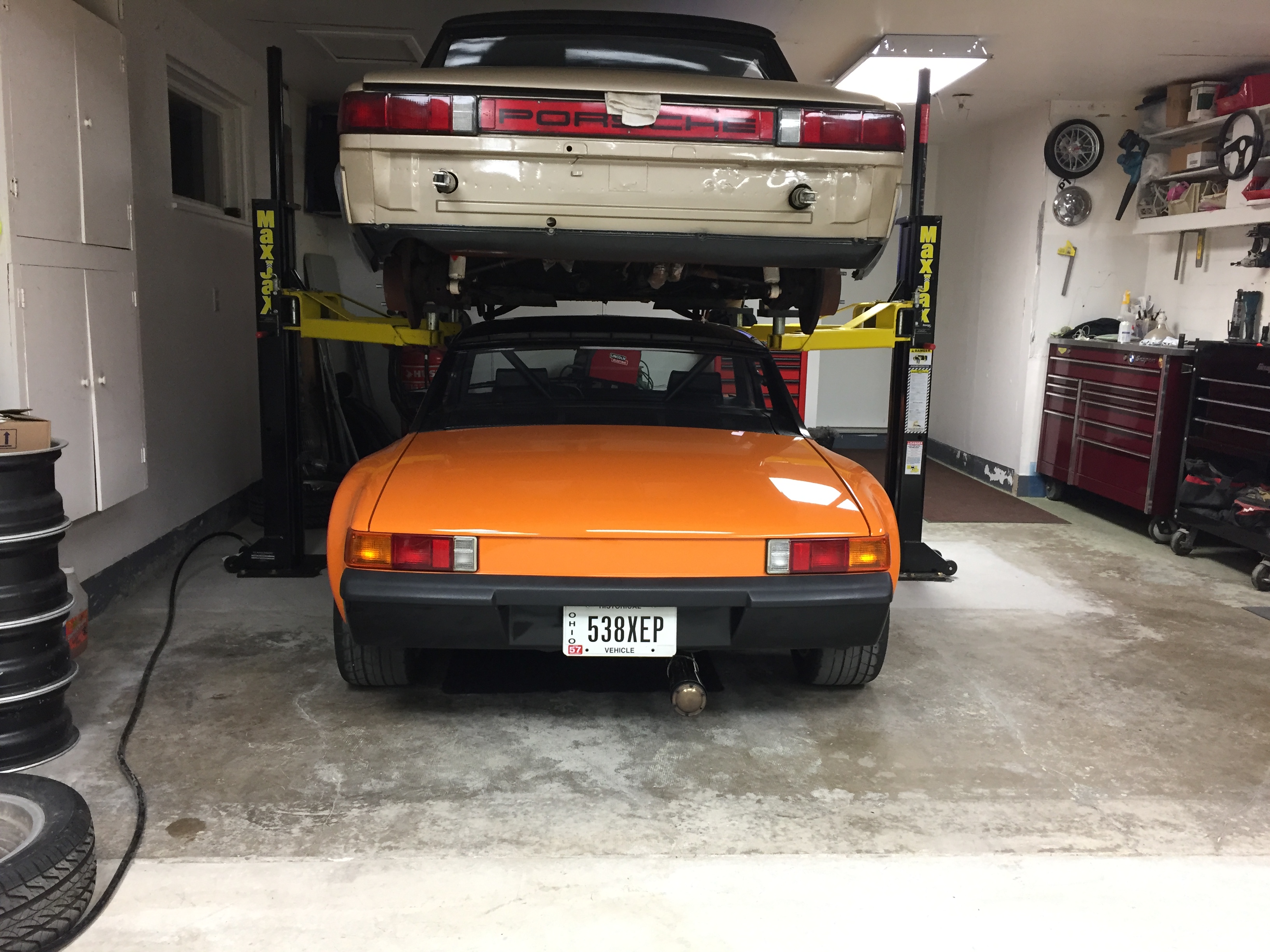

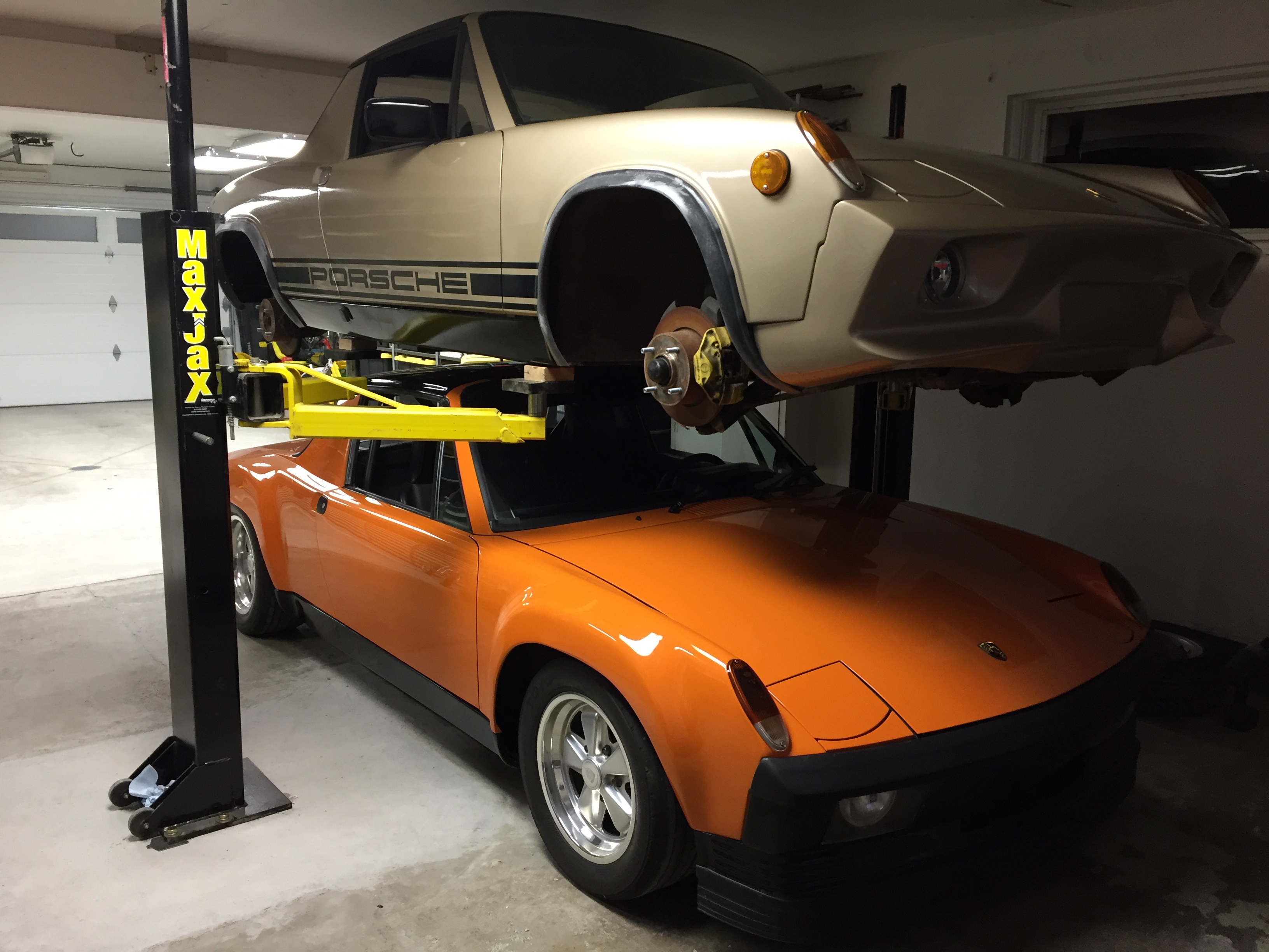

consider this alternative - MaxJax - a lot less install work and lifts 48" - easy R&R 914 engine-trans - mine was $1900 delivered
- and - it unbolts & gets out the the way when you want the space for other things - no forklifts required
you can come look at mine & try it at zip 95635 (40 miles away from Justin)

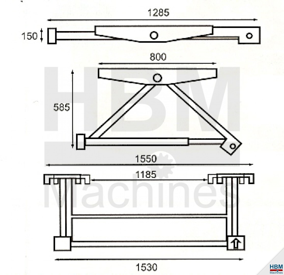

I do not want to hi-jack this thread, I think it is suitable info/questions related to the topic.

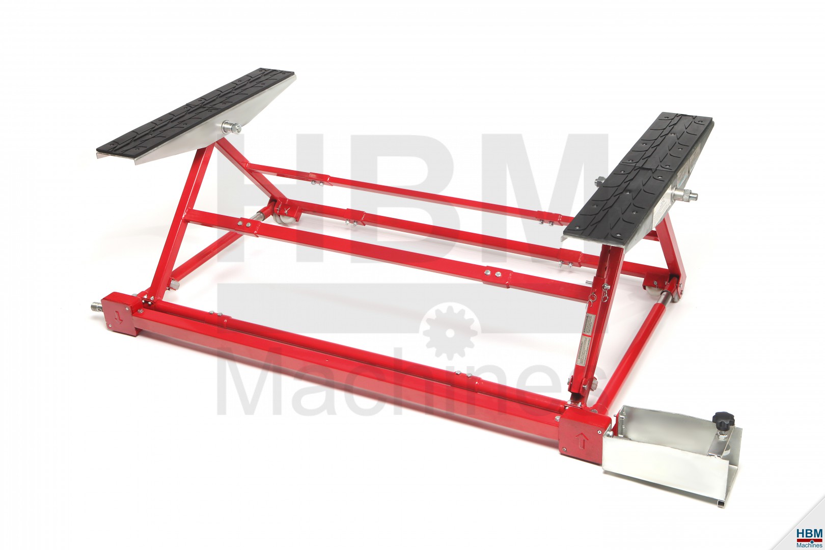

Interesting post, since I was looking to find info on a tilting lift and wanted to find out if they are suitable for 914's. The ones shown are a bit similair to what I was looking at, but slightly different.
Can we use a small Tilting lift on our 914's ? Or will 914's not like the place on the car they are lifted with this ? Right now I use the donuts to jack up the car, but this would help me a lot if this was possible.

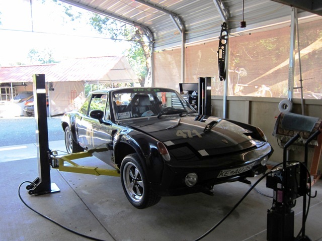

It is a lift like this:
Click to view attachment it is really low when 'at rest' and does not take up a lot of space (measurements are in mm, millimeters)
Click to view attachment a similair thing in action (nice relaxing music in the background)
https://youtu.be/vQT1-EibbbEI understand there are better alternatives than this, just wanted to hear if this was usable or not because of the way it lifts the car.
Thanks for your advice or opinion.

QUOTE(Frankvw @ Dec 8 2016, 02:22 PM)
A small bump to see if you have an opinion on my post above
" Can we use a small Tilting lift on our 914's ?"
It might be a great christmas present in case it is suitable for 914's.
thanks for your feedback.
My arm would give out cranking that thing.
Observations
-Floor jack and jack stands would be quicker and easier.
-I don't see any locking mechanism. I wouldn't get under that thing.
With an Electric hydraulic scissor lift, its a push of a button, locks in various heights and goes up to 4 feet high. Even with my low ceiling garage, I can roll around under my car with a garage stool on wheels. No more rolling around on my back working on the car.
I have a bendback scissor lift. Got it for $1200.00 before steel prices went up, many years ago. Best investment i ever made as a car hobbyist. It's just gonna get worse as you get older.

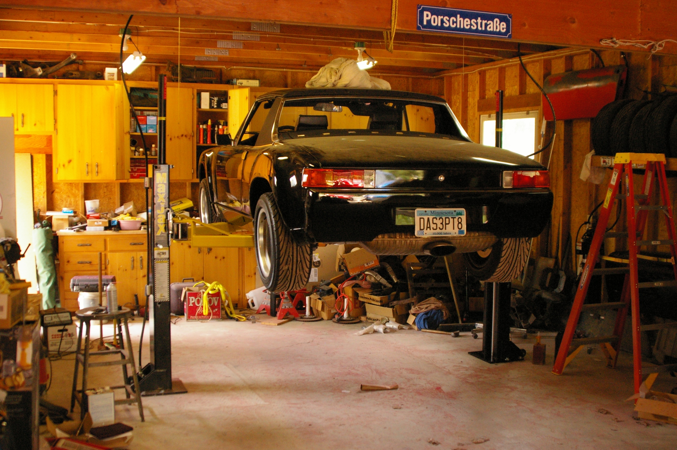

Click to view attachmentI really like this one. I wish I had seen it before I got the scissor lift. Very nice.

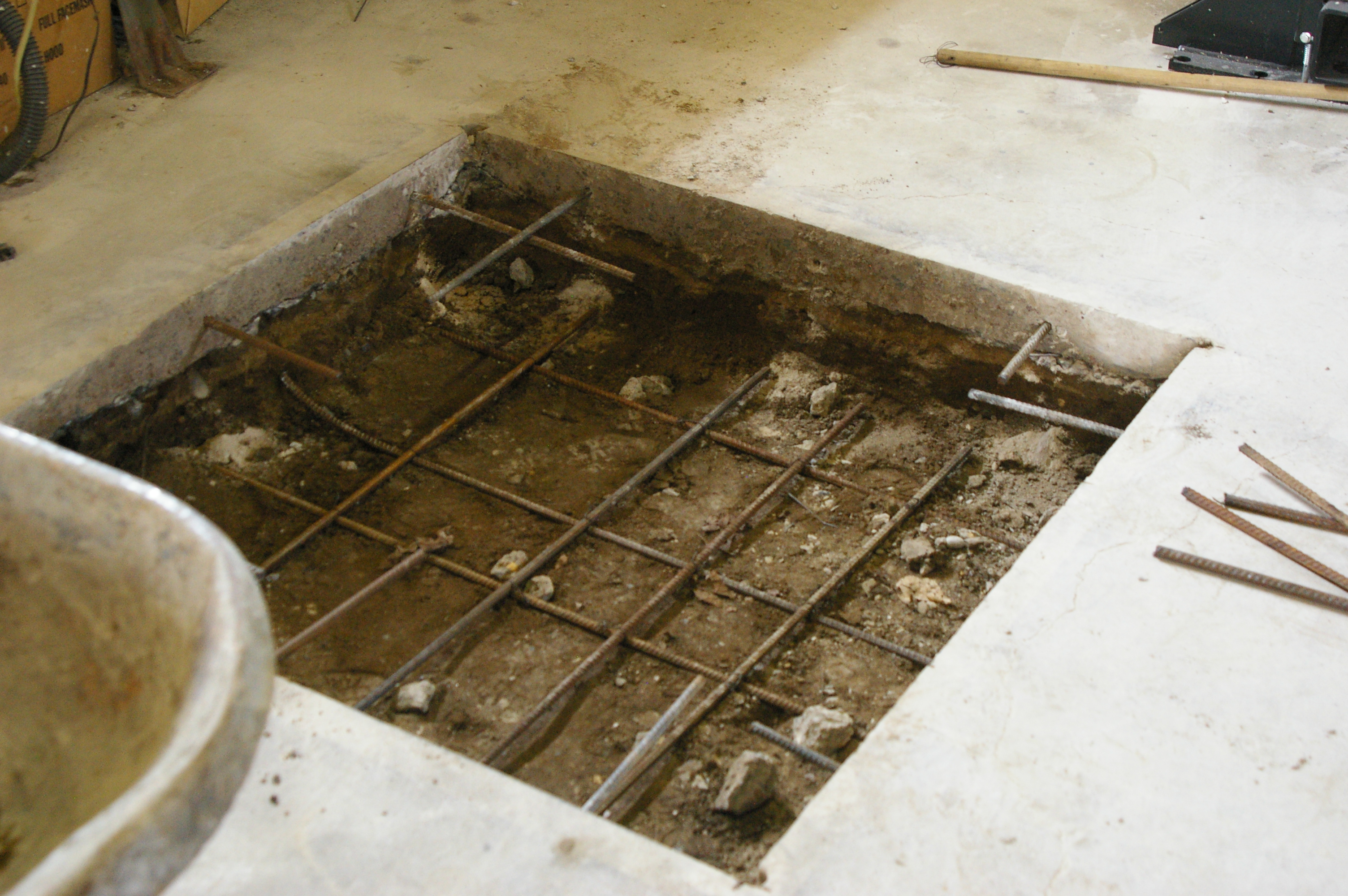

QUOTE(thomasotten @ Dec 15 2016, 06:06 PM)
How trusty are you of the Max Jack's floor bolts? Are they held down with compression style floor studs? How many are there for each side? the two post lifts always give me bad feelings thinking that the posts would cave in toward each other. Unfounded?
held down with 5 bolts, I cut out two 4'x4' slabs and poured a thicker slab of high psi concrete. The bolts are the epoxy type. No worries when they are installed properly.

There is another alternative to the scissor and two-post lifts - they're both limited to about 48-50" lift height. For a little more you can go with a single-post lift. It's portable and can be moved around the garage with built-in dolly. I haven't tried the 914 yet, but I suspect I'll need some 2x ramps to drive it up onto to clear the 4.5" base.

Guess again...
Just finished my Maxjax install and now have two stacked in the garage. I added the 3" Risers for more clearance. Can't be happier not having to use jack stands.
Click to view attachment Click to view attachmentClick to view attachment Click to view attachment
