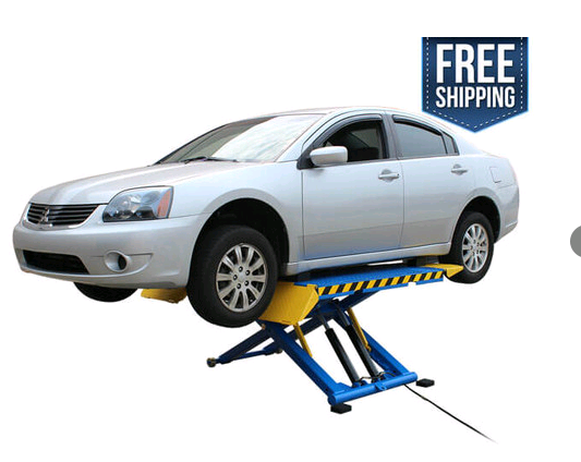

Hey guys (and gals). I know there are some older threads on this, but I am looking for a car lift that can go ~40" lift, doesn't need wooden ramps (for a 914) and doesn't break the bank. This Atlas lift from greg smith seems to come with shipping for $1745. Does anyone have this lift or something similar?
http://www.gregsmithequipment.com/Atlas-EM...se-Scissor-Lift
