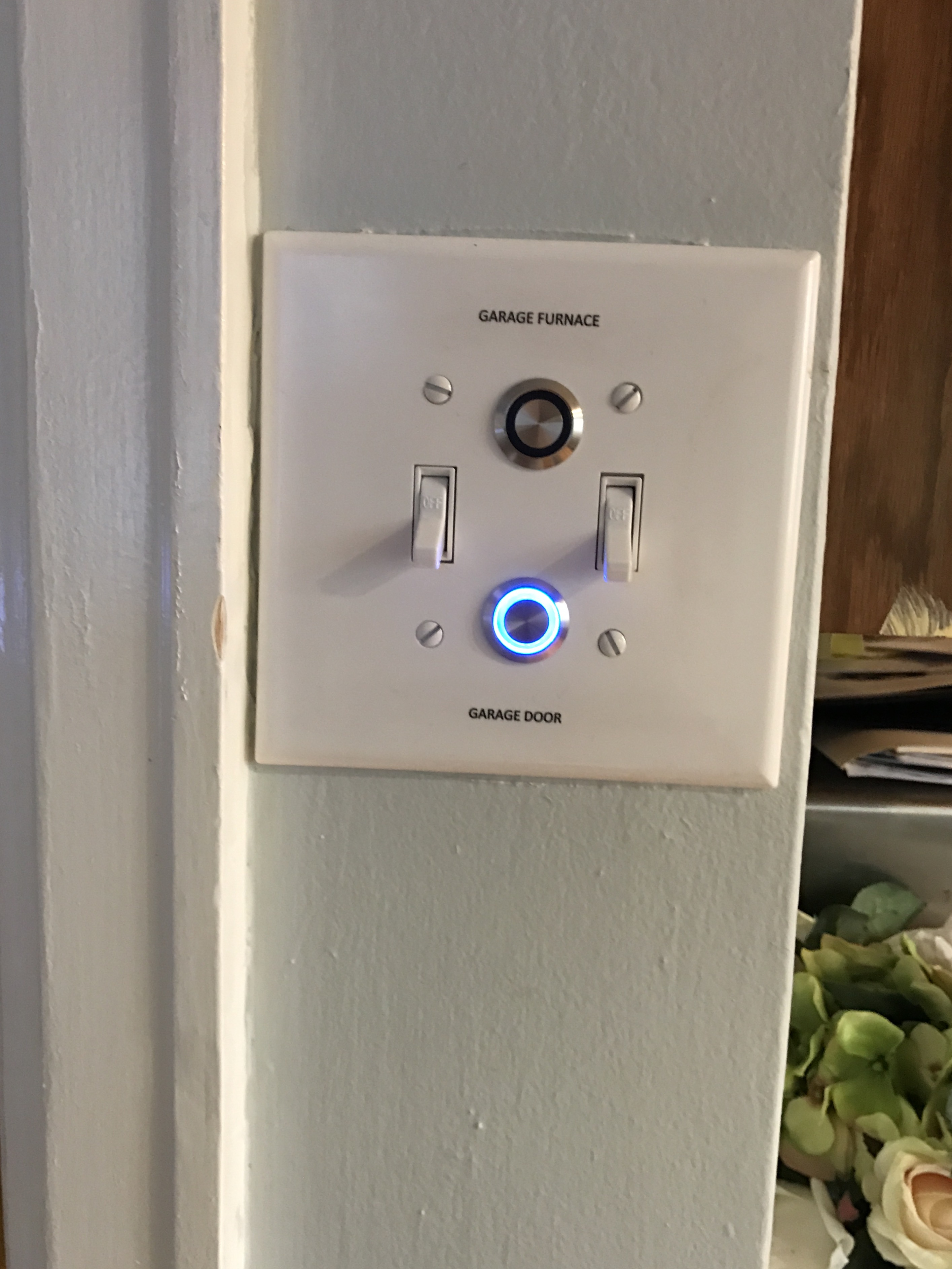

They make for great garage door switches
