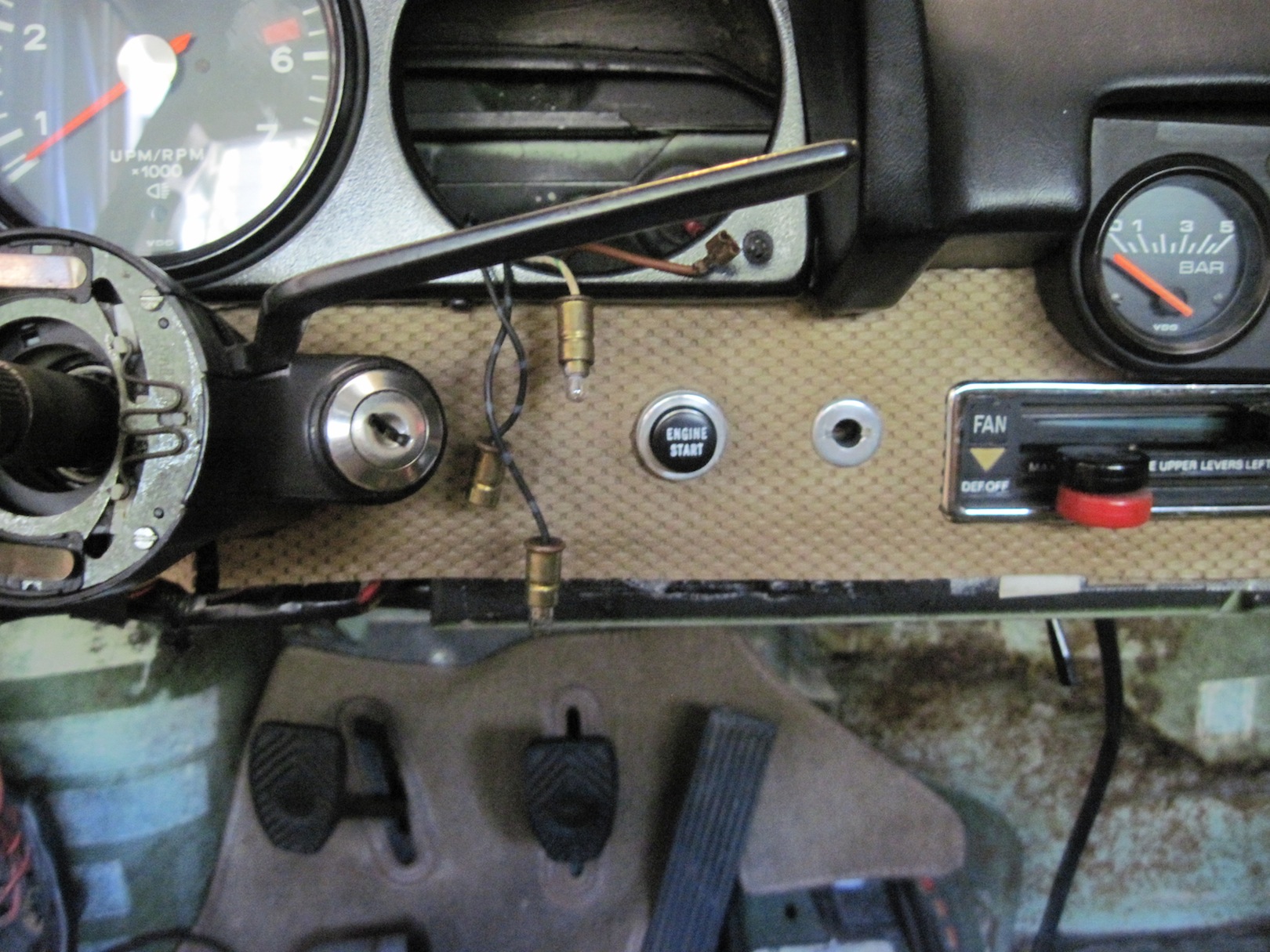

That's how I set this one up (aftermarket ignition switch was "iffy" in the start position):
Click to view attachmentWaytek "engine start" pushbutton installed in the cigar lighter hole; no new holes or cuts or anything. "Switched +" from fuse box to push-button (hot when ignition switch is "on"), then larger yellow wire direct from pushbutton to a Ford relay on the starter.
Font/type on the switch matches pretty well too . . .
Hope this helps.

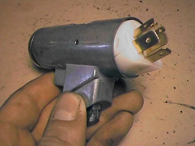

The crank position flows more current through the switch contacts then other electrical loads, and it fails sooner than the On or Accessory switch positions.
Why not? What's the cost of a new ignition switch/steer. wheel lock? Autozone ...... Autozone wants $800.00 :-O.
Click to view attachment Just need the contact section? That's only about $30, but not sure you want to go to the trouble of accessing it (pretty straightforward though).
I'm planning on installing a separate crank button.

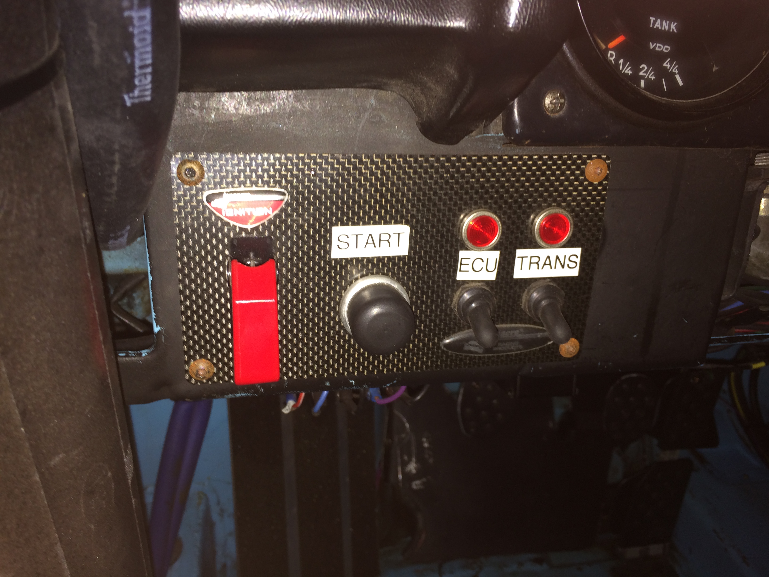

Papa Smurf has a push start and two switches: one for the starter and one for 'everything else' including the ECU. Flip starter switch, push button and develop oil pressure without ignition to prime the oil system, then flip ECU switch, start the car.
Good habit for race engines and cars that sit for a while.
Click to view attachment(damn those screws look rusty!!)
