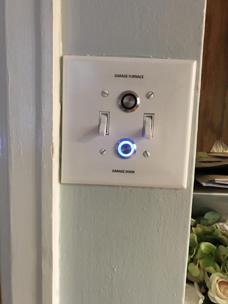

timothy_nd28   They make for great garage door switches   Nov 27 2016, 02:08 PM

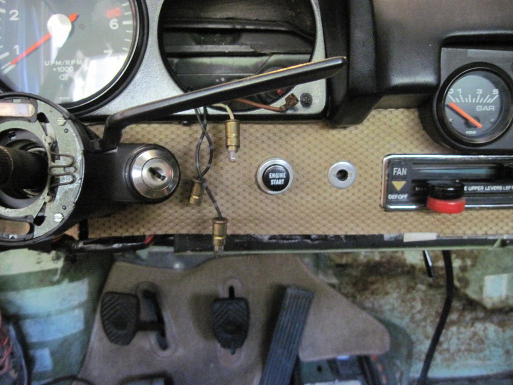

patssle   I have a push button on mine and have found it ext...   Nov 29 2016, 06:35 PM
matthepcat   ^^ My 914-V8 had that same type ^^ It never let m...   Nov 29 2016, 06:40 PM

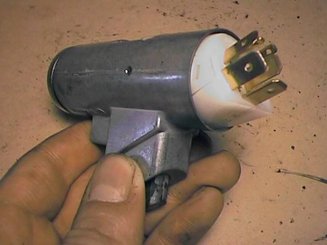

jcd914   I did not see this mentioned, so ... One of the t...   Nov 29 2016, 08:02 PM
