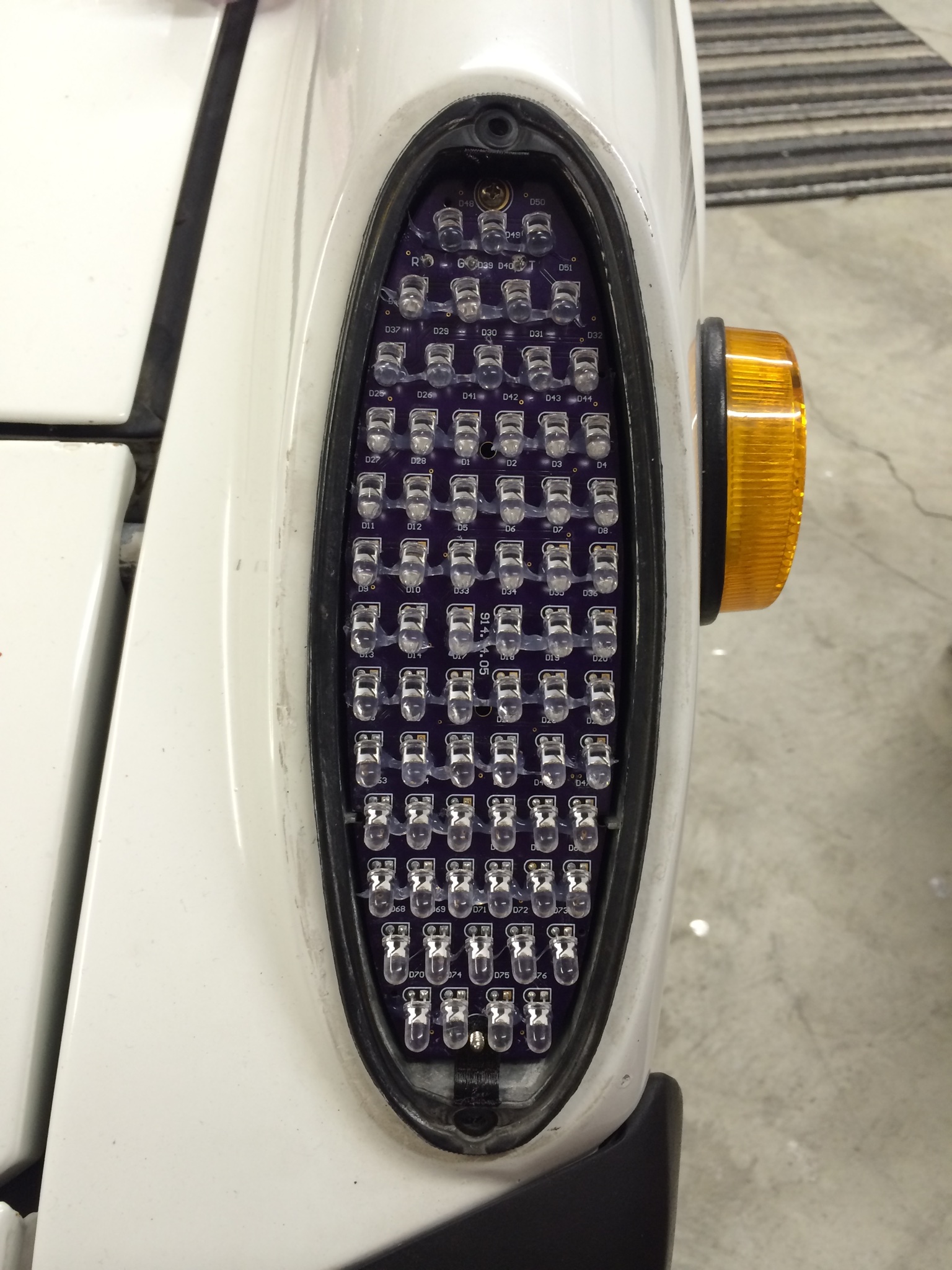

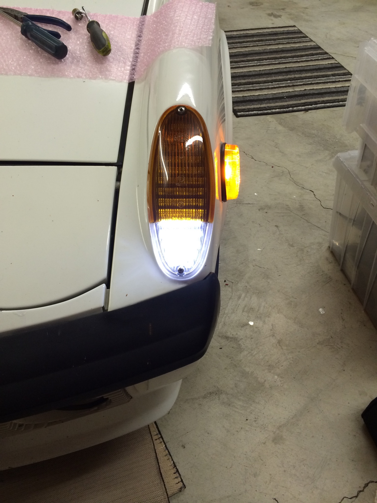

You could also do something like this:

Thanks both for the advice. I had seen a picture with only 1 wire running from the lower fitment which in turn enhanced my confusion.
Liking the led set up. If I had the extra in my budget (hadn't bought other stuff!) I'd have a full set for the car.

I think Camp914 has a kit.
The LEDs are awesome though. Is it just plug&play?

Oh duh, I just read the website where it says they are "Plug & Play"
