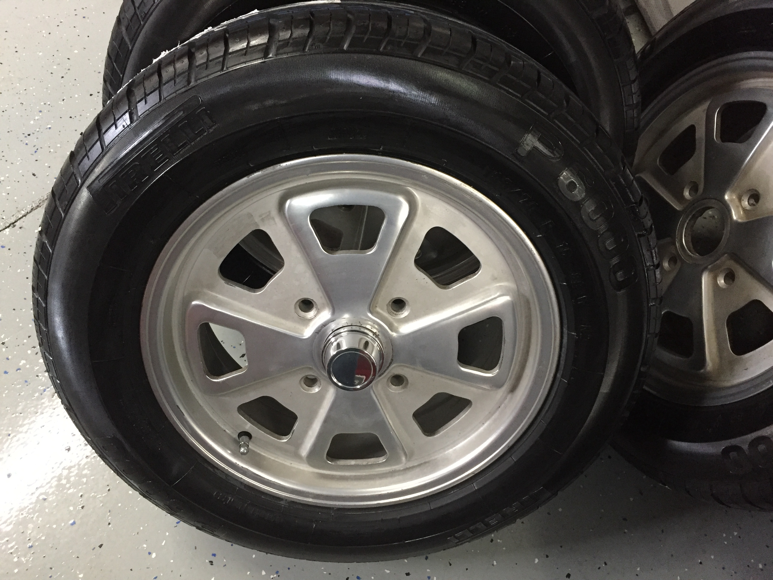

simonjb
post Dec 5 2016, 03:02 PM
KiwiMan
Posts: 574
Joined: 18-October 16
From: Stamford, Connecticut
Member No.: 20,505
Here are the Pirelli P6000 185 70r15 I got for the Fuchs and the 165HR15 I got for the spare
gcrotvik
