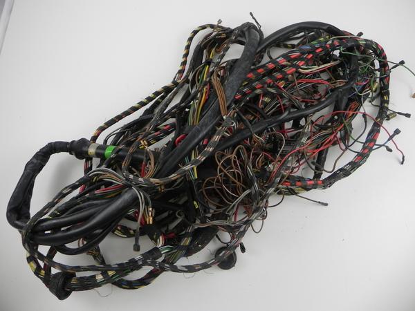

raynekat
post Jan 8 2017, 05:51 PM
Posts: 2,171
Joined: 30-December 14
From: Coeur d'Alene, Idaho
Member No.: 18,263
I went this route.
Purchased from Aase for USD $1500 an NOS harness for a 1971 914-4 (the same year as my car) and will have some mods done to an engine wiring harness and a couple other additions/deletions to make it all work.
I'm converting from 4 cylinder to a 2.4 MFI 6 cylinder engine.
http://www.aasesales.com/collections/porsc...ucts/f1n-105381
gcrotvik
post Jan 8 2017, 05:56 PM
Posts: 361
Joined: 16-December 09
From: Portland Oregon
Member No.: 11,134
I considered buying that harness. Nice!
