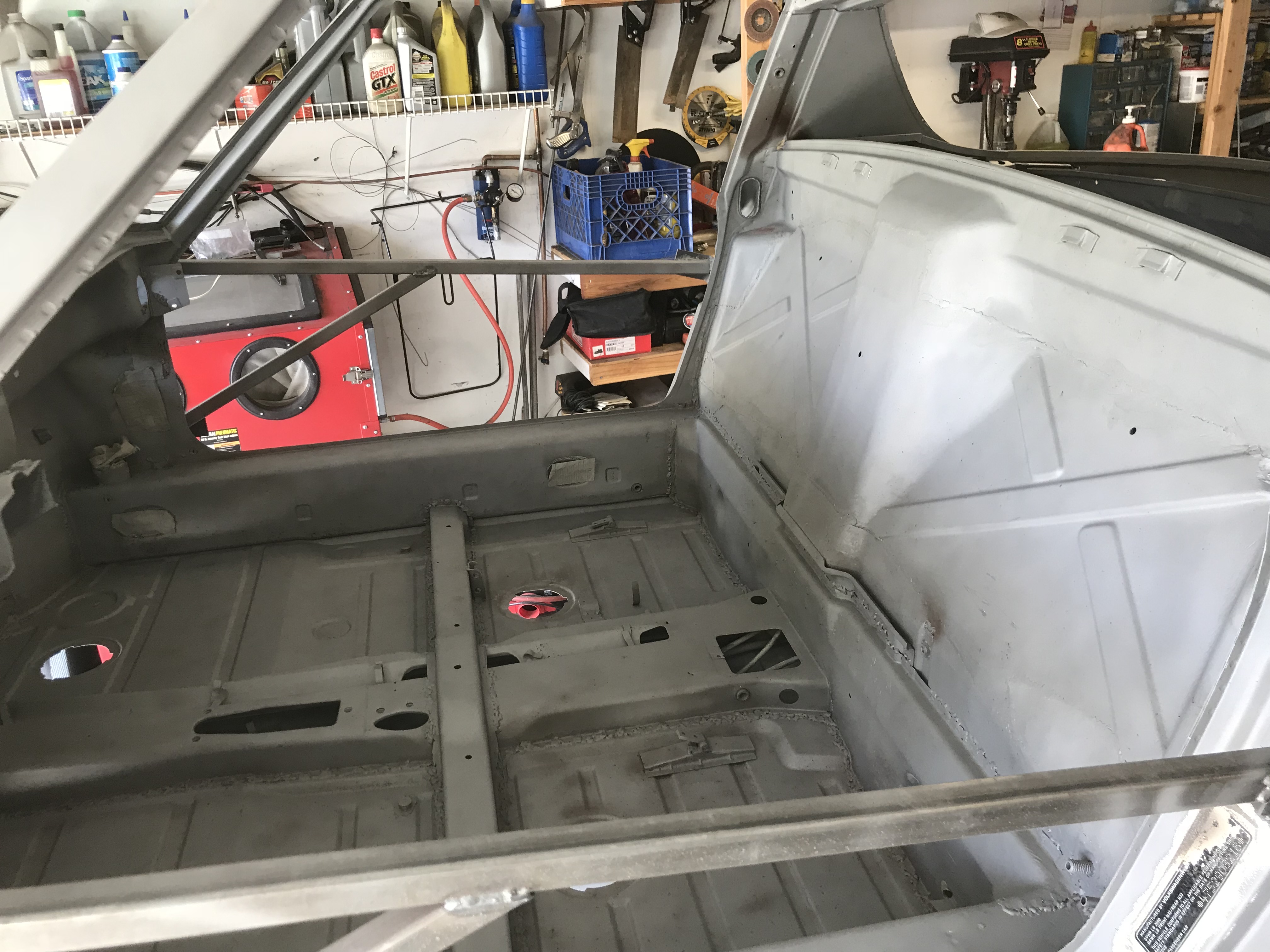

And so it begins.

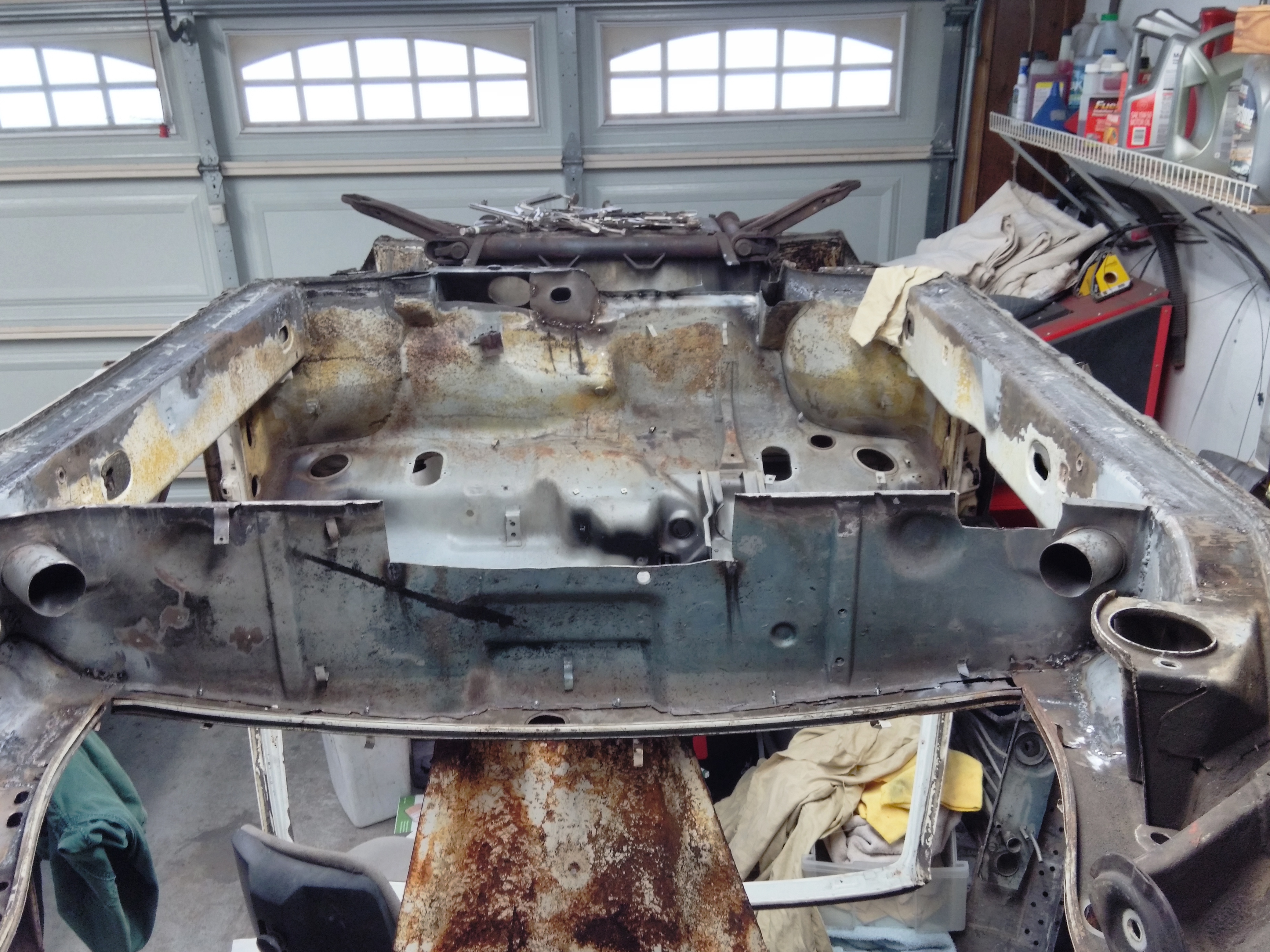

I am starting to bring back a 75 that was sitting in a field since around 92. A little damage on the passenger side that only took a short time to rough out.
I modified a couple of old engine stands so I could fully rotate the car.
Most of the damage is the floor and back firewall from a loose rear window. I have not found any rust in the longs, YET.
I just finished a 4 year project restoring a 59 Karmann Ghia. It was my first restoration.
I have not decided where to go with this car yet. I originally wanted to recreate the last 914 I had in the early 90s but we will see where it goes.Attached Image

The doors are braced and I will replaces sections at a time as not to weaken structures unnecessarily. My biggest problem is I don't have a truck n trailer and a VERY tight budges so getting it blasted will be the biggest hold up. Once I get that done it should move relatively (for me) quickly.

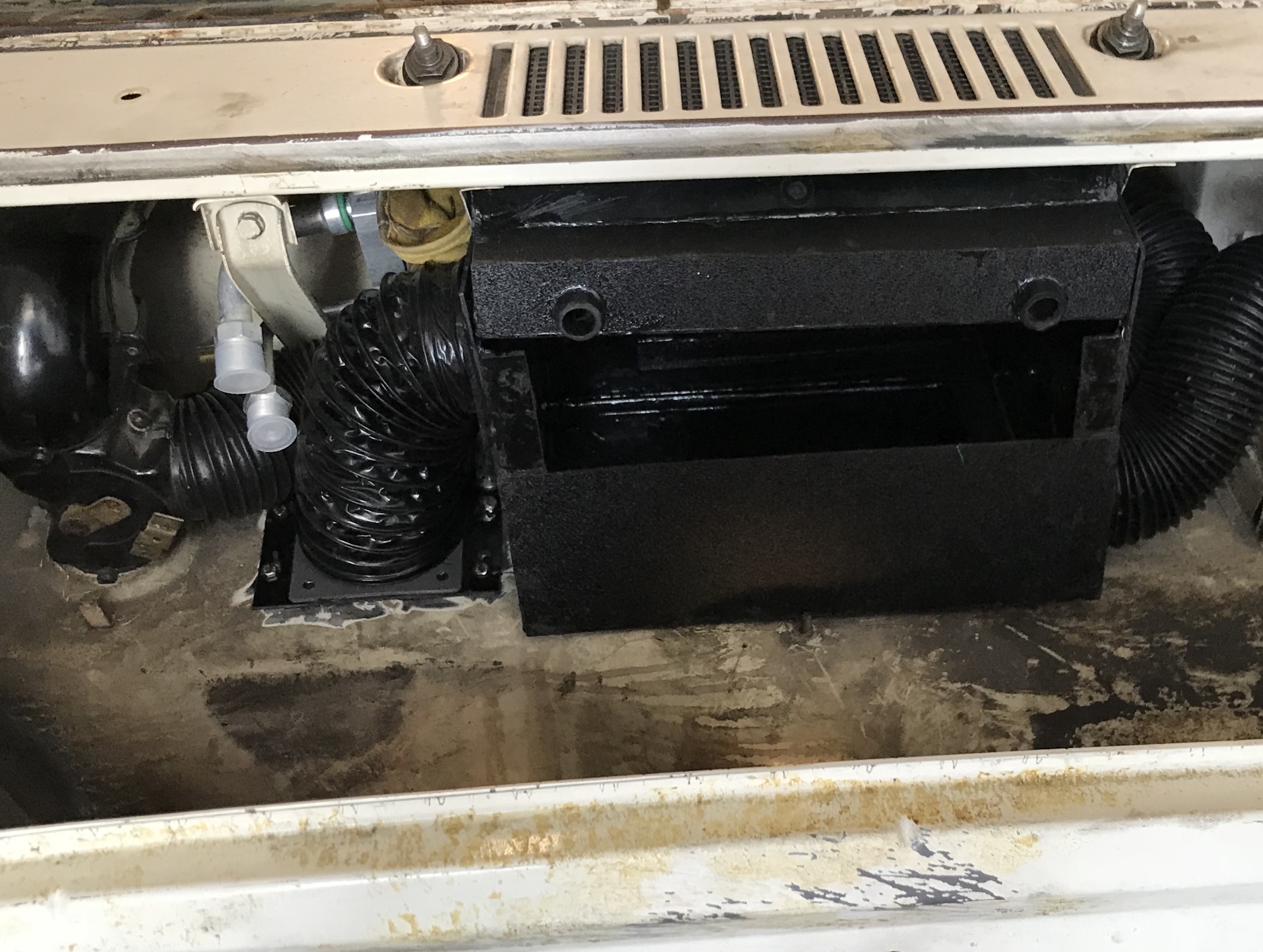

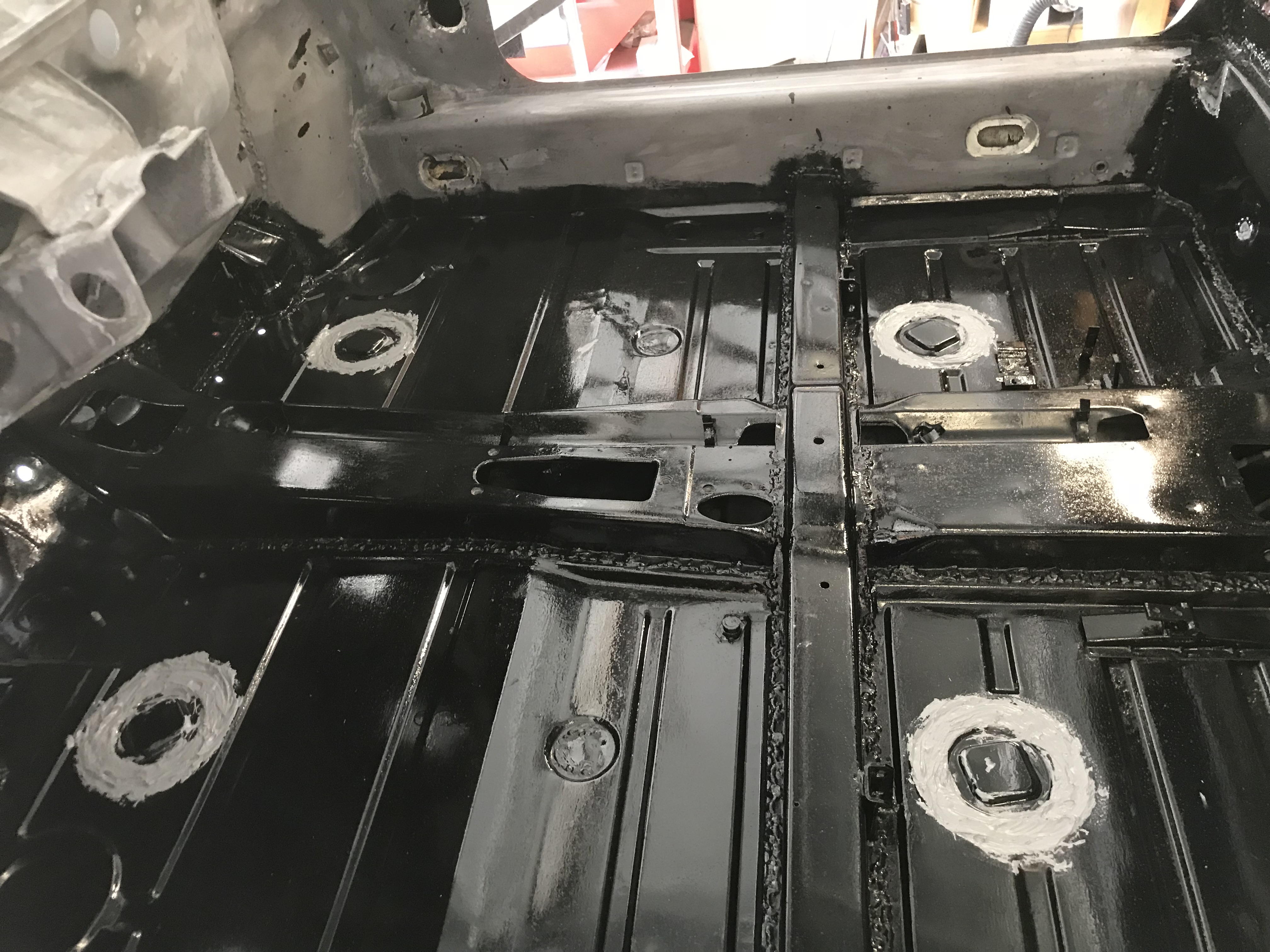

Well, I have made a lil progress since my last post. Got the firewall and all of the floor structures replaced plus all the lil rusty bits all around the car. Hood struts placed, hidden battery compartment, started on my custom AC and more.
Just a few picts of the progress

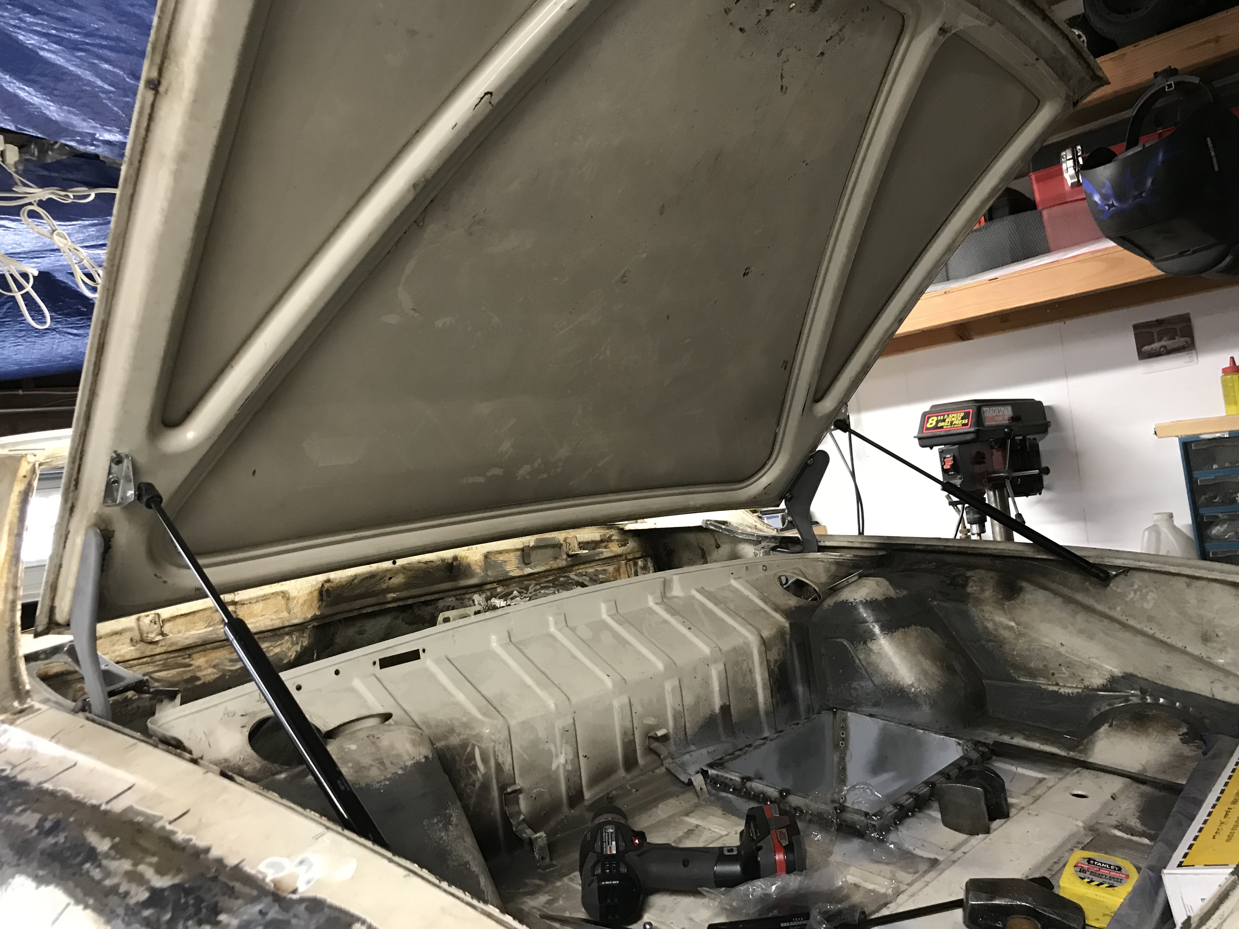

Strut placement

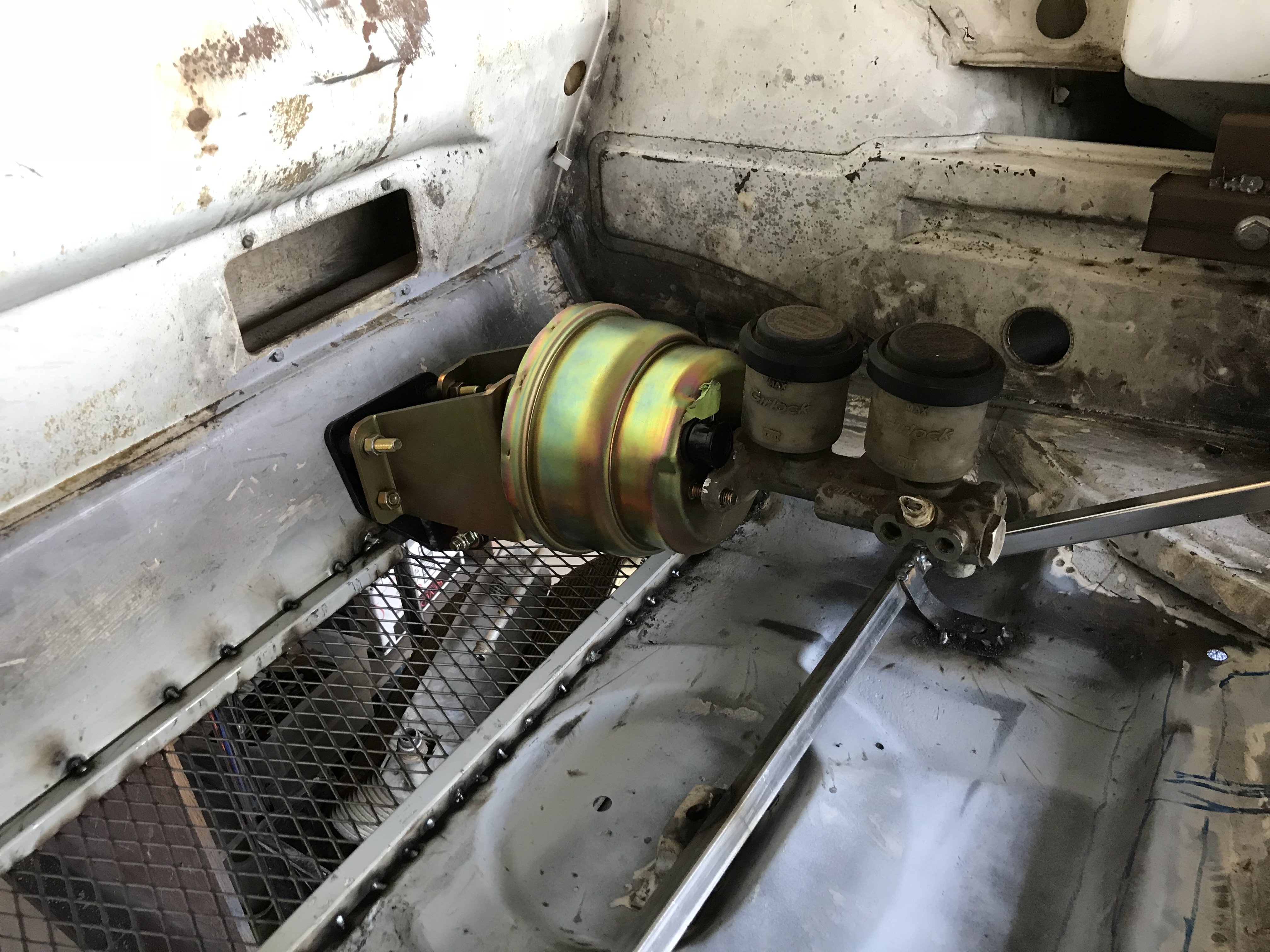

working on some brake boost for olden years

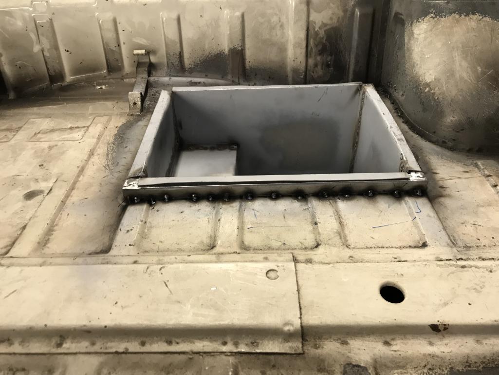

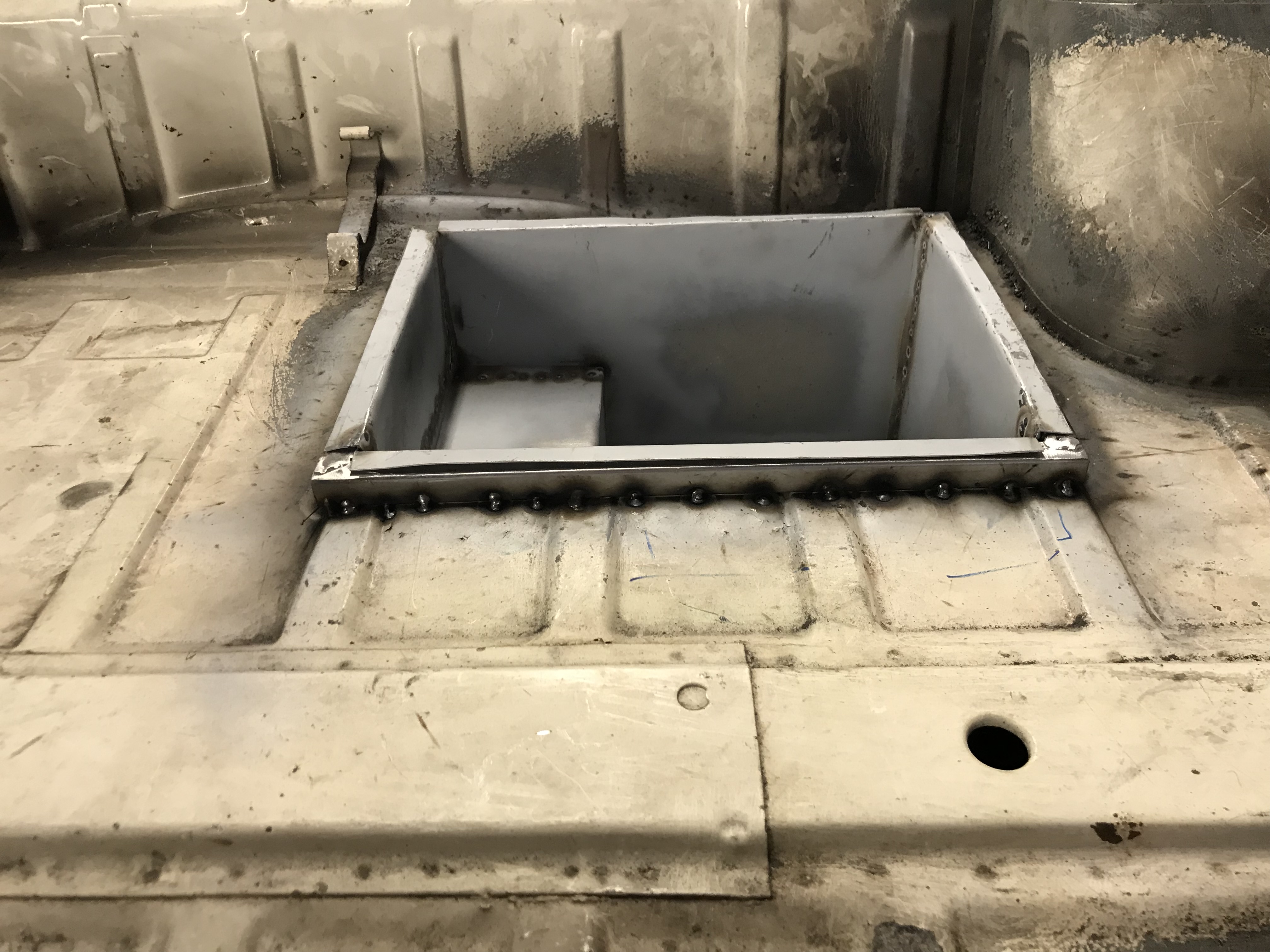

Battery out of the way

Por 15 in all rust prone areas all over the car

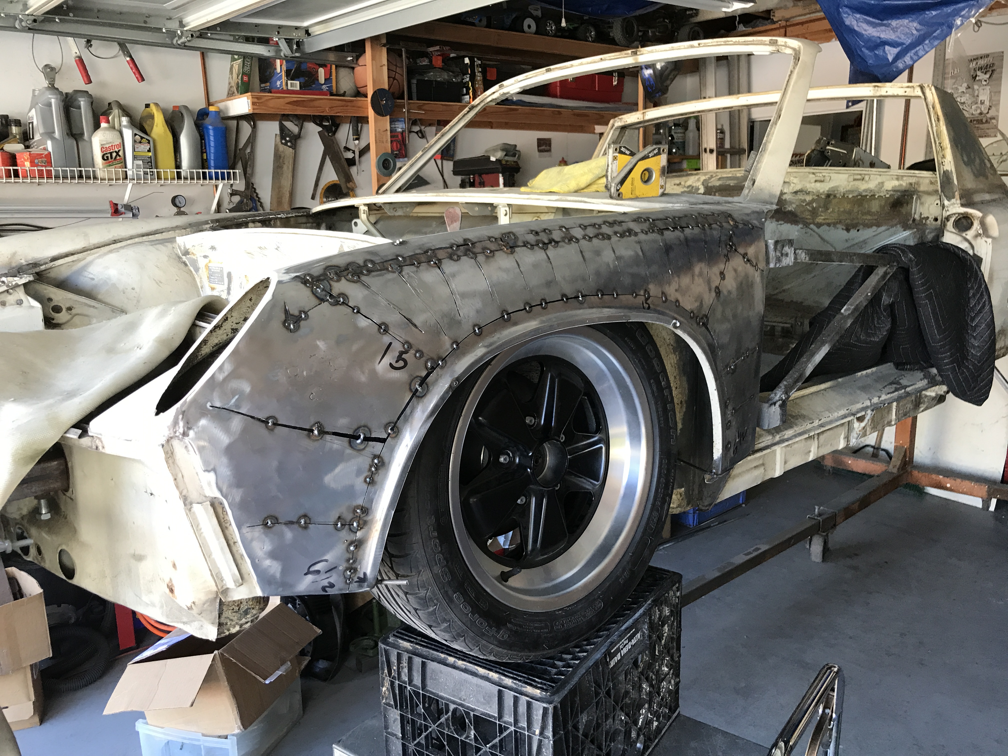

Moved the fenders out a lil

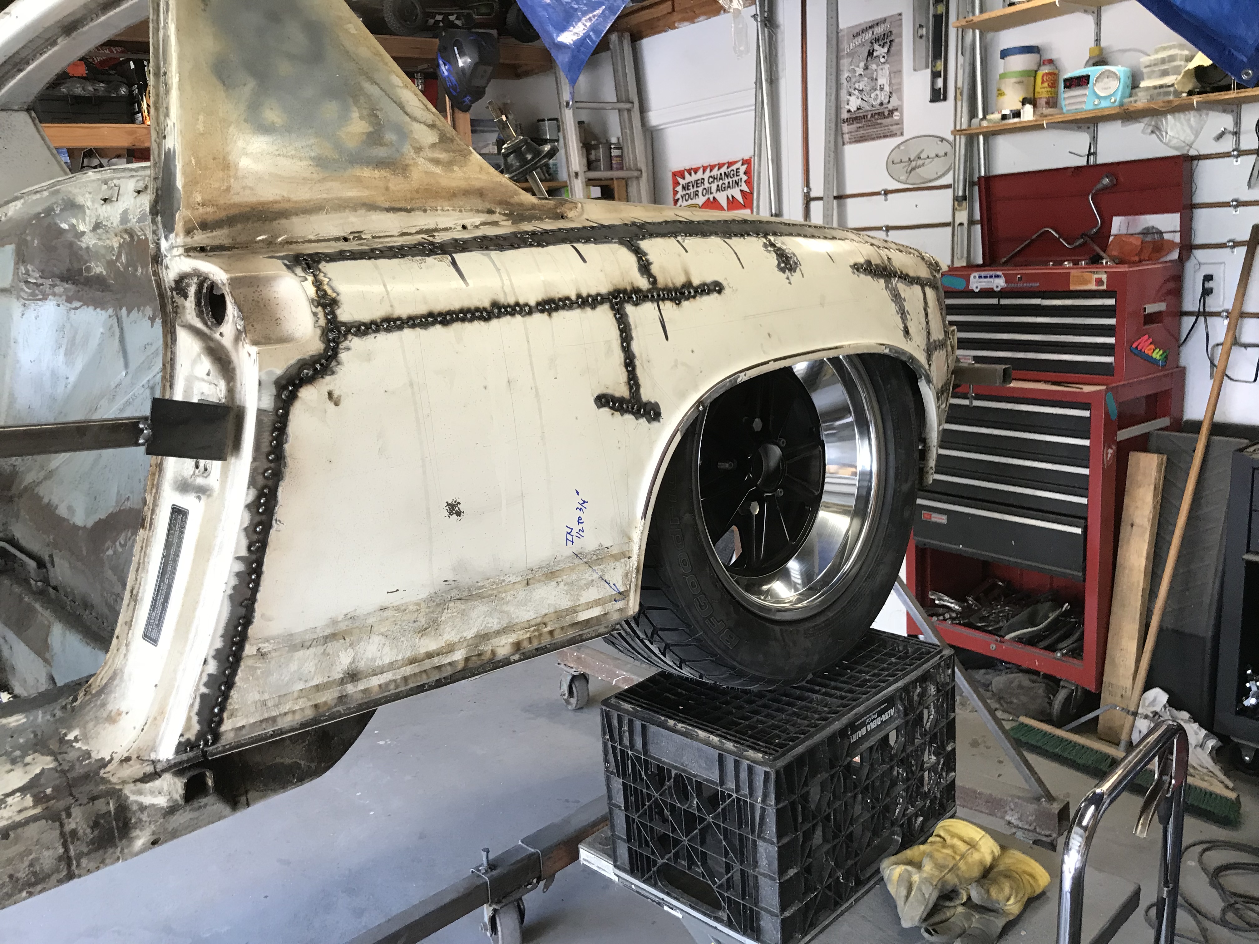

Front fenders out
post Apr 4 2018, 05:05 AM
914-6 GT in waiting
Posts: 19,970
Joined: 19-September 09
Member No.: 10,825
Wow, nice job on the flares.

Wow! You must like to weld (IMG:style_emoticons/default/aktion035.gif)

QUOTE(djway @ Apr 4 2018, 03:11 AM) *
See now that is what I would have liked to do if I had the welding and metal skills to do it! I like this approach vs weld on flares, can't wait to see how it all turns out.
Very nice!
