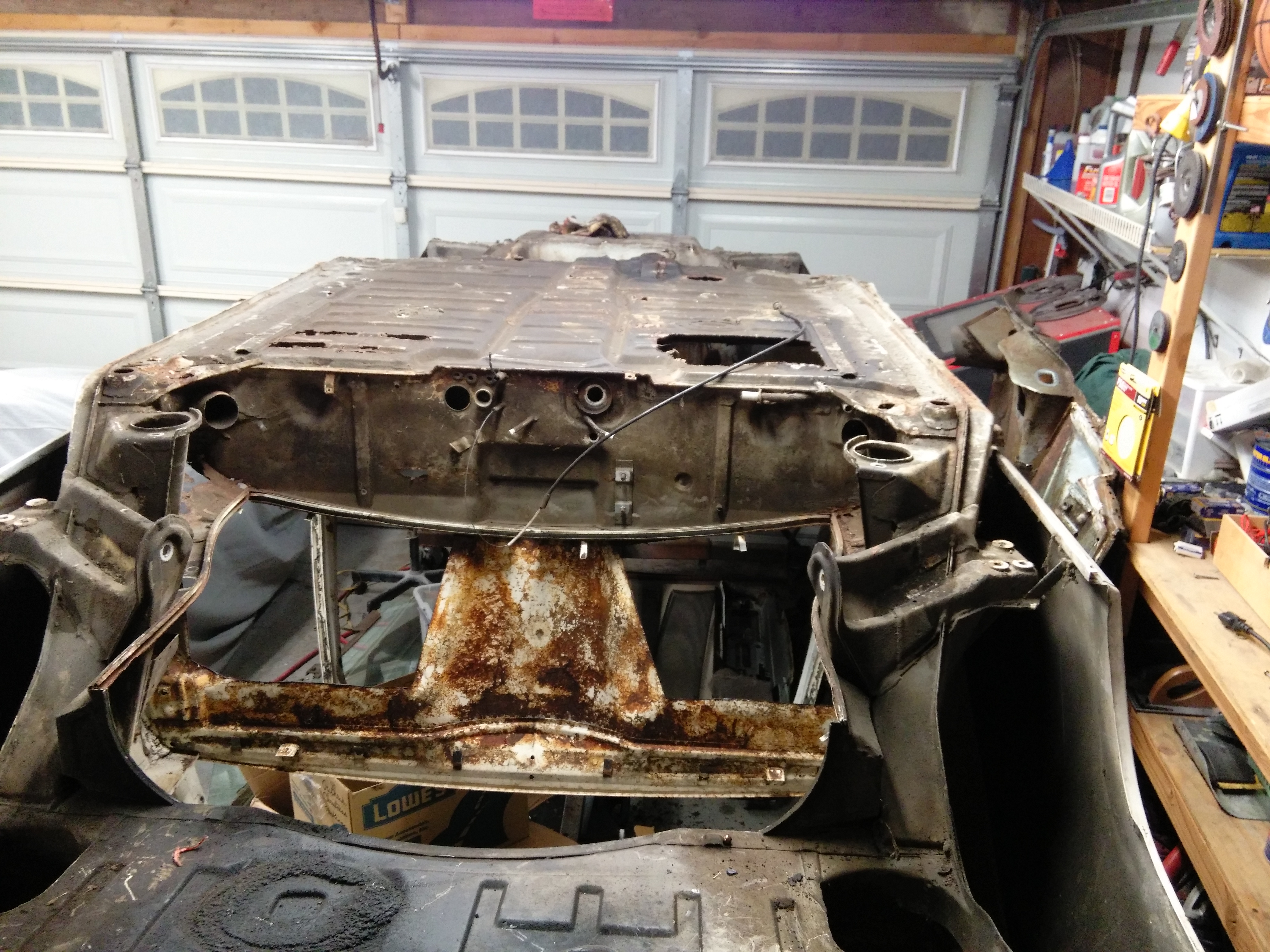

I am starting to bring back a 75 that was sitting in a field since around 92. A little damage on the passenger side that only took a short time to rough out.
I modified a couple of old engine stands so I could fully rotate the car.
Most of the damage is the floor and back firewall from a loose rear window. I have not found any rust in the longs, YET.

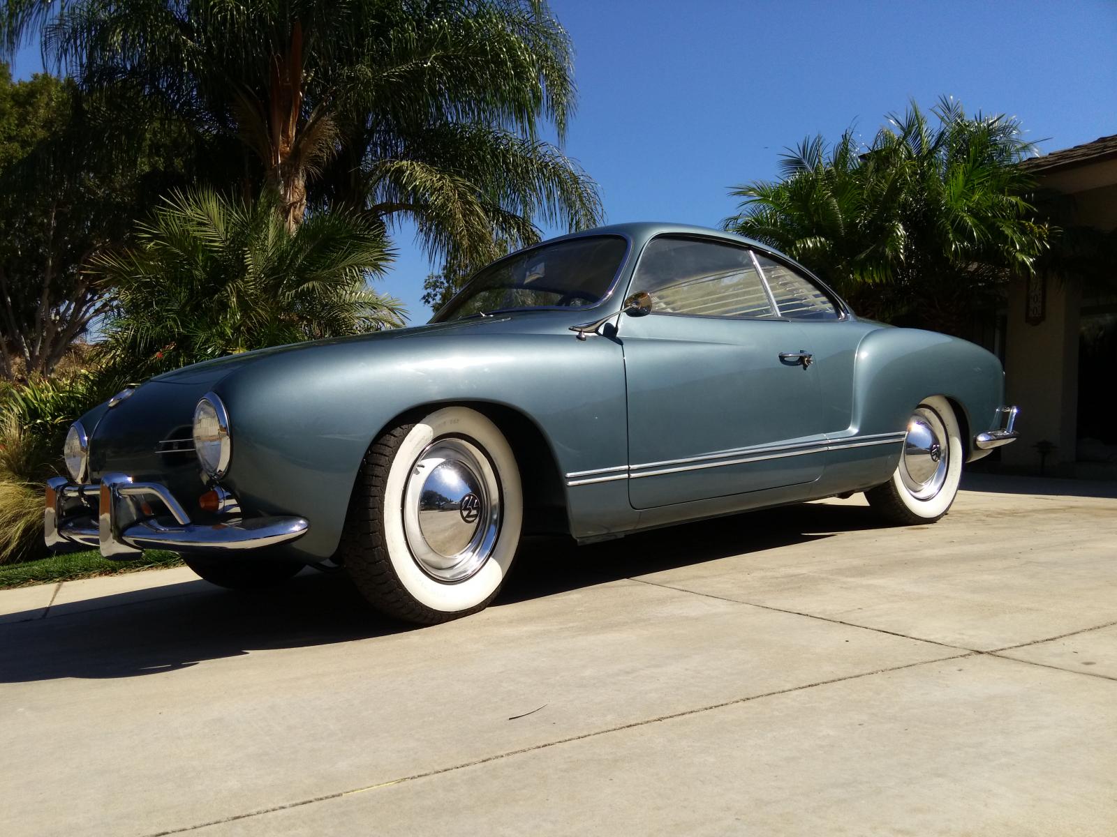

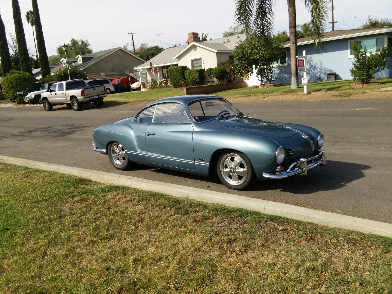

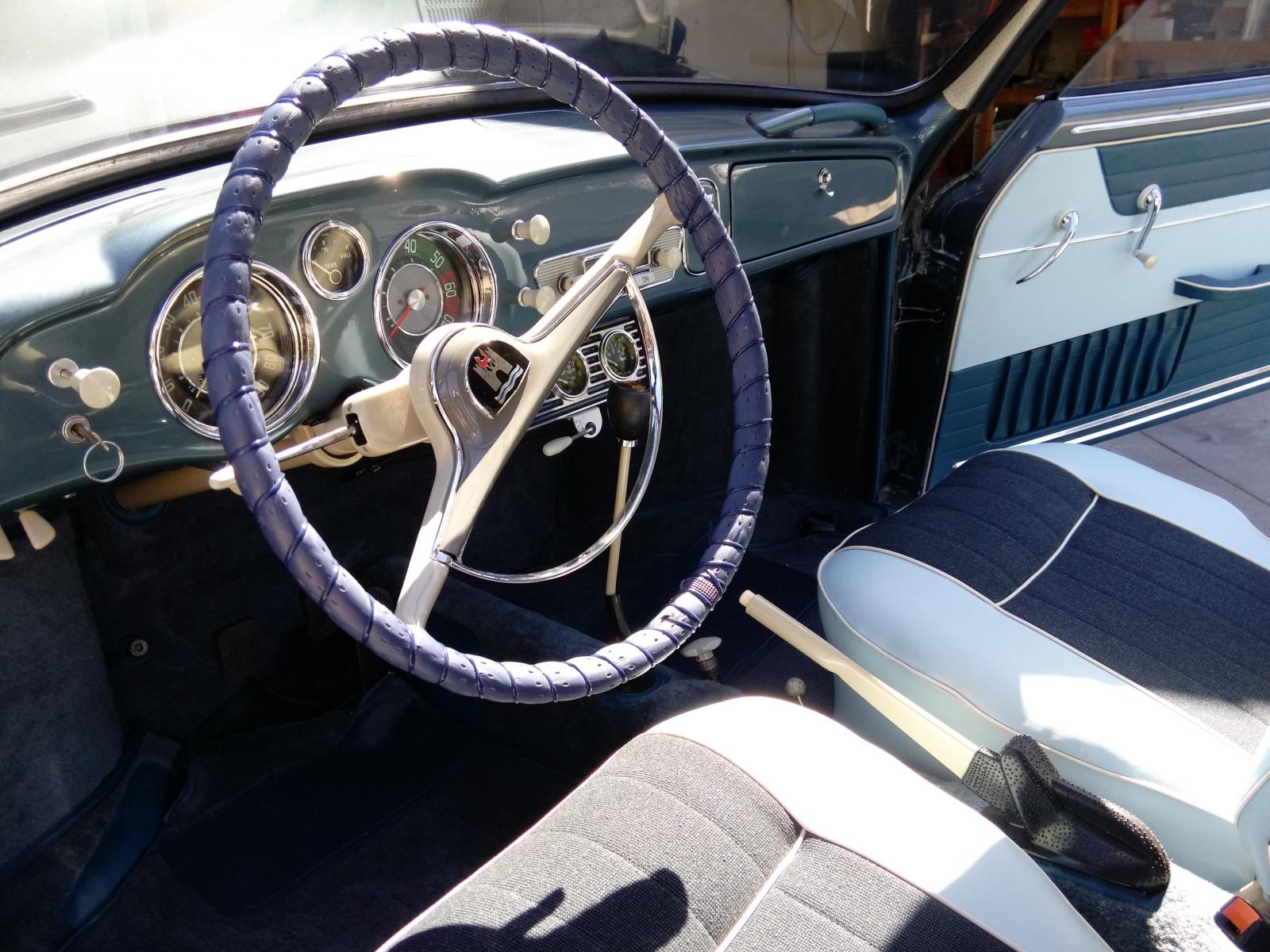

QUOTE(Cairo94507 @ Jan 10 2017, 05:16 AM) *
Very nice project. Good luck and may your rust be minimal.
A '59 Ghia - please post some pictures of that car. Always loved me a Ghia. beerchug.gif
IPB Image
IPB Image
IPB Image
IPB Image

Well, I have made a lil progress since my last post. Got the firewall and all of the floor structures replaced plus all the lil rusty bits all around the car. Hood struts placed, hidden battery compartment, started on my custom AC and more.
Just a few picts of the progress

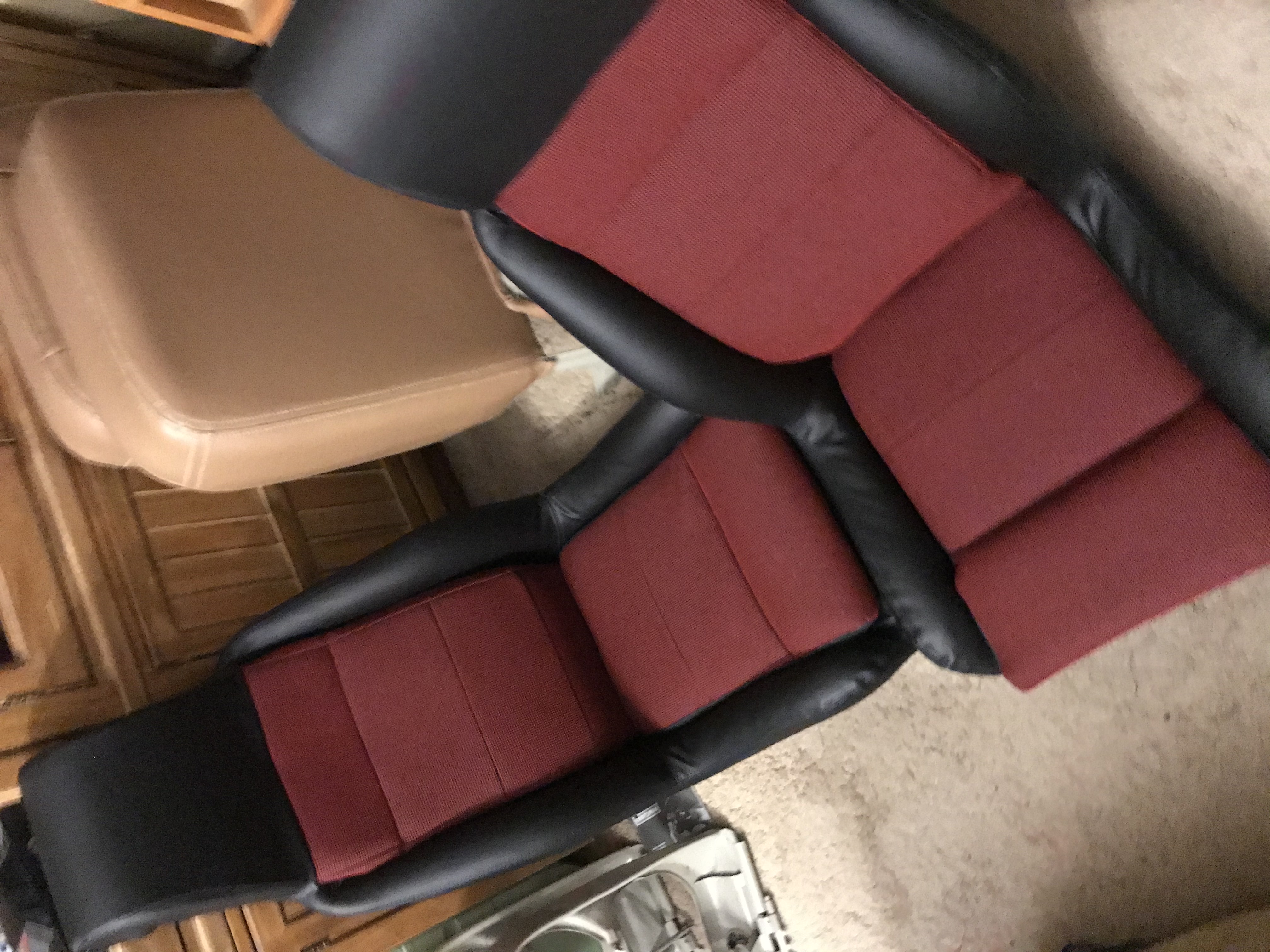

djway
With all the rain it was lucky that I had already purchased the fabric for the seats. Nowhere near needing them yet but I was stuck inside.
I increased the bolster height and I added a lot of lumbar support. On the drivers seat I also installed an inflatable lumbar pad in case I need more wacko.gif
I have not tried to heat out the wrinkles yet.

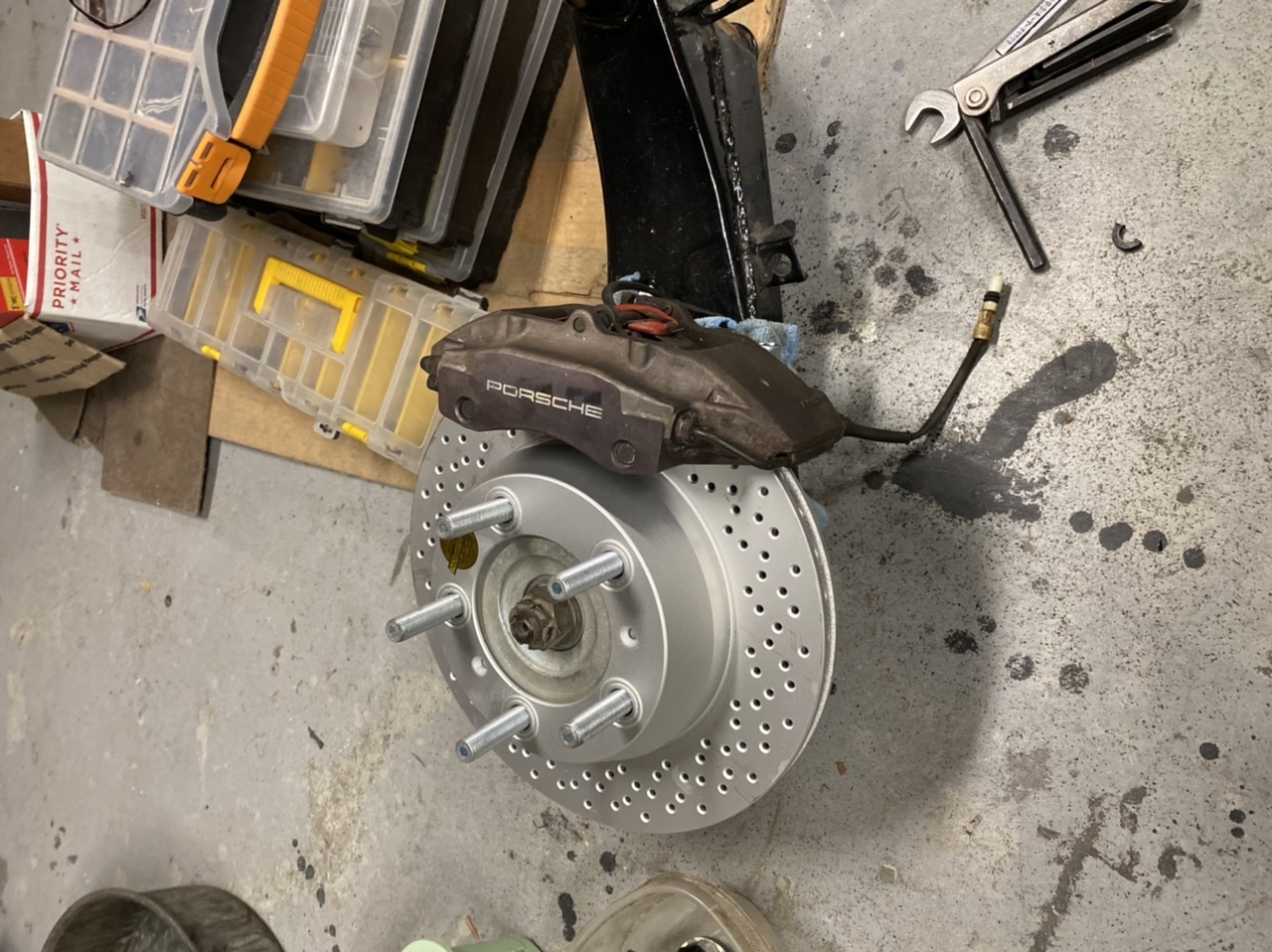

For several years I have been tinkering with a new way to have vented rotors without requiring 911 parts.
I found the Sebro rotors/hubs for the front but they only work with early struts. I went as far as converting a pair of early struts to the later ball joint. This wasn’t a bolt on solution which was my challenge plus you have to order the rotors from the old world and they are expensive by the time they are shipped. In addition if rotor damaged or worn everything must be replaced. Still wasn’t satisfied.
Watching some T3 VW builds with 944 suspension and 901 5 speeds I came across some combinations for brakes that got me thinking.
After several variations I settled on this
Complete bolt on Boxster/Cayman rotor and caliper on the later 914 strut.
Mission accomplished.

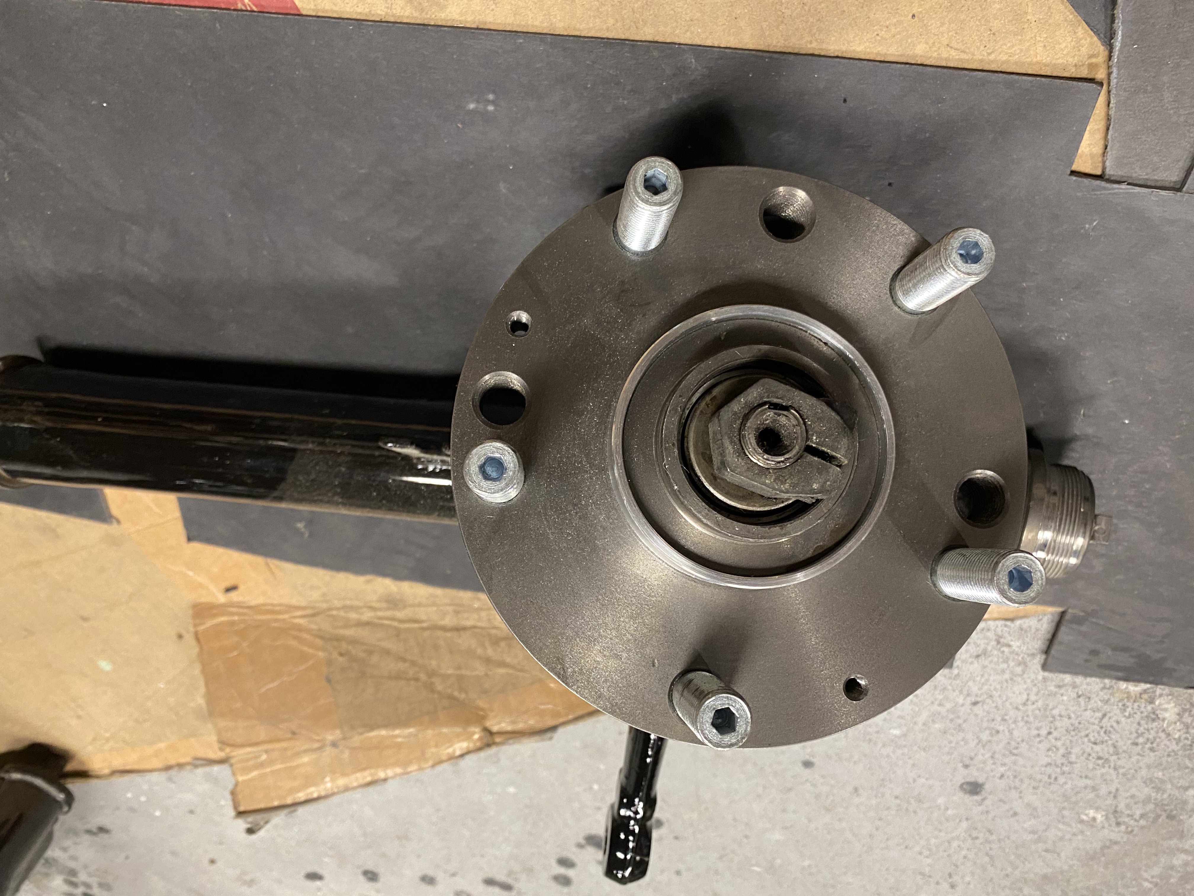

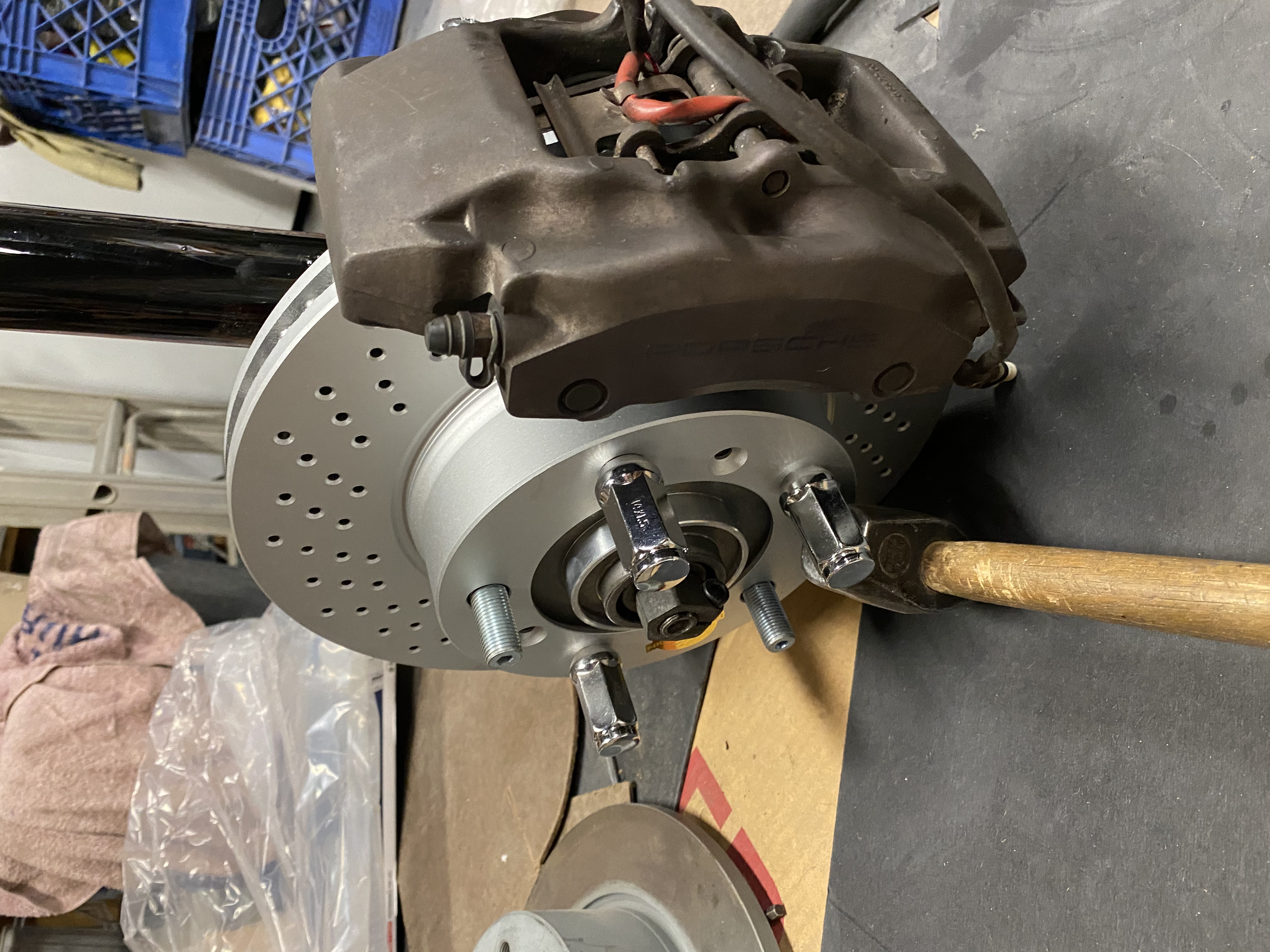

djway
I had to have the matching rear rotor/caliper combination.
When URO announced the 5x130 rear hub a bolt on rear vented 5x130 brake became a possibility. These are redrilled hubs but the URO part will solve that issue.
Years of long nights googling my brains out but I did it.
djway
Da hub.

UROpartsman
Hi guys, it's part number 914 331 605 5 LUG; five-lug, 37-spline, 911-wheel rear conversion hub for 914-4.
The hubs are now in stock in our Southern California warehouse, and available to retailers that offer URO Parts.

does this require a different bearing than we normally use on a 914 or 914/6 hub? @UROpartsman
UROpartsman
QUOTE(DRPHIL914 @ Jan 12 2021, 10:28 AM) *
The conversion hub takes a standard 914 bearing, the only decision that needs to be made is what stud length you'd like to install in the hub. We considered providing the hubs with pre-installed studs (as a bonus), but given the variety of lengths builders use, it seemed best for everyone to just leave the holes empty and ready for the stud of your choice.
We'll email Sierra Madre and Auto Atlanta to get the hubs added to their catalogs, these were just announced so they don't have them available yet.
