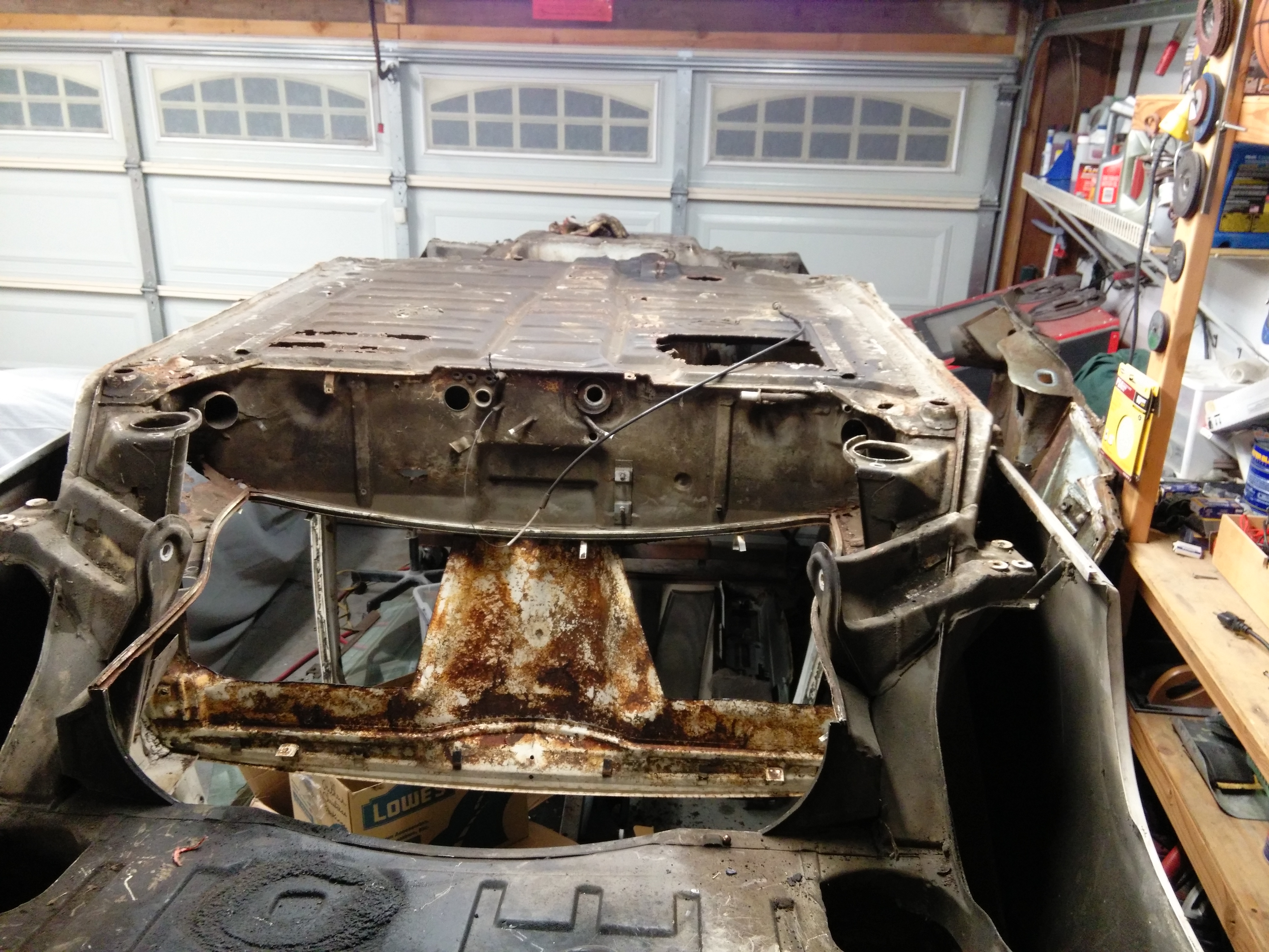

And so it begins.
I am starting to bring back a 75 that was sitting in a field since around 92. A little damage on the passenger side that only took a short time to rough out.
I modified a couple of old engine stands so I could fully rotate the car.
Most of the damage is the floor and back firewall from a loose rear window. I have not found any rust in the longs, YET.
I just finished a 4 year project restoring a 59 Karmann Ghia. It was my first restoration.
I have not decided where to go with this car yet. I originally wanted to recreate the last 914 I had in the early 90s but we will see where it goes.Attached Image

jmill   Just make sure to brace the door gaps if you haven...   Jan 9 2017, 07:07 PM
djway   The doors are braced and I will replaces sections ...   Jan 9 2017, 07:25 PM
