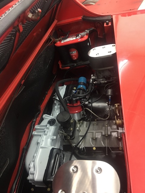

Shot of the engine, but I think this is before the Mallory was swapped for a 123Ignition electronic ignition system:

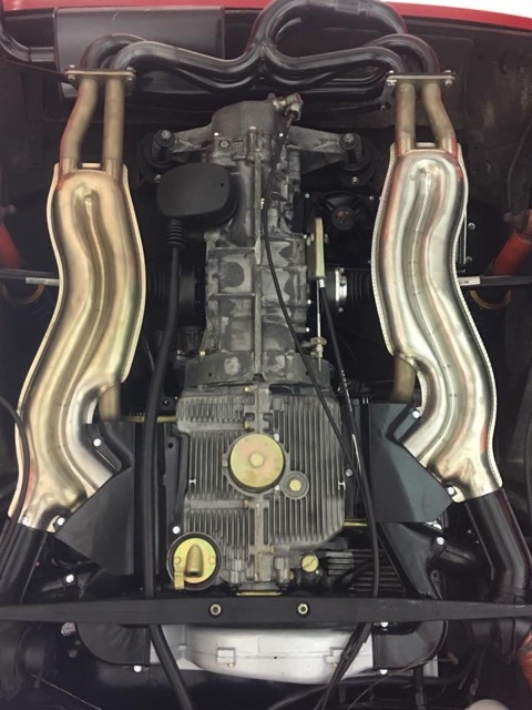

And a shot from down under:
