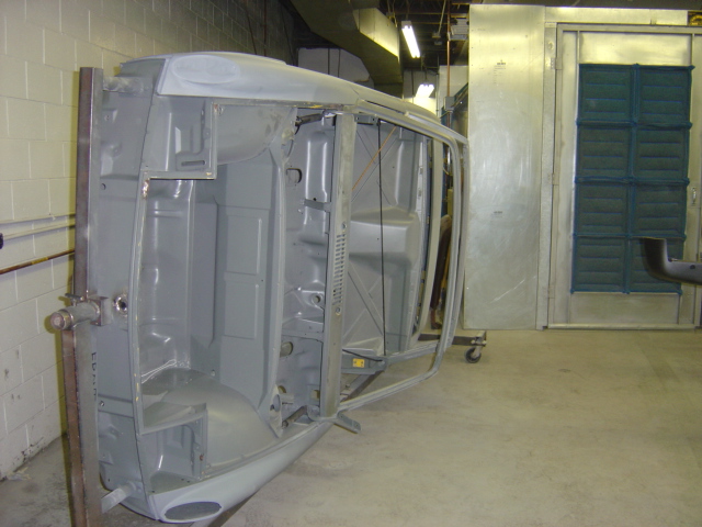

William..how tall are the uprights on your rotissirie?
william harris
post May 1 2005, 01:55 PM
914 Restorer
Posts: 1,459
Joined: 9-January 04
From: Hamilton, MA
Member No.: 1,539
Let see if this picture helps.
