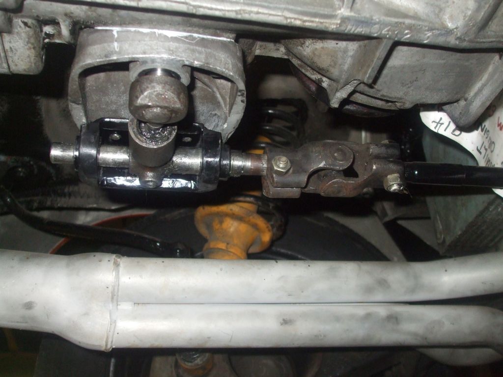

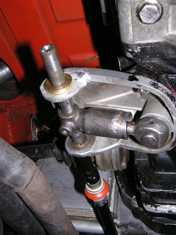

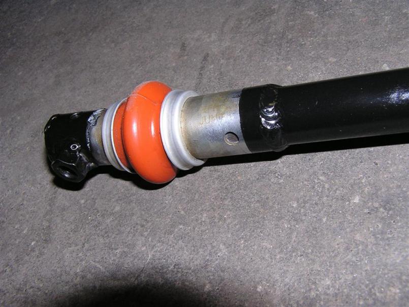

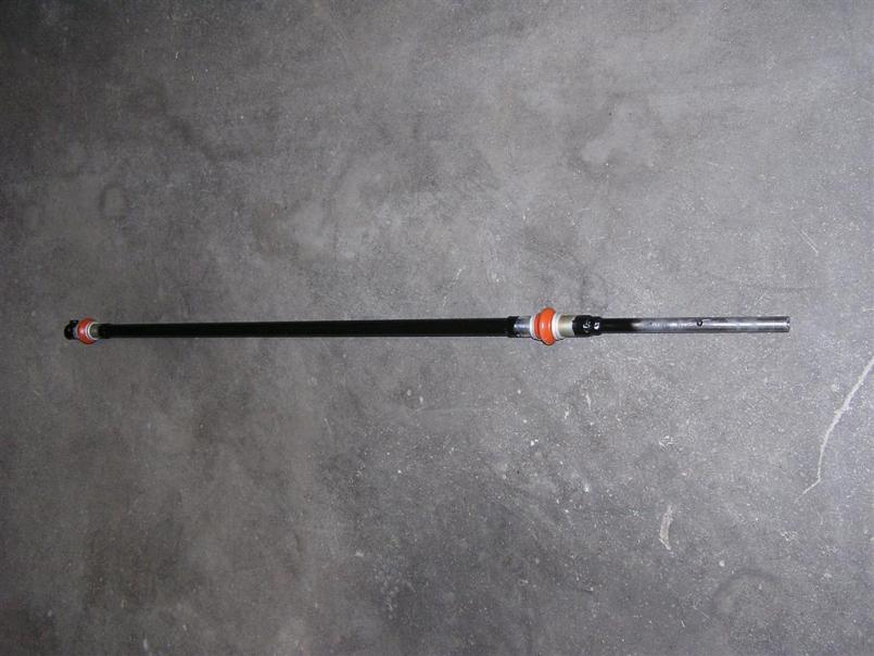

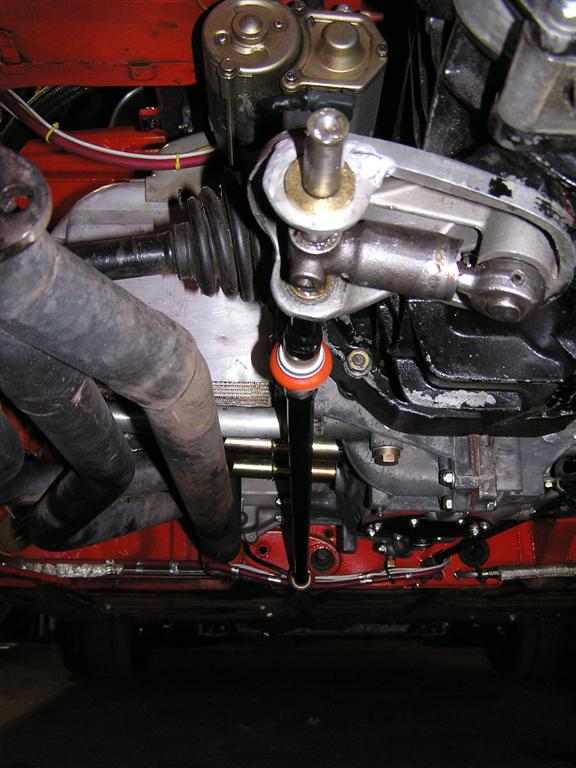

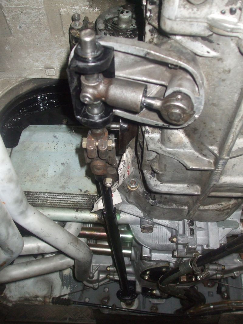

but I use a pair of universal joints, 360degree couplers on my custom shift linkage
I've got a few more tricks incorporated into mine too:
dual rear bushings on the console
a custom cup bearing holder
a custom shifter
and a straight chromoly rod
brass bushings on the rear
and a special delrin firewall bushing
its the best shifting 914 I've ever driven in 30+years of them.

here are some:

I like the shift linkage that Brant has put together. Very neat. I need to learn to weld. (IMG:style_emoticons/default/welder.gif)

Thanks Brant. That looks great. (IMG:style_emoticons/default/smilie_pokal.gif) I will most likely go a similar route.

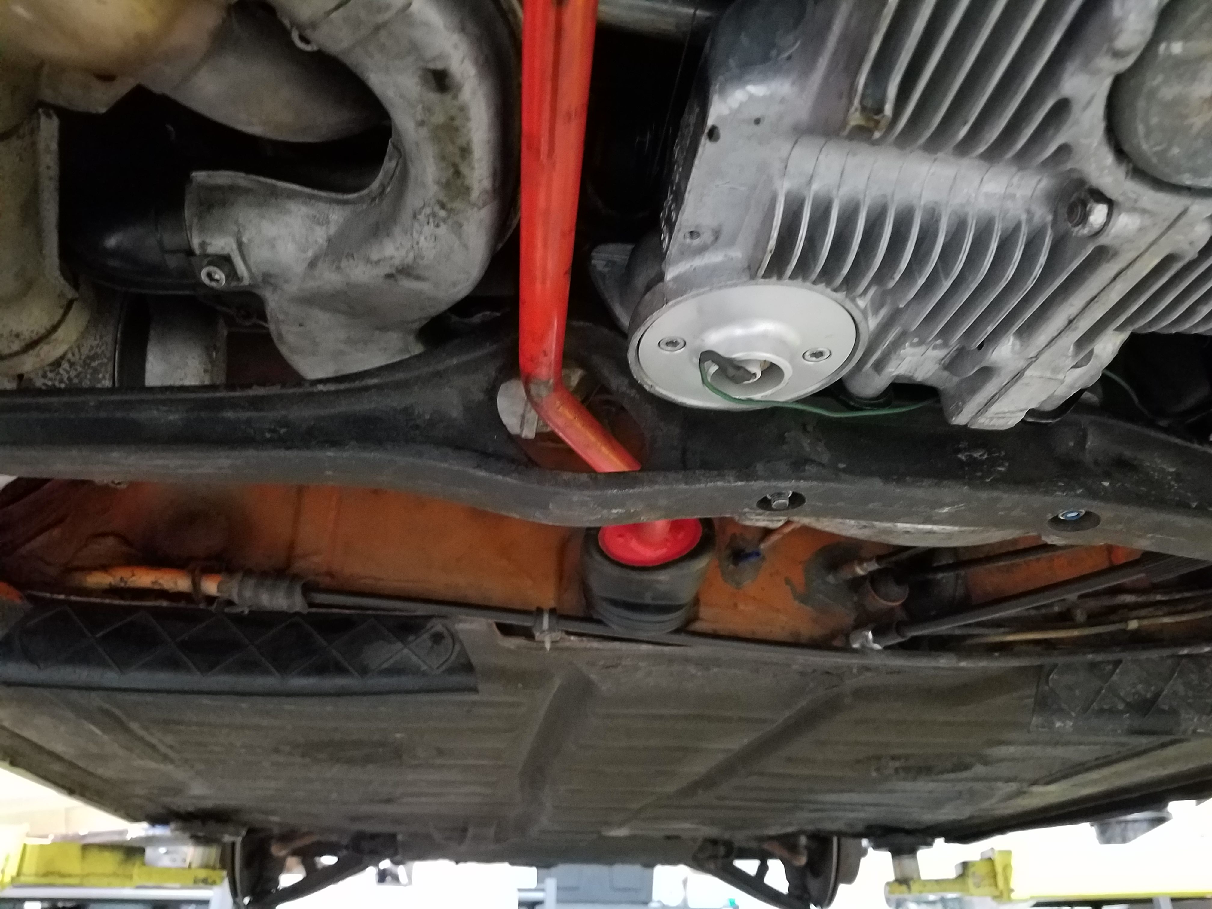

Mark Henry
post Jan 31 2017, 04:38 PM
that's what I do!
Posts: 20,065
Joined: 27-December 02
From: Port Hope, Ontario
Member No.: 26

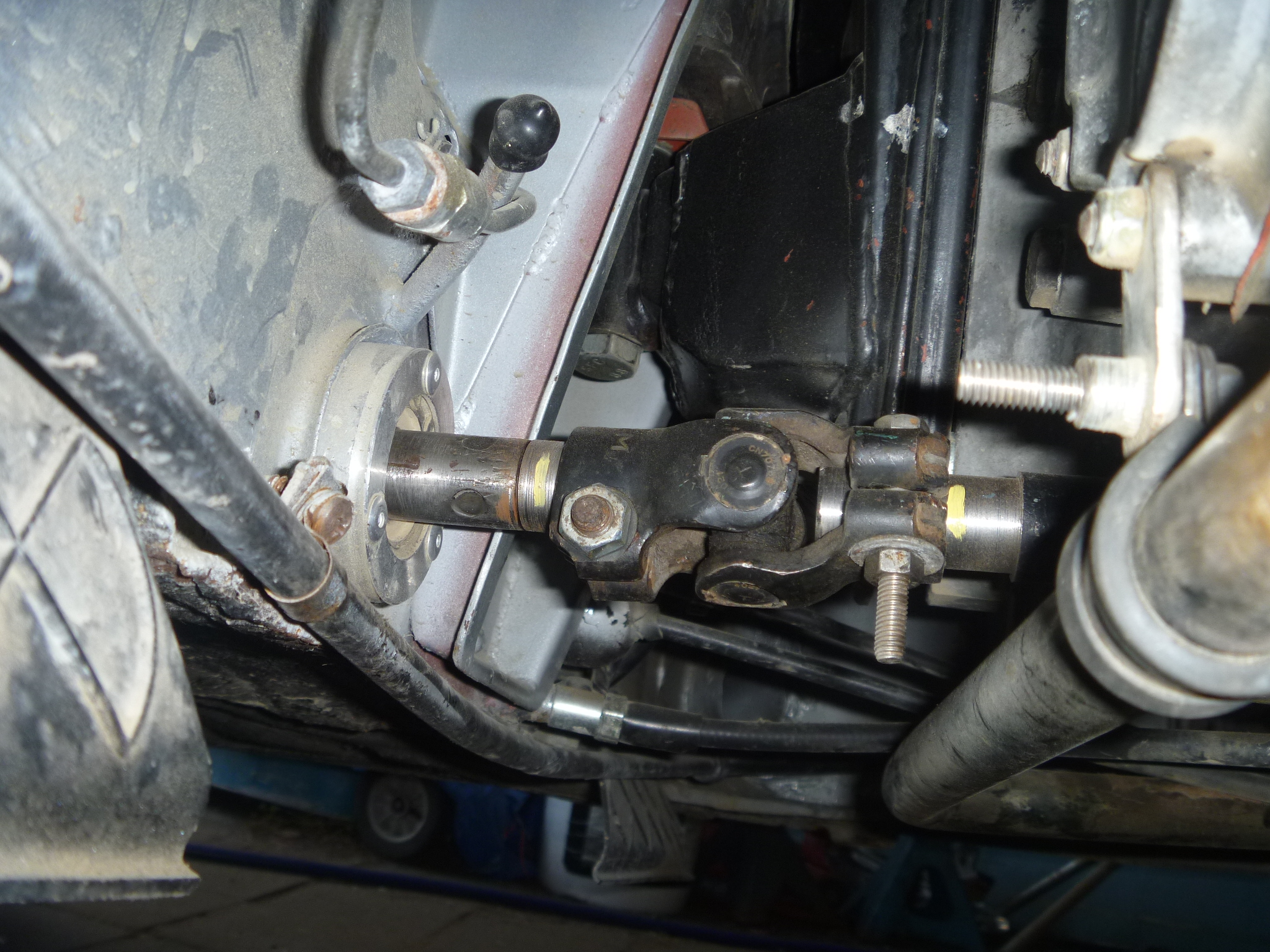

My linkage mod (IMG:style_emoticons/default/smile.gif)

Mine was crap till I added front 2 way uni-joint,plan to add rear one also,talked to Chris but he won't sell the double bush console on its own so will fab my own one.
Mark Henry
post Feb 1 2017, 06:59 AM
that's what I do!
Posts: 20,065
Member No.: 26
QUOTE(porschetub @ Feb 1 2017, 03:28 AM) *
I made my own bolt on double bush console as well, came out good, not a big deal but just for a boot solution I should have made the shaft about an inch longer at the U-joint.
The bolt on console is great for the bolt on crowd, but the next one for my sons 914 I'm just going to TIG weld heavy ears on like Brant has done.
