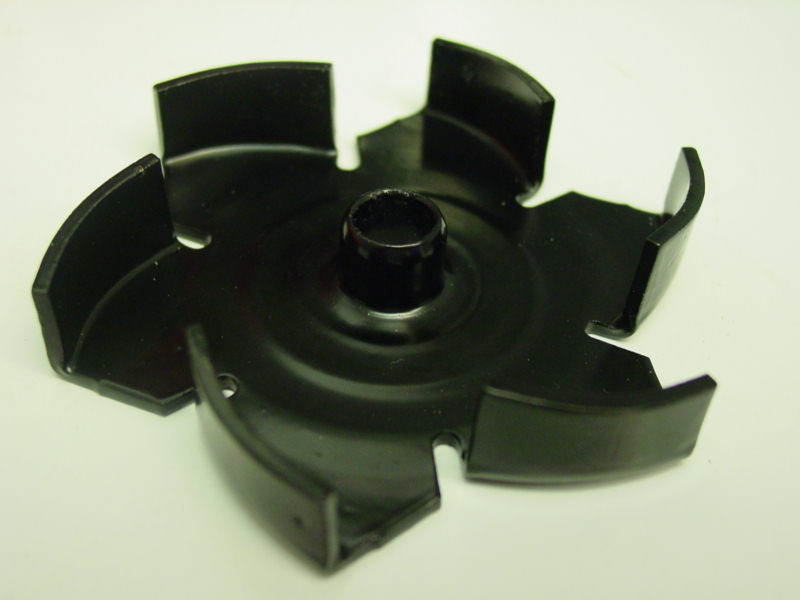

Here's the impeller:
Attached image(s) ![]() |
