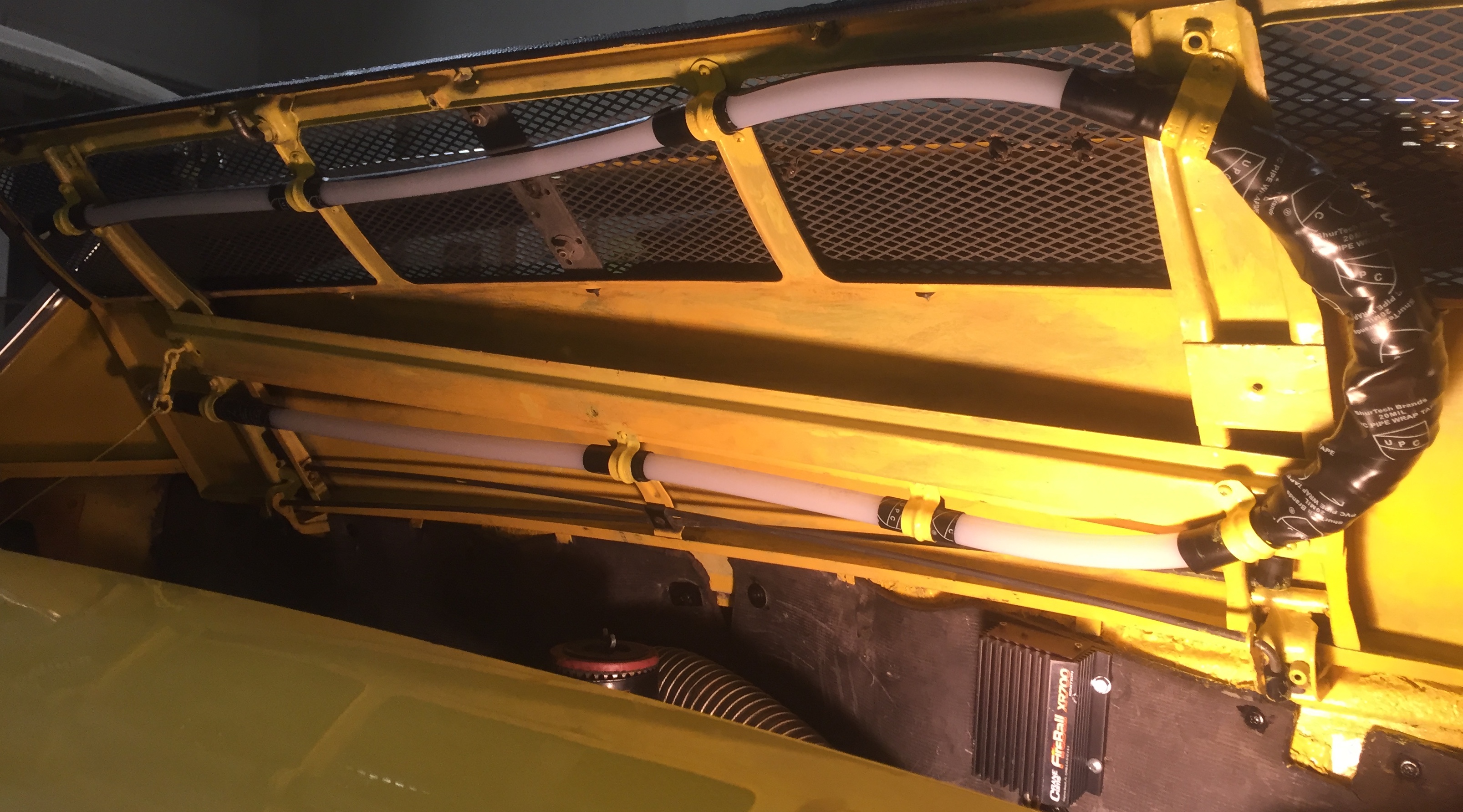

Simple idea. I installed a steel cable from a screw eye in the engine bay to a screw eye on the engine lid. I put a snap on one end of the cable just in case I have to move it to work on anything in the engine bay. The cable is just long enough to allow full opening of the engine lid but no more. I can pop the engine lid from in the cabin and I no longer have to hold my hand on the lid to keep it from opening too hard and bending or breaking the hinges. Works great!

Great idea (IMG:style_emoticons/default/smile.gif) What is the round thing mounted to the Bottom of the engine lid ?

Fire suppression. Forgot the name. There is a thread or two on here.

Blazecut Fire Suppression

Yep, Blazecut Fire Suppression system, cheap fire insurance. I supported the tightly curved area with a split electrical pvc pipe curve to keep it from kinking there. Here's a pic of it installed.
