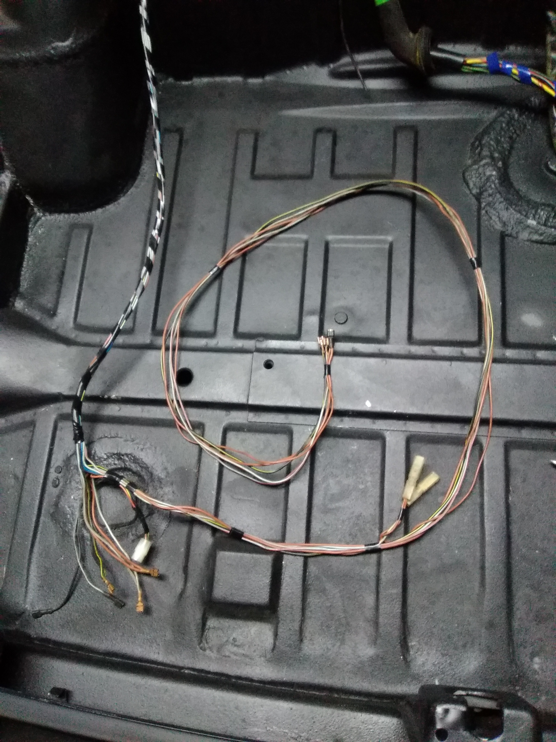

My harness had a short and I had melted wires and poor repairs all wrapped heavely in electrical tape.
Now I am trying to fix it.
