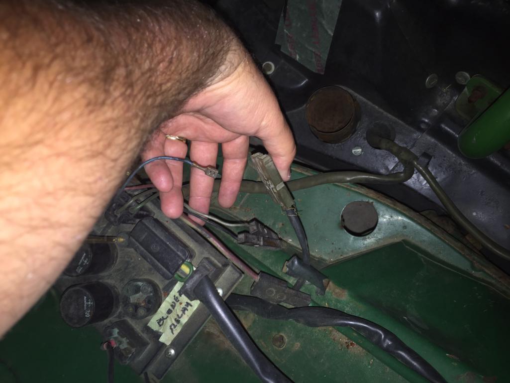

I have extra wires coming off my voltage regulator. And my voltage light is lit on my dash. Looks like I'm supposed to plug the two square male leads (touching my middle finger) into the dual square female lead (touching my thumb), but that could be a terrible idea. Also, what's with the brown short lead?
Any guidance would be appreciated.

brown, a ground?

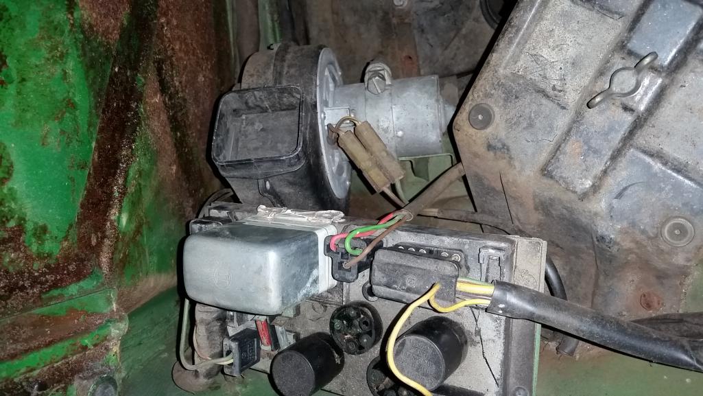

Thanks. I think this tells me that these are either extra wires, or they used to run to a blower motor that I don't have. What's funny is this "brown" wire looks blue in the photos. Must be my old eyes.
One of the things that's giving me fits is I can't tell where my B+ tab is on my voltage regulator. Do you have to pull the cover off the regulator to get to it?

D+ is the red wire on the alternator. There is no B+.

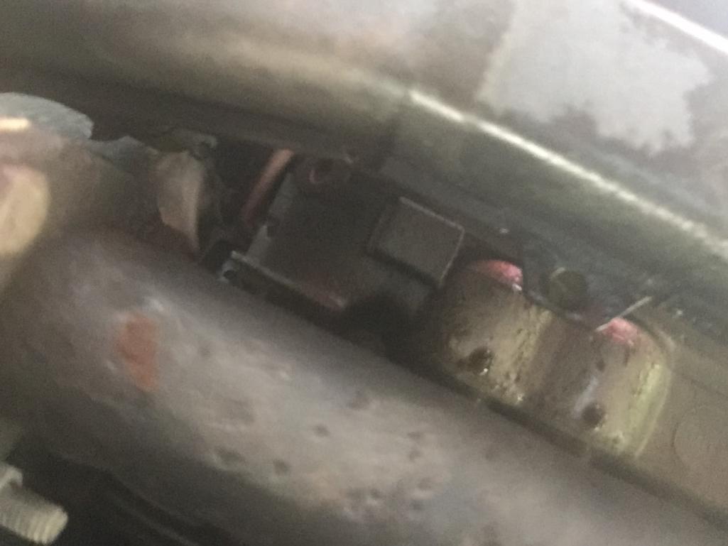

Next issue: My cloud of smoke oil leak is definitely push rod tubes. I was able to get my cell phone under there and saw the leak (see crappy picture below). It's also in the right place. Happily, it's only leaking from one side of the car, which cuts the job in half.
The $64,000 question is this: Do I need to remove the engine to swap out those push rod tube seals? I don't think I had to do it with my old bus, but it's tight in there!

You only have to pull the pushrod tubes halfway out of the head. Let them hang by their middle on the bore in the head, and you can replace the seals.
Actually, most can slide all the way out, but there are some where the suspension mount gets in the way. Those you just leave halfway out, no problem.
