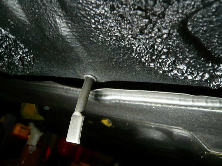

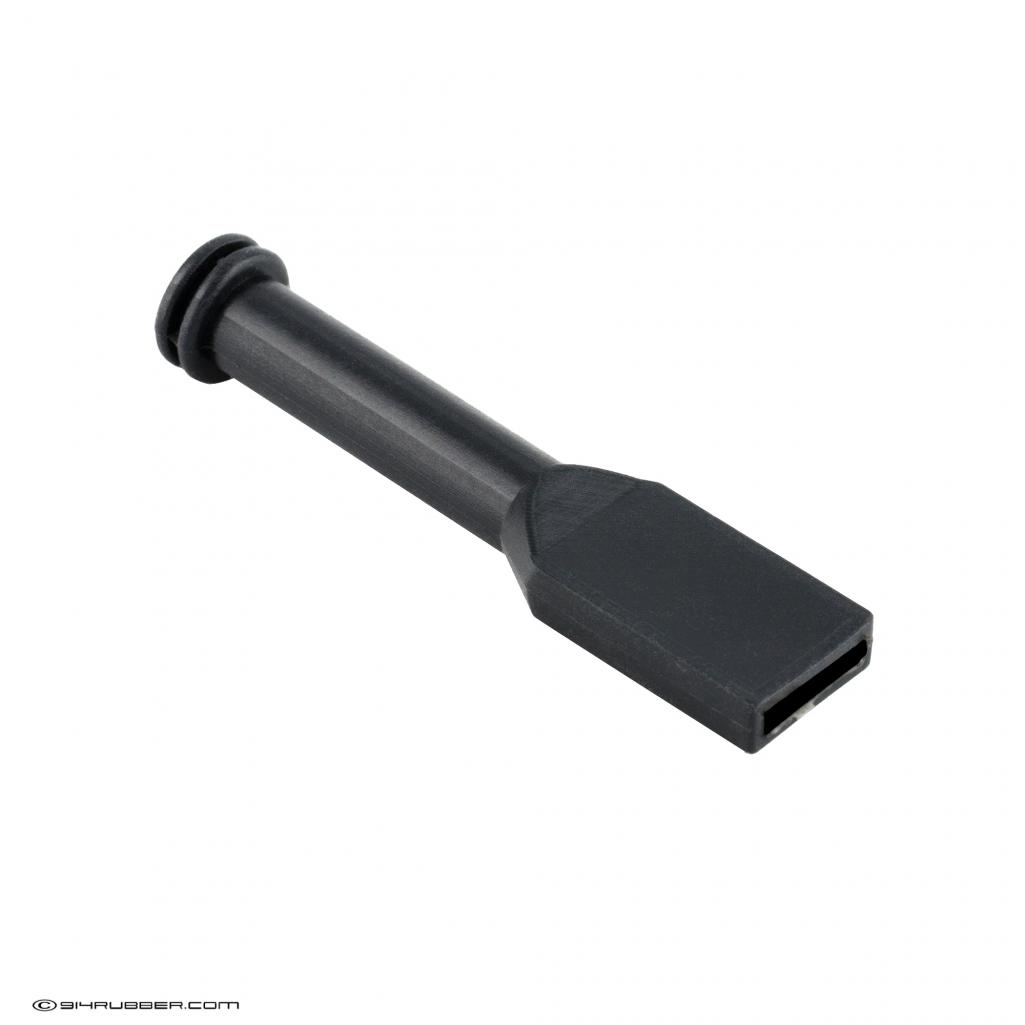

I wonder if the same type of rubber drain nipples they use in the front trunk were originally installed there? 914rubber sells repros (IMG:style_emoticons/default/cool_shades.gif)

Put a set of front trunk drain tubes in there. They will keep the water from splashing in. (IMG:style_emoticons/default/biggrin.gif)
http://shop.914rubber.com/Front-Trunk-Drai...m?categoryId=-1

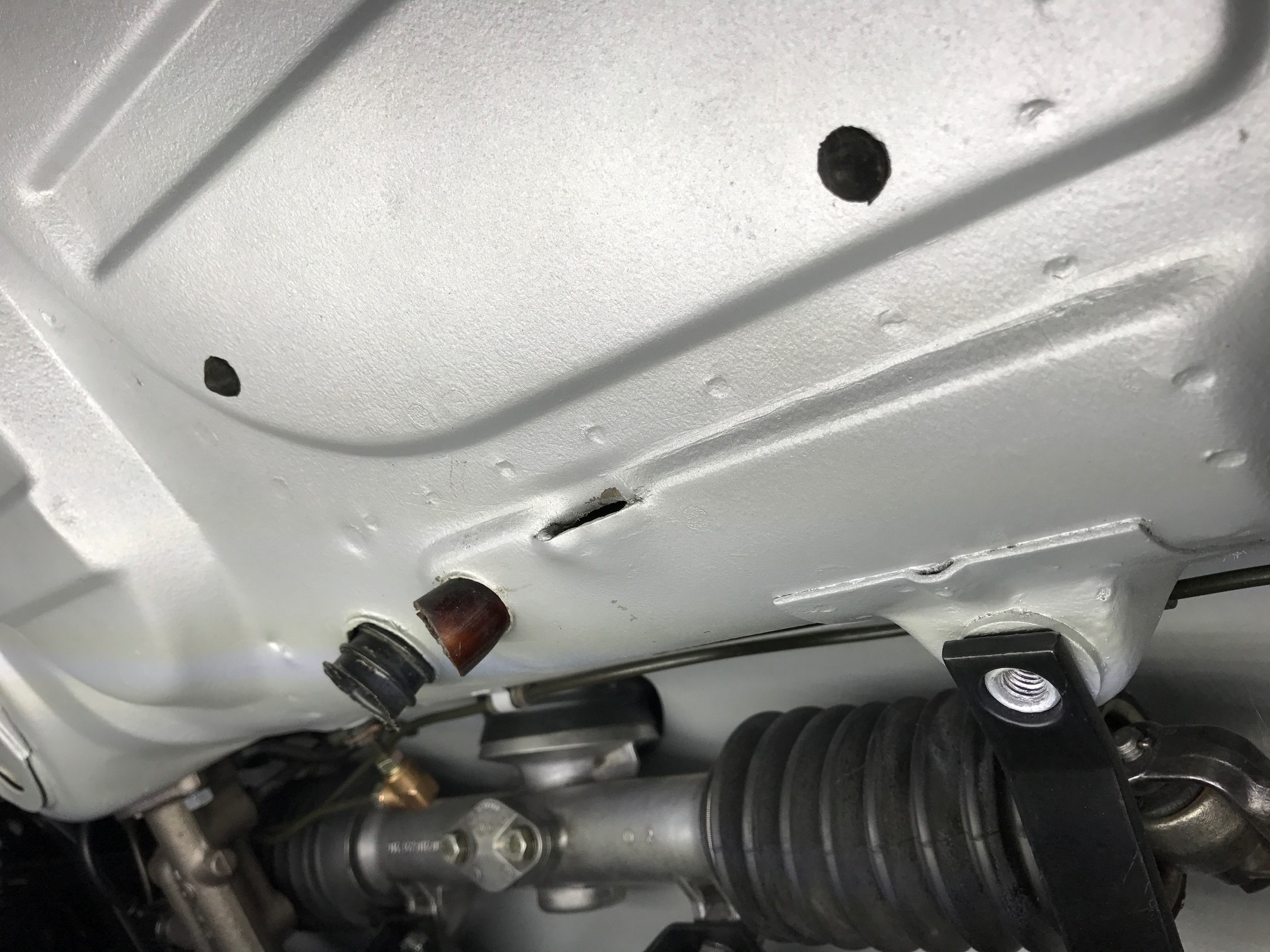

The holes are original, and use the flat rubber plug. The Plugs are covered by floor tar.

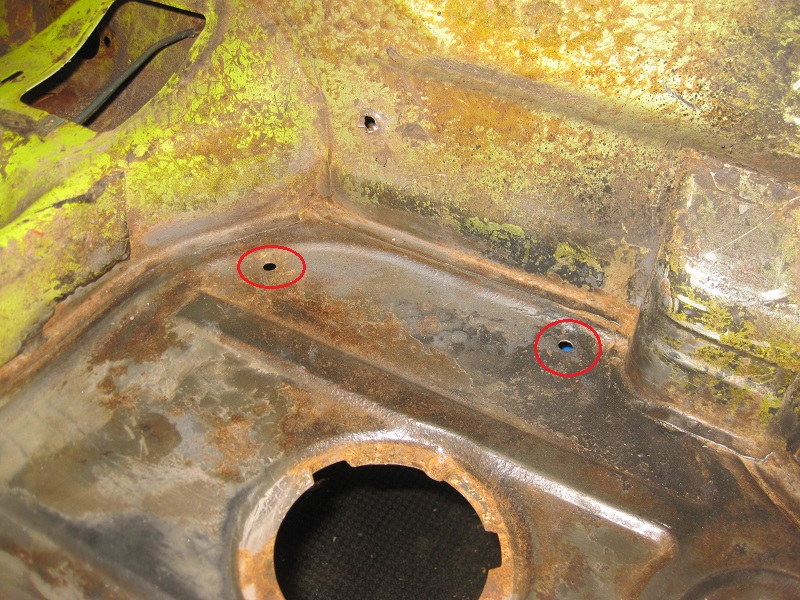

Great, thanks very much for providing the photo of what it should look like. Yours look new. Did you use one of Mike's plugs from somewhere else, make them,...?
Your picture solves another mystery about which I forgot to ask. The hole that appears to have been pried open (circled in your pic below)... my car looks exactly the same. I had planned to hammer and dolly that back to flat, but now it appears to be original (one less thing to do). Is that hole for drainage?

I'm pretty sure the red circled hole is for drainage in the gas tank area.

Makes sense. Looks to have been a bit of an after thought on Karmann's part.
