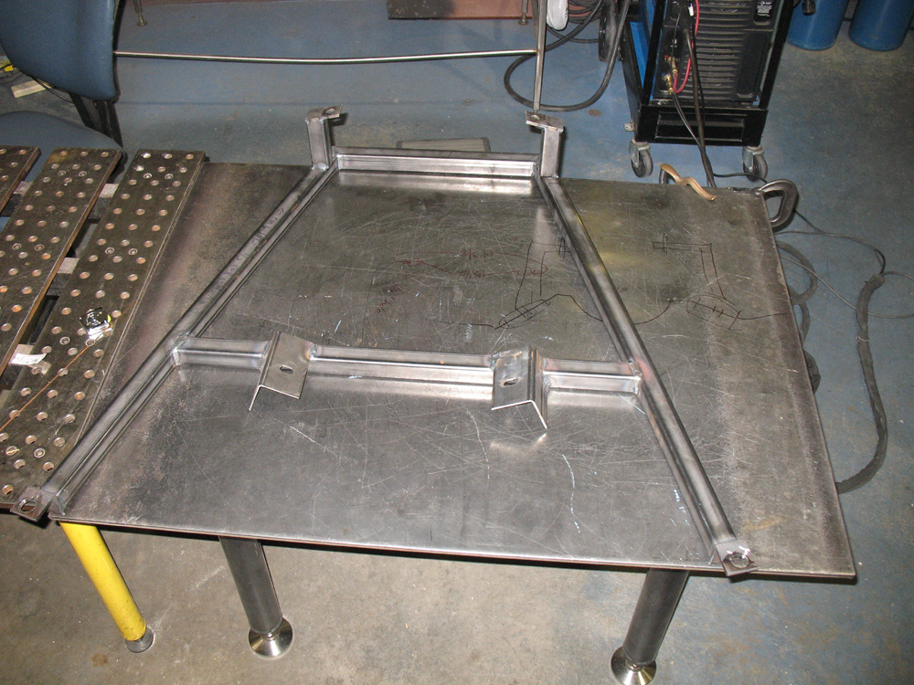

hum, should be still doable.
sample pic from under engine bay.

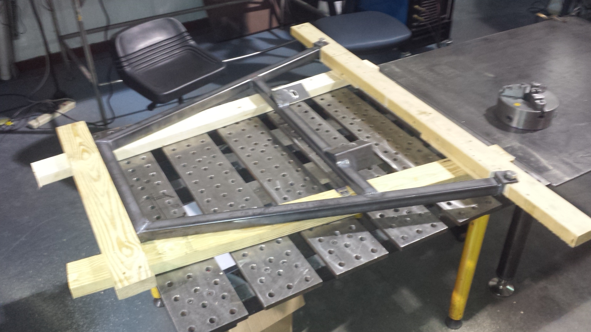

working on a jig.

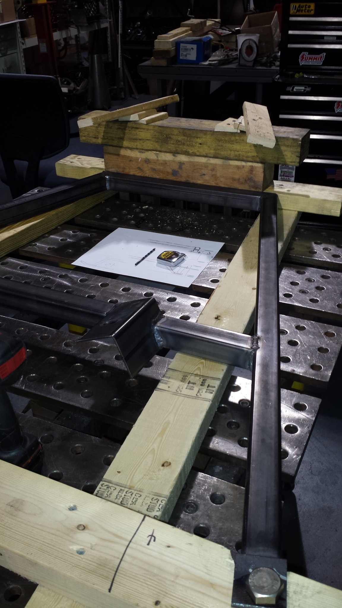

got wooden jig set up for get rear mount points in place.
once i get this tacked up, i will take over to rob's to see how it fits to car.
i did have to hog out the front mount holes about a 1/4 inch outward on both, this is because my cross bar was a bit short and i had to weld a decent gap which must have pulled the whole cradle tight inward.
