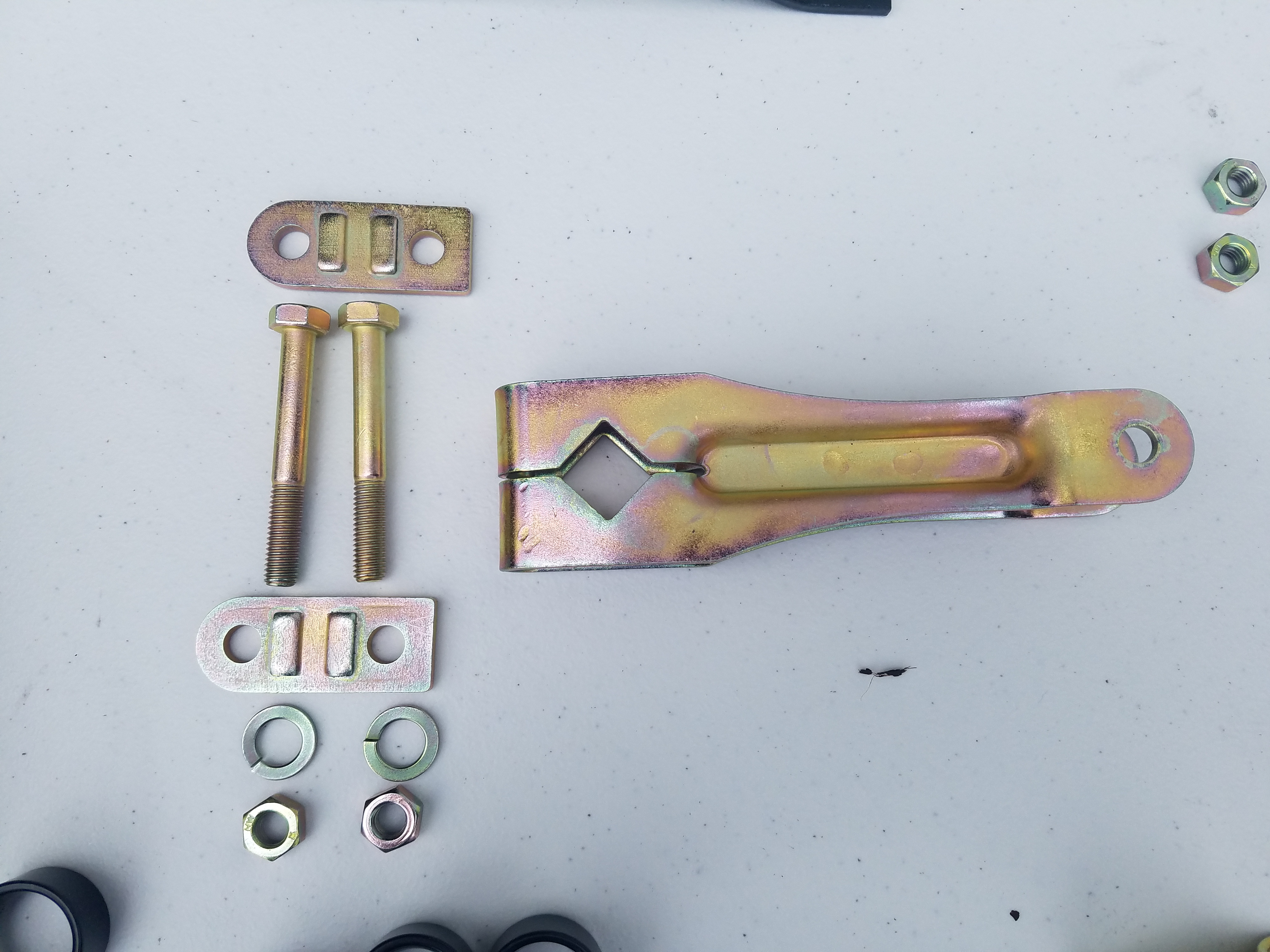

This is what the stock ones look like.

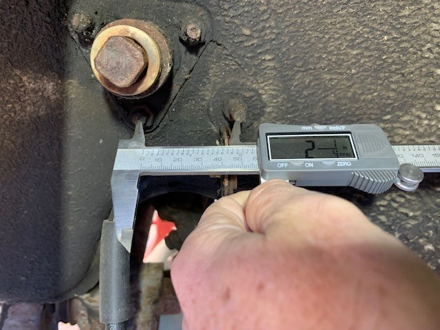

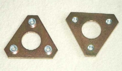

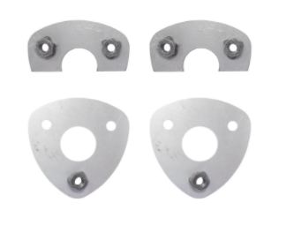

914LTD and PMB both sell front sway bar mounts.
Both configurations are substantial compared to the square u-bolts on this H&H it was said to be.
The H&H uses all standard hardware. The bolt spacing for the top u-bolt is 2-1/4 inch.
Can anyone provide the bolt spacing for the 914LTD version and the PMB version of the mounts?
I would like to see how they compare before choosing even with the welding involved.
Thanks,
Sean

QUOTE(seanpaulmc @ Jan 17 2022, 06:11 PM) *
Thanks,
Sean
Maybe someone can give you the exact measurements, but I think the bolt spacing is the same for both products. At least that's what Photoshop tells me when I resize them to match the hole for the bar and overlay one image over the other. Either way you will want to weld them in.

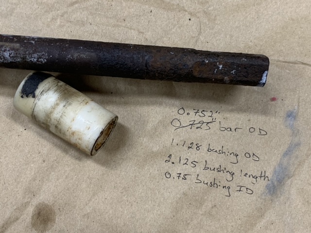

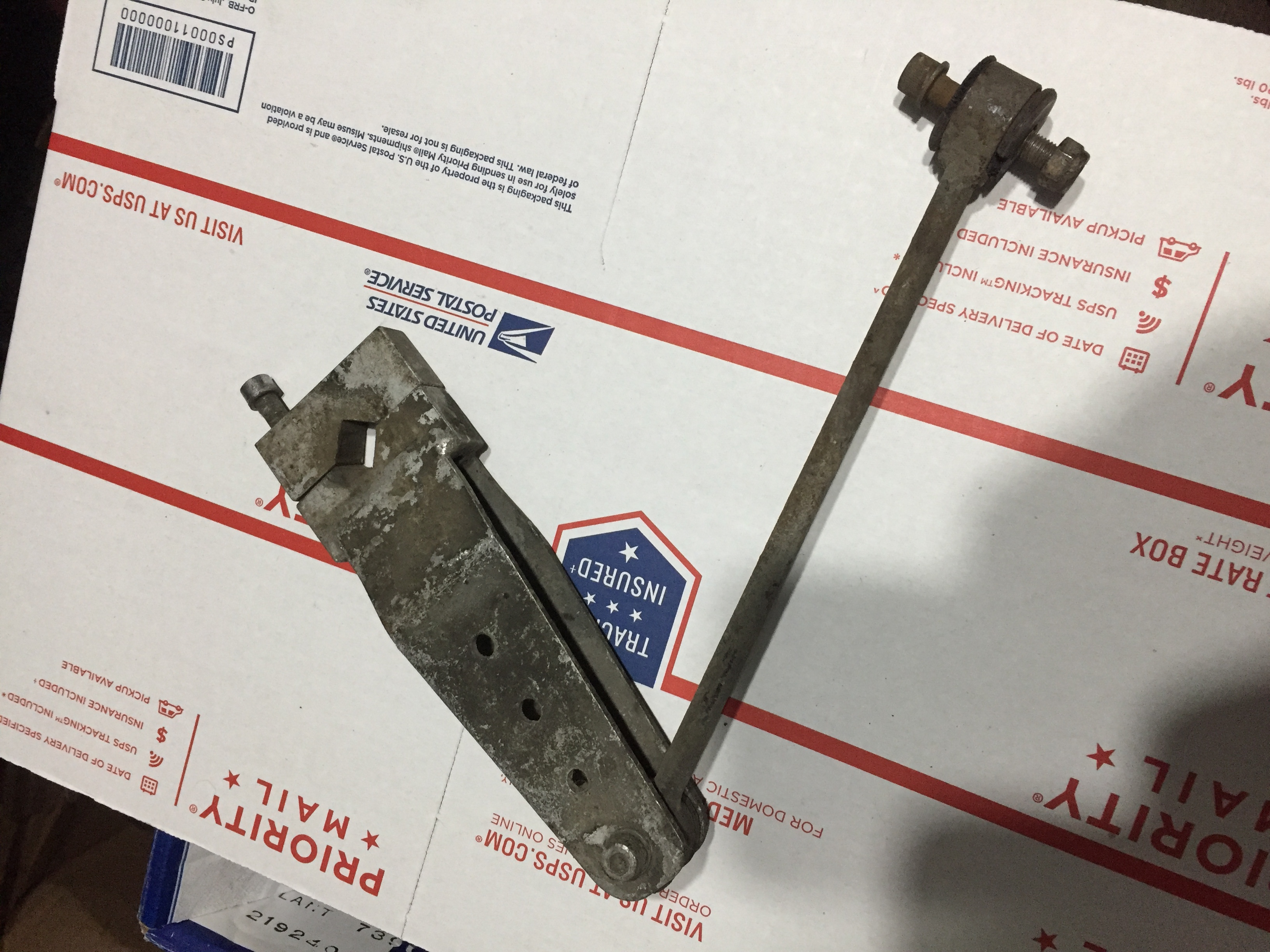

Here is a picture of the bar end and bushing.
Bushing is a type of plastic - delrin, polyethylene, other.
Does anyone know the material of the bushing used originally?
OEM bushings were rubber.
Is it recommended to keep same or find replacement rubber bushings that fit?
The bar is solid and heavy. 3/4 inch.
The pitting should clean up to reuse. Maybe powder coat.
Thanks,
Sean

That is an awful lot of front bar at 19mm. Stock was 15mm. I was wondering how big it was when I first saw the photos.
Like understeer? (IMG:style_emoticons/default/lol-2.gif) Somewhat joking since I have no idea what you have going on at the rear of the car. Unless you have some seriously stiff rear springs and a rear anti-roll bar (ARB) way bigger than stock inducing a lot of rear oversteer, that is a lot of front bar.
It's all about tuning to driver preference so if you like it, it's all good!
Given the nature of the bar, I don't think you'll find rubber bushings. Rubber would be too thin between the outer tube and the ARB to provide much isolation. Likewise rubber won't last long due to thin wall thickness available for the bushing.
If your Delron bushings are usable, stay with them. If they are shot a machine shop can turn up a set easily.
(IMG:style_emoticons/default/beerchug.gif) Cheers to @KevinW for having a part for you (IMG:style_emoticons/default/pray.gif) Kevin has helped me out numerous times. Great community!

As others here have stated, for sure an H&H bar. The one I had sold in the past had a similar bushing. Factory bar flares out at the ends.
Good luck with your project!

Member No.: 26,158
This might help. The aftermarket kits that work with the rest of the factory hardware will have the same spacing. I think it wise to finalize your bar selection before installing the mounts. I installed mine yesterday in fact (the 2-piece style). It really helps having all the bar bits to ensure everything will bolt up the ready.

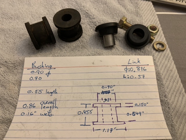

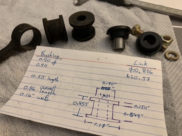

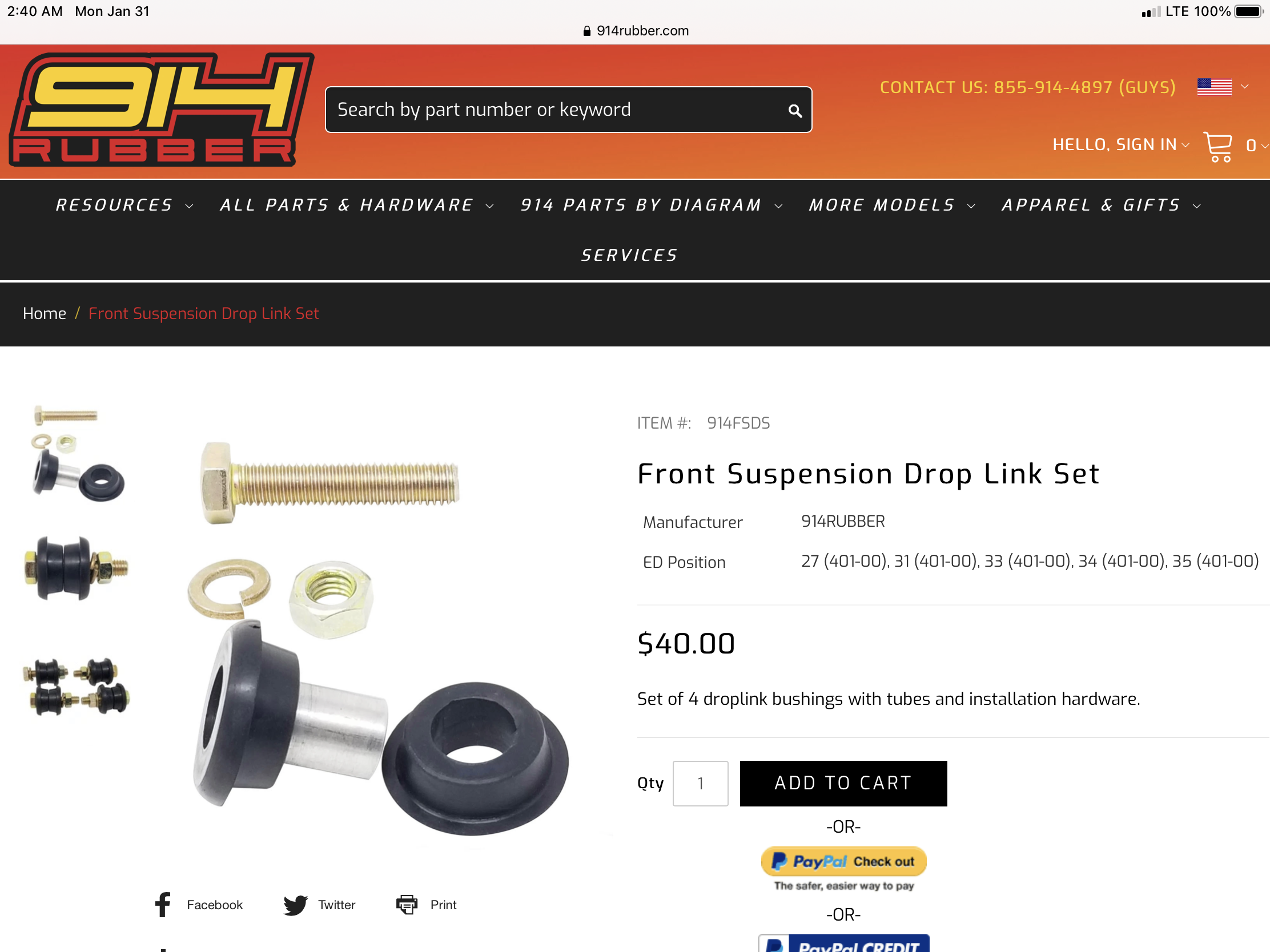

Where could I possibly source replacement rubber bushings for the drop links? They are not quite the same size as stock, a little bigger by comparison to the 914Rubber aftermarket split version.
I have not driven this car so I cannot comment on the feel or amount of presumable understeer. For now I’ll use what I have and get reassembled with a short term goal of making the car move under its own power. Tuning and improvements can come later.
Here is a comparison picture against the 914Rubber bushings.
By the way, these two may look decent in the picture the others are shot.
Thanks

Member No.: 3,348
Right here
https://914rubber.com/front-suspension-droplink-set-1

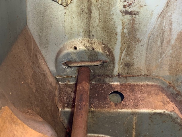

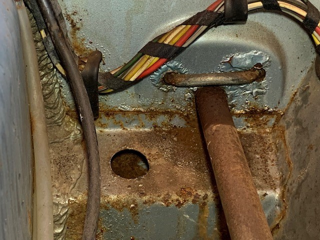

Good picture. Darn U bolts. The shelve directly under the bar hole needs to be clearensed to weld the inner plate correctly.
