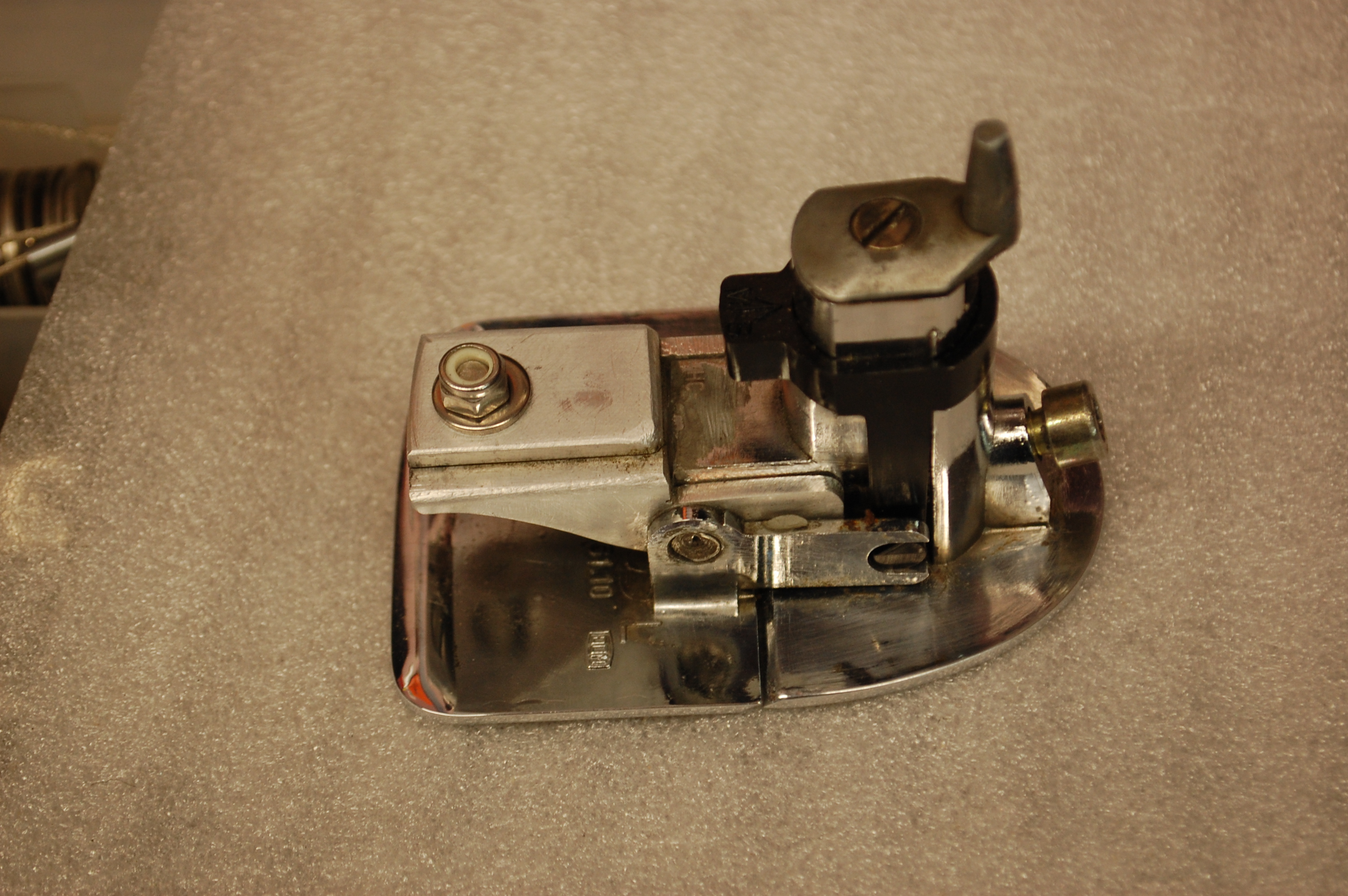

Okay, after cutting the nut loose and getting my door handle off, I've run into a few other issues.
1. I discovered a hairline crack indicated by the red arrow below. It doesn't go all the way through yet, but it is probably only a matter of time. Could I take this to a shop and have it brazed for reinforcement? Seems like that would work. Or what would solder do? I could do that myself. I'm just not sure how much reinforcement it would provide. I would love to hear opinions.
2. Just replacing the ruined stud with a nut and bolt isn't going to cut it for me. I think it would be fairly easy to drill out the stud, countersink the hole, and solder or JB Weld a flathead bolt in place. After rechroming the part, it should be fairly invisible. But before I do that, I'm looking at options to more closely replicate the original. It looks like the stud is a self-clinching threaded stud sandwiched between the tab and the small metal reinforcement that appears to either be soldered or brazed to the tab. I can't tell because it is plated over. Anyone know? If it is soldered, it should be easy to remove and solder red locktite in a new stud. But it would be nice to know before applying any heat.
3. Finally, anyone know where to find a replacement for the hinge pin that is peened on both ends? Seems like it should be a common hardware part but I'm not even sure what it would be called. Closest I've found is a "headless rivet" and those don't seem easy to source. Alternatively, I'm guessing a rivet with low profile head would do. What have other people used?
Thanks in advance for any tips and advice.

Just get another door handle. The crack it going to get you. These were made of pot metal, not repairable.

QUOTE(URY914 @ Jul 10 2017, 07:59 PM) *
QUOTE(arne @ Jul 10 2017, 04:54 PM) *
I believe that someone here on World can repair these handles.
That would be me. (IMG:style_emoticons/default/biggrin.gif)
Cut off the stud/nut. Remove the handle. Drill the out stud. Replace the stud with a bolt or counter sink a screw.
If (or when) you break the mounting tab off when doing this, send it to me and I'll replace the tab.
How the hell are you mending the pot metal?

QUOTE(jeffdon @ Jul 26 2017, 07:42 AM) *
I'm not mending the pot metal. I'm replacing it with aluminum angle that replaces the bushing.
