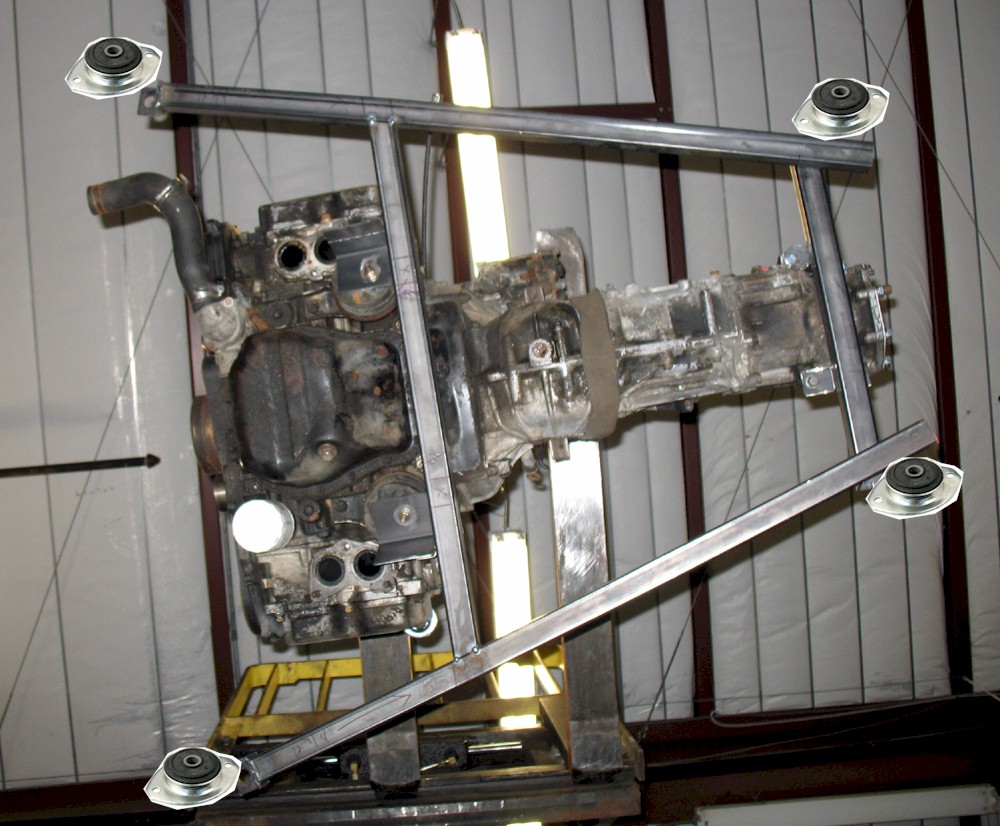

is there a difference in height or thickness from the 911 mount vs the 914 mount of this style?

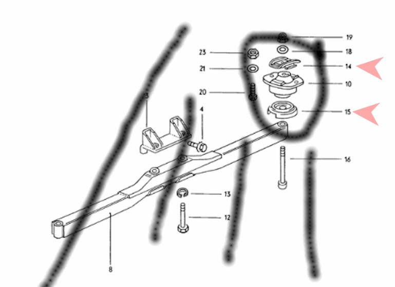

I just saw the mounts for sale on Pelican .
You will also need the cupped washer that goes over the top of the 911 mount as the OEM 914 part will not work so well.

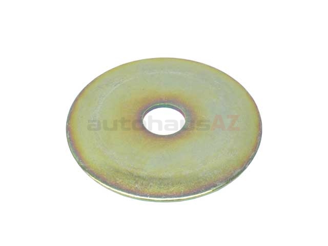

gms
post Jul 14 2017, 09:53 AM
Posts: 2,738
Joined: 12-March 04
From: Chicagoland
Member No.: 1,785
901-305-311-00
they look like this

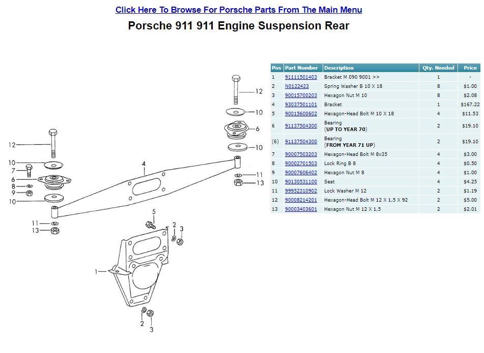

so it looks like 2ea of this washer for each mount is best, pn: 90130531100
are they big enough to hold engine off the floor if rubber mounts fails?
seems like all these metal washers, regardless of style, the mounts loses most of its flexibility (IMG:style_emoticons/default/idea.gif)
jim

Yes, those washers will work. However, you'll four of them, one above and one under each mount. The mounts are designed to work with those washers.
The mounts actually aren't supposed to have a lot of flexibility. Their primary purpose is to isolate vibration, without letting the engine/trans "float" around too much.

QUOTE(jimkelly @ Jul 14 2017, 12:48 PM) *
These mounts will be more firm and due to the design of the mount it would be near impossible for the washer to fall thru it.

my plan is to use one 911 mount at each of the four corners.
jim
