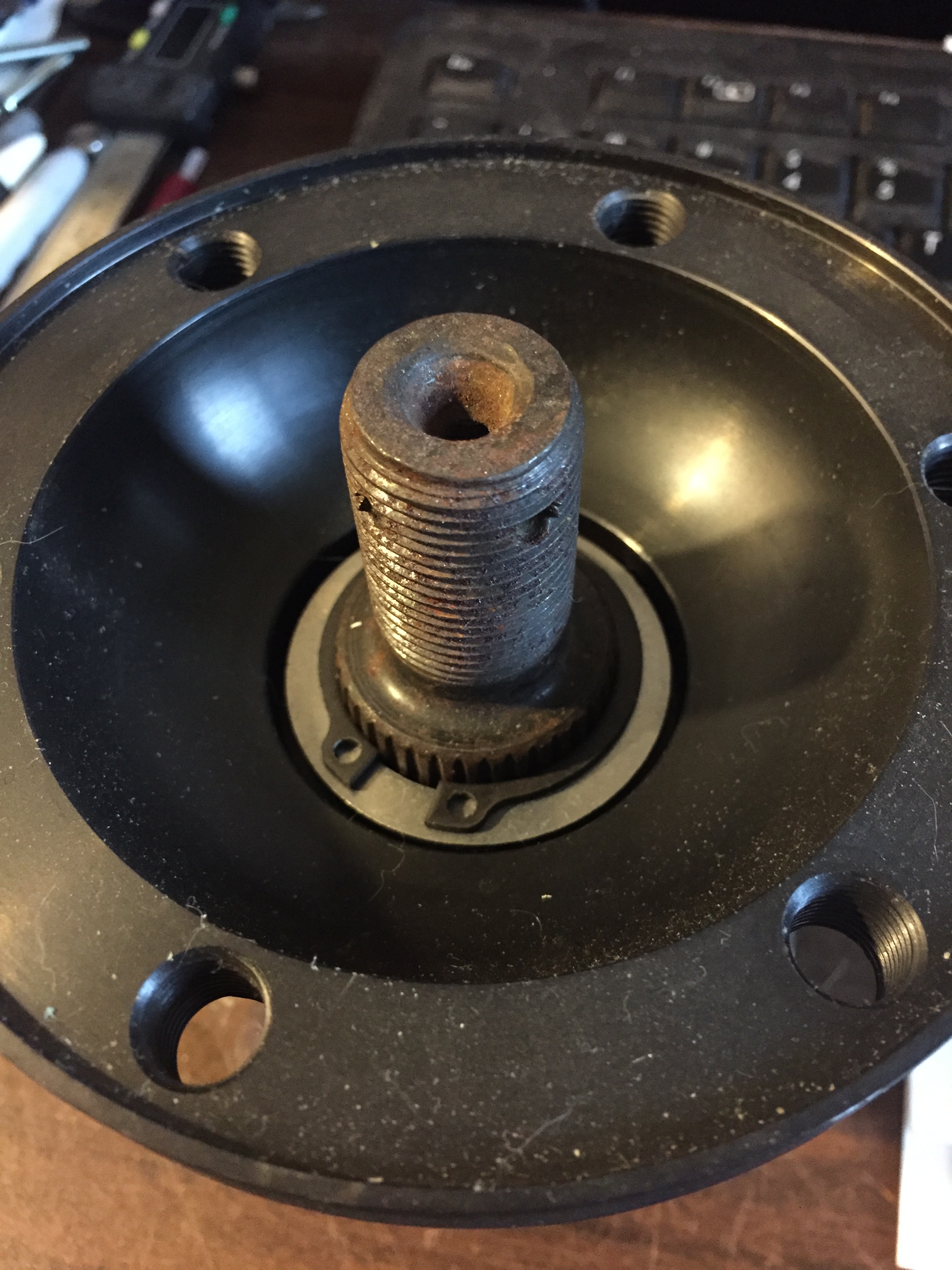

i'm thinking of using a second stub axle bolted to main stub axle and having the second splined to fit this vw splined flange that is type1 to type2/4 (924/944 100mm cv), for wheel side.
30mm 37 spline, ya doing something like this?

that is exactly what i was thinking (IMG:style_emoticons/default/smile.gif)
is yours a 108mm flange or 100mm?
my flange has a 26mm ID where the splines are.

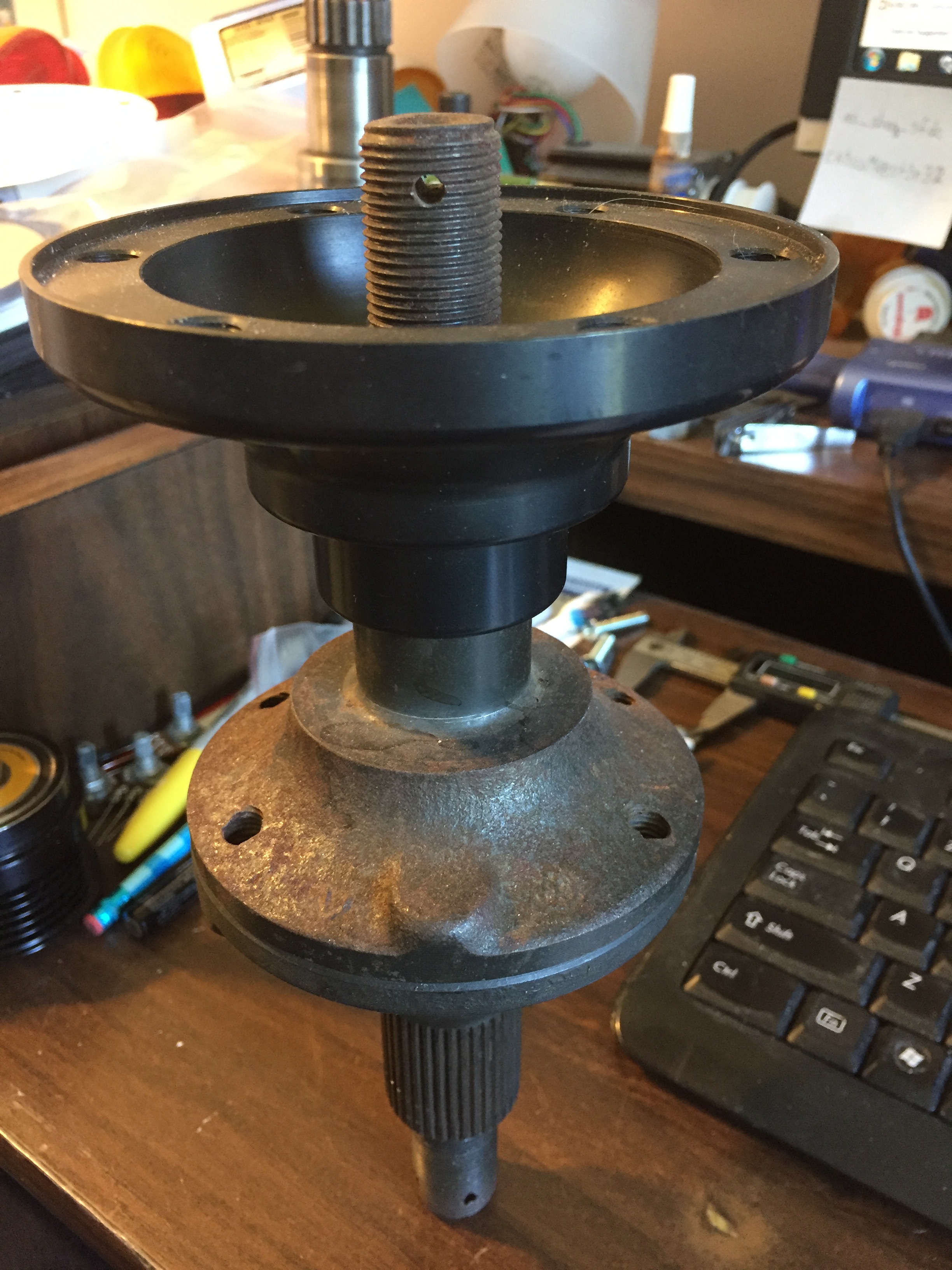

QUOTE(Phoenix-MN @ Jul 17 2017, 10:15 AM) *
108mm
A little different application but here's how I'm using one

my thought is that with everyone saying that when cutting and resplining a stock 914 axle to use with a suby cv at trans and 914 cv at wheel, that there is practically no margin for error on length, that two flanges and a 924 or 944 axle assy has got to be more forgiving, and stronger too.
are you bolting the two stub axles together or welding them together? is your flange attached using the splines or is your flange going to be welded to the innermost stub axle?
i am leaning towards welding it all together.
Phoenix-MN
post Jul 18 2017, 06:59 AM
Posts: 927
Joined: 23-January 04
From: ST. Bonifacius,MN
Member No.: 1,590
QUOTE(jimkelly @ Jul 17 2017, 12:59 PM) *
my plan is to bolt them together using the two 10mm roll pins, the flange will be attached using the splines with a washer and snap ring. I'll be cutting the threaded end of the stub axle off.
