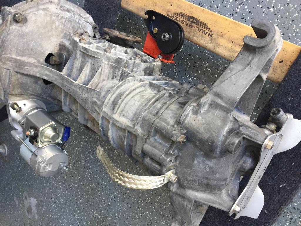

BTW, for a transmission ground strap, I picked up a standard starter cable like this one at my FLAPS. I think the one I picked up was either 2ga or 4ga 12 inches long. It was longer than the original so I looped it once.

post Aug 9 2017, 01:05 PM
Jerry
Posts: 7,370
Joined: 29-October 04
From: Allentown, PA
Member No.: 3,031
Here's a pic of the ground strap I'm using. I think it's 1 ft and 2ga.
