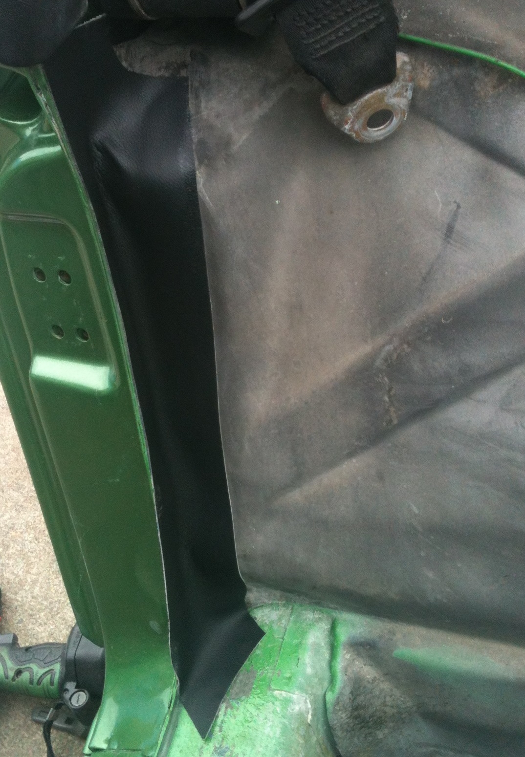

Here's another one
Matty900
post Aug 11 2017, 10:00 PM
Posts: 1,340
Joined: 21-February 15
From: Oregon
Member No.: 18,454
A customer sent me this photo. It was the 1st time he has seen it and had done 7 cars

Olympic 914
post Aug 12 2017, 06:50 AM
Posts: 1,795
Joined: 7-July 11
From: Pittsburgh PA
Member No.: 13,287
QUOTE(Matty900 @ Aug 12 2017, 12:00 AM) *
That is the picture I needed. Looks like this is where they go.
