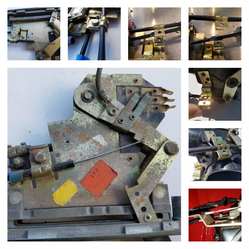

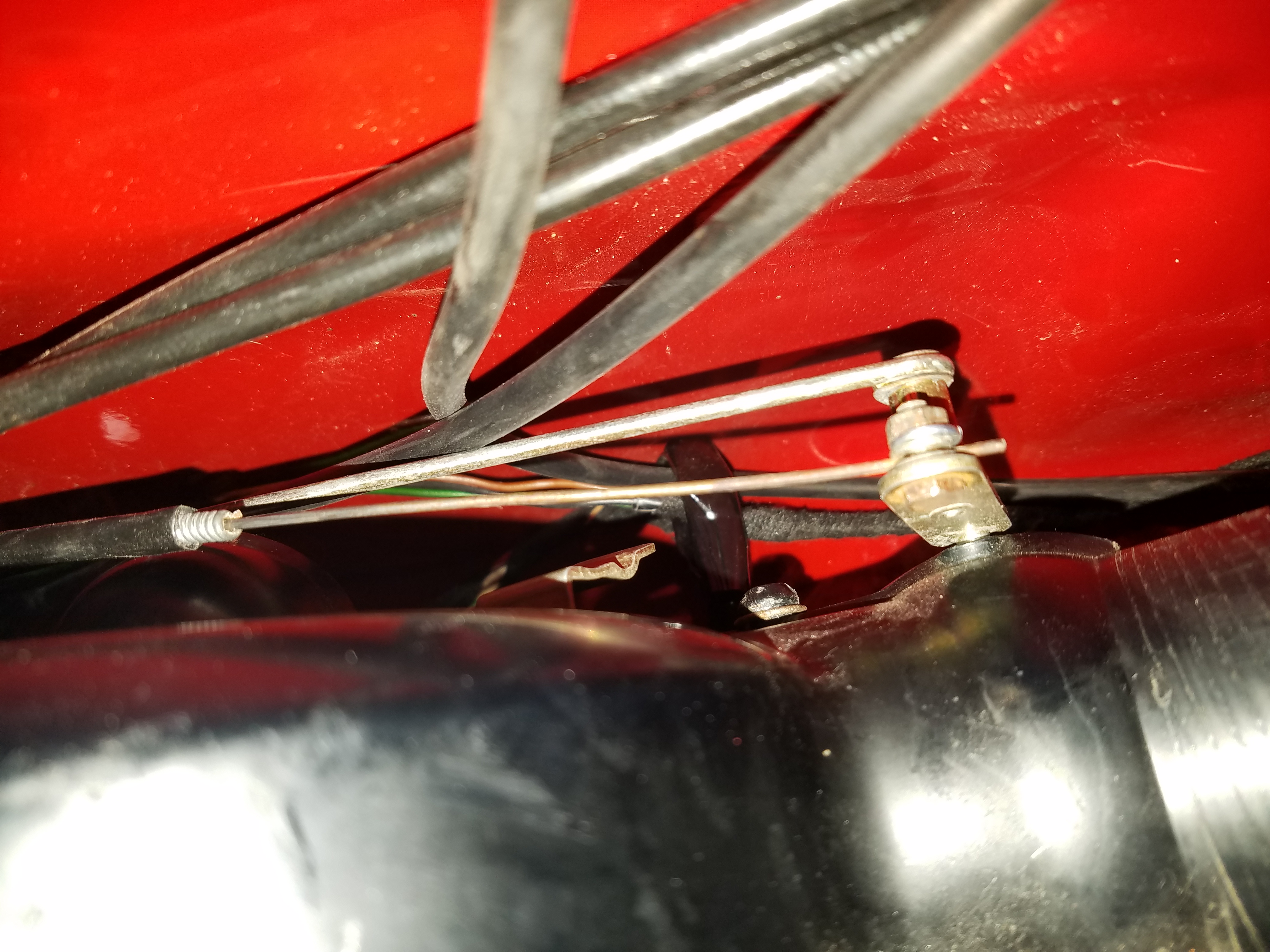

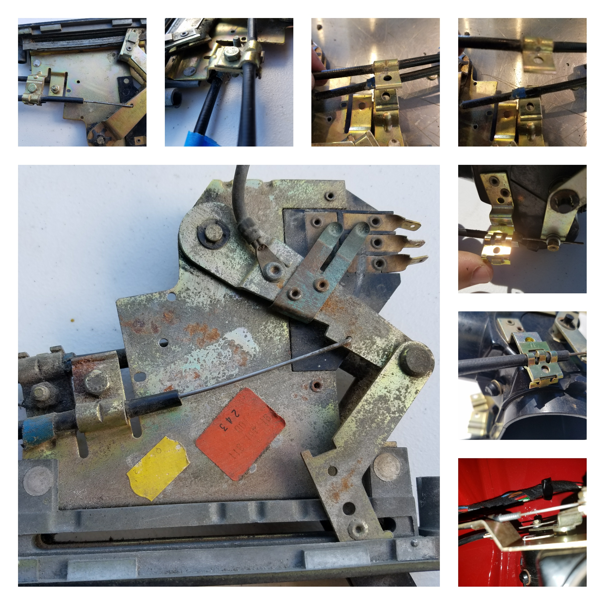

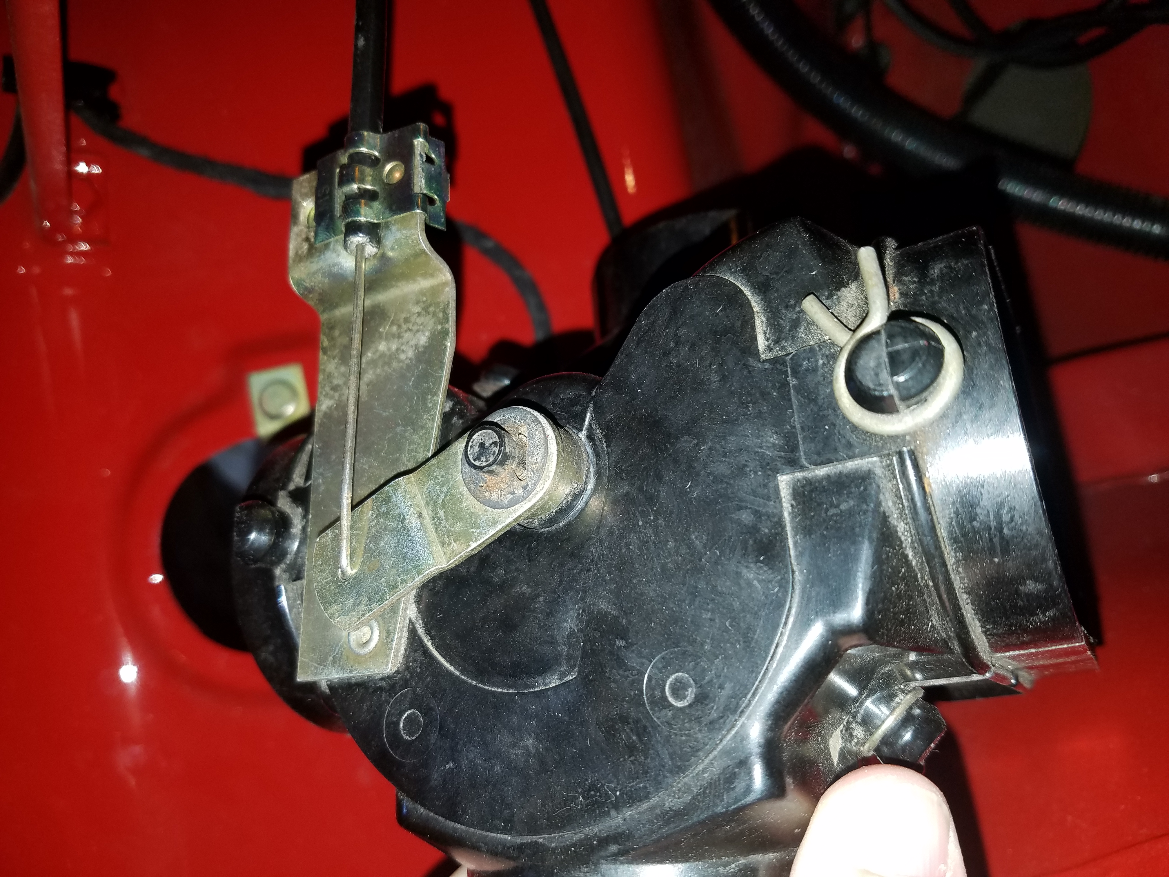

Unclip the wires from mixing boxes and blower housing

Here

Had a hard time uploading pictures for you so here's a collage of them

Clean all of your contacts and make sure your wires are intact
