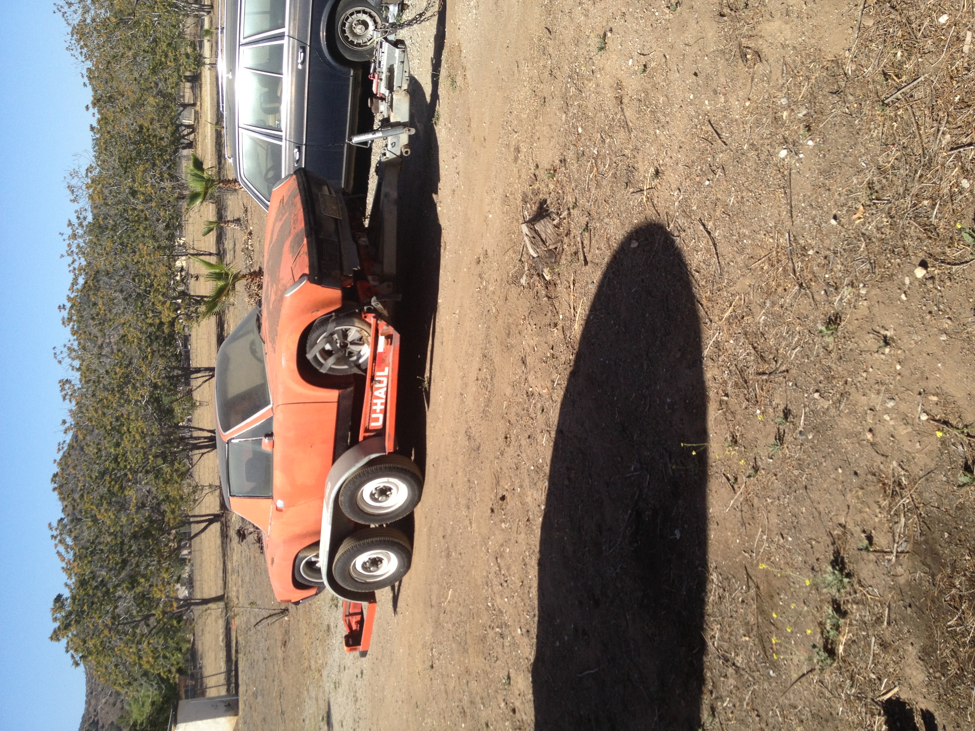

Here is the first pic of the car I could find.Attached Image
