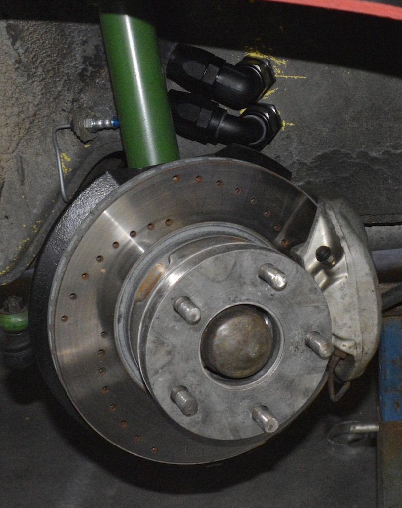

Liking it so far - but early days for me, only a few hundred miles on the car. I intend to track the car occasionally (track days, not wheel to wheel) once the engine has seen some more road miles. Brake feel is good now the pads are bedded in. Definitely need to address the M/C and rears to get a decent balance.
my set up is:
front: Boxster calipers, vented disks
rear: '88 Carrera ATE calipers + vented disks
e-brake: Tangerine racing cable adapters (uses 914 standard cables), '88 Carrera internals
M/C: 19mm
Prop valve: Wilwood
The vented rear disks are probably overkill but the GT's used them - so they look "period correct". I also like the fact you can run 15" rims without clearance issues ;-)

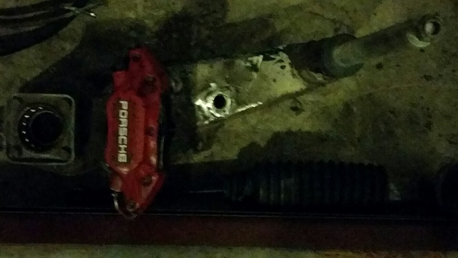

Test fitting the rears - already have the fronts dialed in. Still using the pressure limiting valve with a 19 mm master. Things should be interesting...
