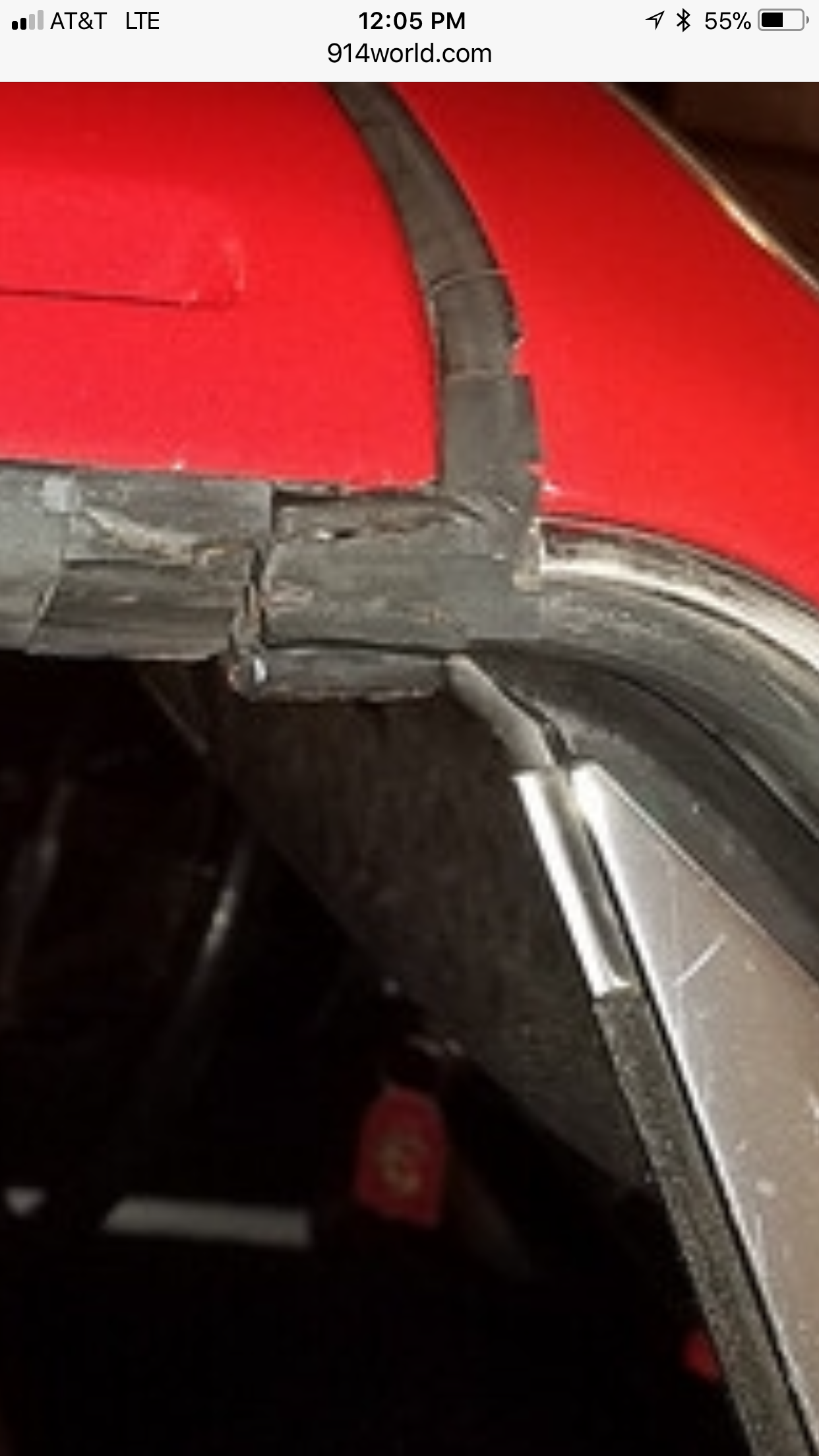

Here is an update of the fitment and what it looks like. Thoughts?
(IMG:http://www.914world.com/bbs2/uploads_offsite/farm5.staticflickr.com-18763-1504049595.1.jpg)
(IMG:http://www.914world.com/bbs2/uploads_offsite/farm5.staticflickr.com-18763-1504049596.2.jpg)
(IMG:http://www.914world.com/bbs2/uploads_offsite/farm5.staticflickr.com-18763-1504049596.3.jpg)
(IMG:http://www.914world.com/bbs2/uploads_offsite/farm5.staticflickr.com-18763-1504049596.4.jpg)
(IMG:http://www.914world.com/bbs2/uploads_offsite/farm5.staticflickr.com-18763-1504049596.5.jpg)
(IMG:http://www.914world.com/bbs2/uploads_offsite/farm5.staticflickr.com-18763-1504049597.6.jpg)

Update - I think the electrical issue I am facing has to do with the wiper/fresh air relay. I am sourcing another but that would explain why it works sometimes and a simple tap on the fuse panel kick starts it.
Any comments about my top fitment?

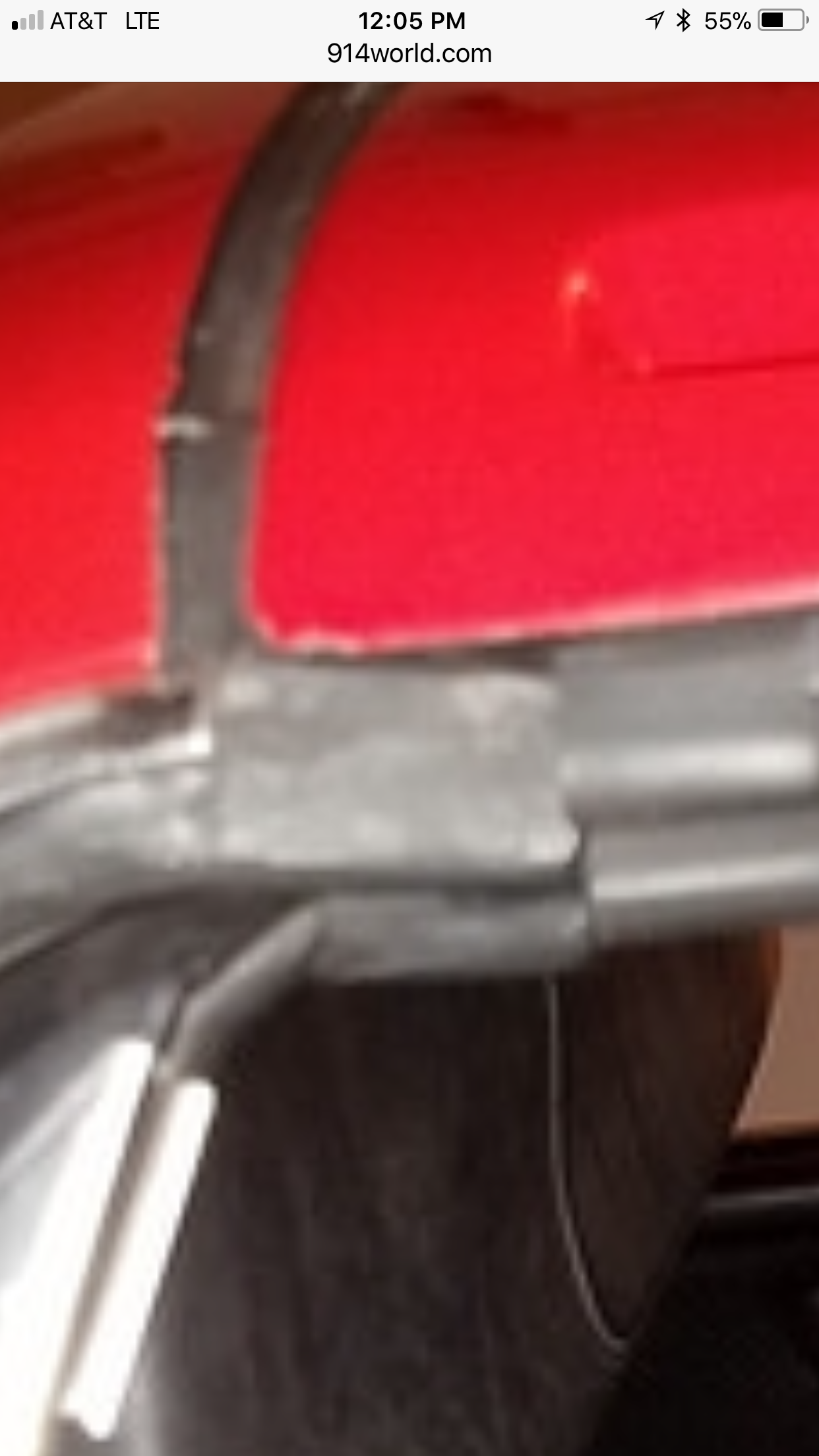

Something about the figment of the top seems off. I can’t comment on when the early/late top change took place. But what looks odd to me is the fitment of the front targa seal. The front targa seal goes across the top of the windshield frame and then down along the ‘A’ pillars. Where they meet the door vent window cap (the triangle plastic piece) there is what I’d call a nub of rubber. That piece on your car looks abnormally long. If that’s the case, it seems like it would be pushing the whole targa top towards the back of the car. And if THAT was the case, then the front would seem to fit fine but it would cause the back to pop up or bind a little when trying to latch the rear targa latches.
I’ll take some pictures in just a bit of what it should look like and see if my pics match your pics.

From: Mansfield, TX
Member No.: 1,419
Here...
Rob-O
post Mar 20 2018, 11:07 AM
Posts: 1,274
Joined: 5-December 03
From: Mansfield, TX
Member No.: 1,419
And here...

Can you show us a pic of the windshield/A-pillar seal with the top off?
Is the seal one piece or three pieces?
