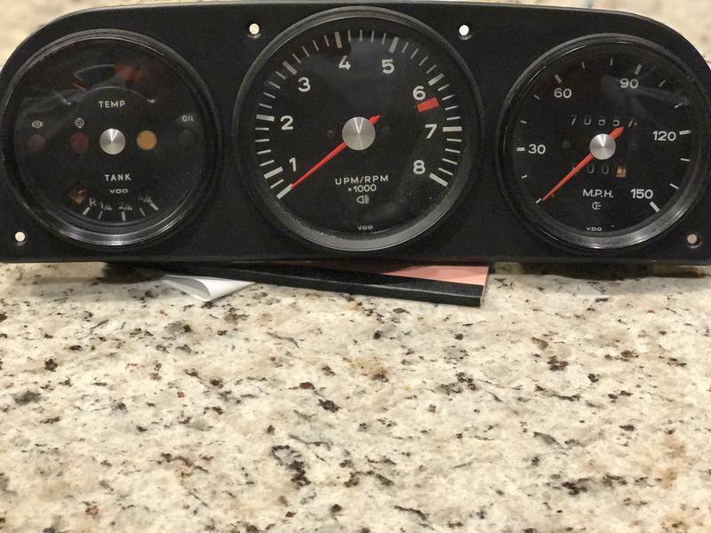

The Pretty Car came without gauges. Two weeks on eBay and I was able to separately source a 2 piece oil/fuel gauge, 150mph Speedo, and a 914-6 Tech that was new old stock, plus the bezel holding them all. Crossing my fingers the gauges don't require restoration.
(IMG:http://www.914world.com/bbs2/uploads_offsite/i.imgur.com-21443-1505966377.1.jpg)
