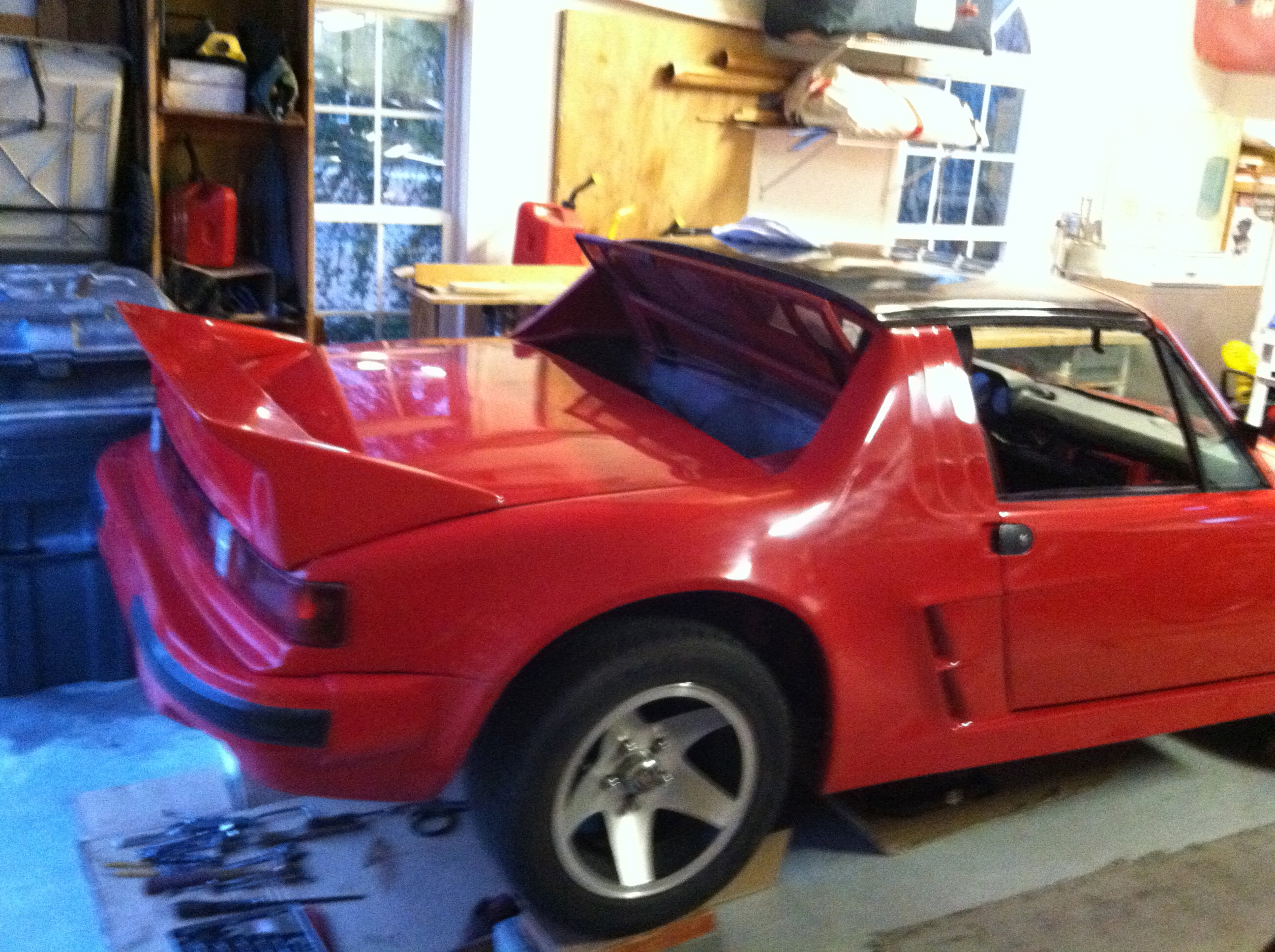

If you didn't see elsewhere this is a 1970 914 w/ a 327 and 901 transmission. I purchased the car from "Bullit" and here is some info I gotten thus far. The wiring harness is out of a '73; the front end is off a 911 but I forget which year w/ "M" calipers; Trailing arms have some of Foley's reinforcement kit; Engman inner stiffener kit was installed; Griffen radiator;window regulators from a '73; stock 914 1/2 shafts and a lot more which I'll note later.
I'm presently working on the rear brakes and trailing arms and have 2 questions. What is the torque valve for the nut that my torque wrench is attached to; 108 ft lb or 50 ft lb?
The manual says 50 for "Control arm bearing/body" and 108 ft lbs for the "Control arm bearing/control arm". Not sure which is which! (IMG:style_emoticons/default/confused24.gif)

108. 50 is for the 3 bolts on the "adjustment plate". You will want the susp loaded (at ride height) to set the rubber bushings. If it's not rubber then it won't matter.
"M" calipers are SC, 20mm rotors.
Oh, and nice score on the new project.
