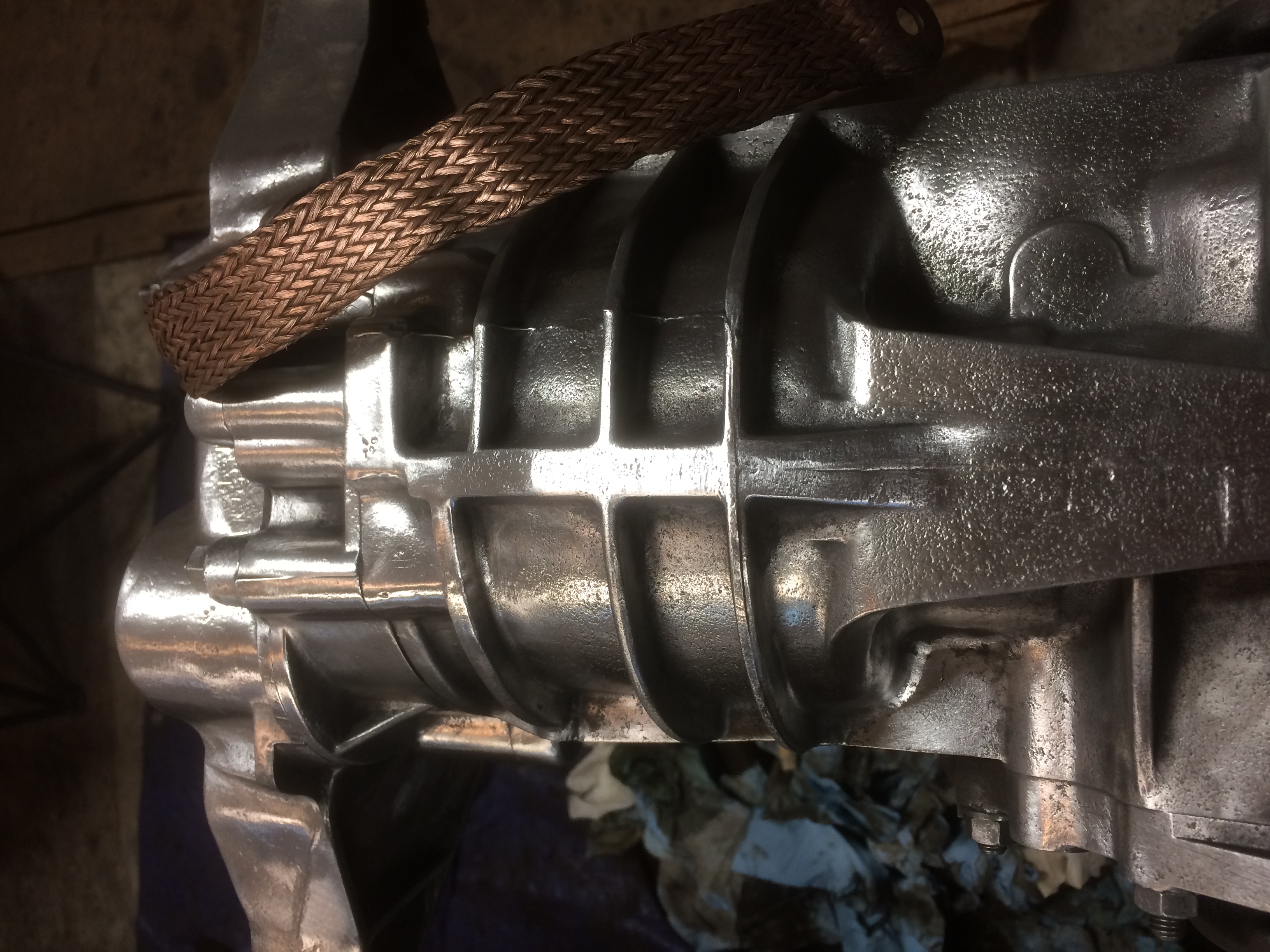

On that note the transmission case will not be blasted, but it was suggested that it be cleaned up with a wire brush and steel wool. Is that the correct way to go and similar to the shroud does it require a clear painted finish or just leave it alone. Here is a pic of a small section that I went over with steel wool after degreasing.

I wouldn't use a wire brush or wire wool on the trans case because you will burnish metal particles into the surface of the magnesium ,use the 3m green pads and their wheels you can put on a drill or die grinder,prep the surface super clean then put your chosen clearcoat on.

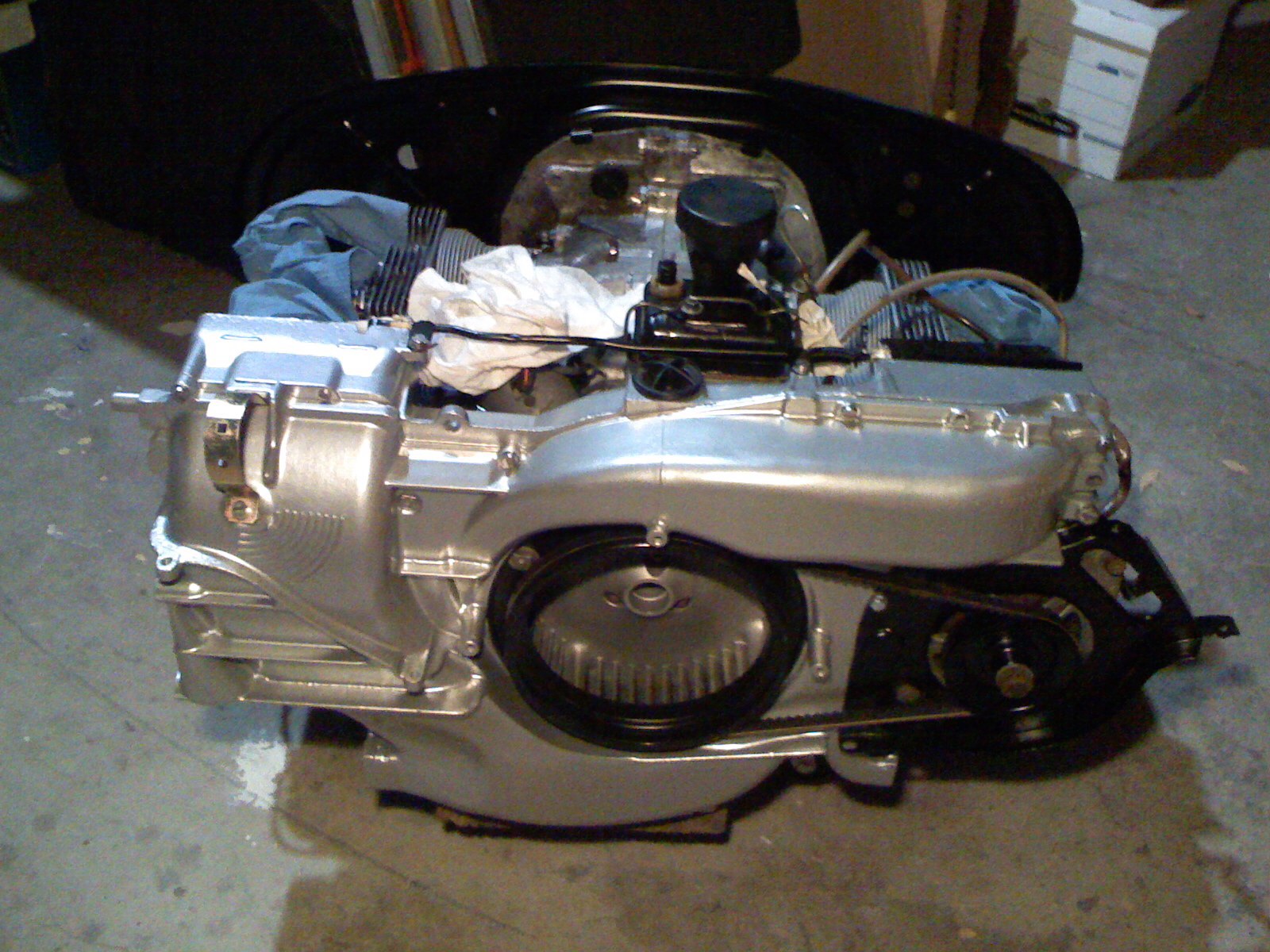

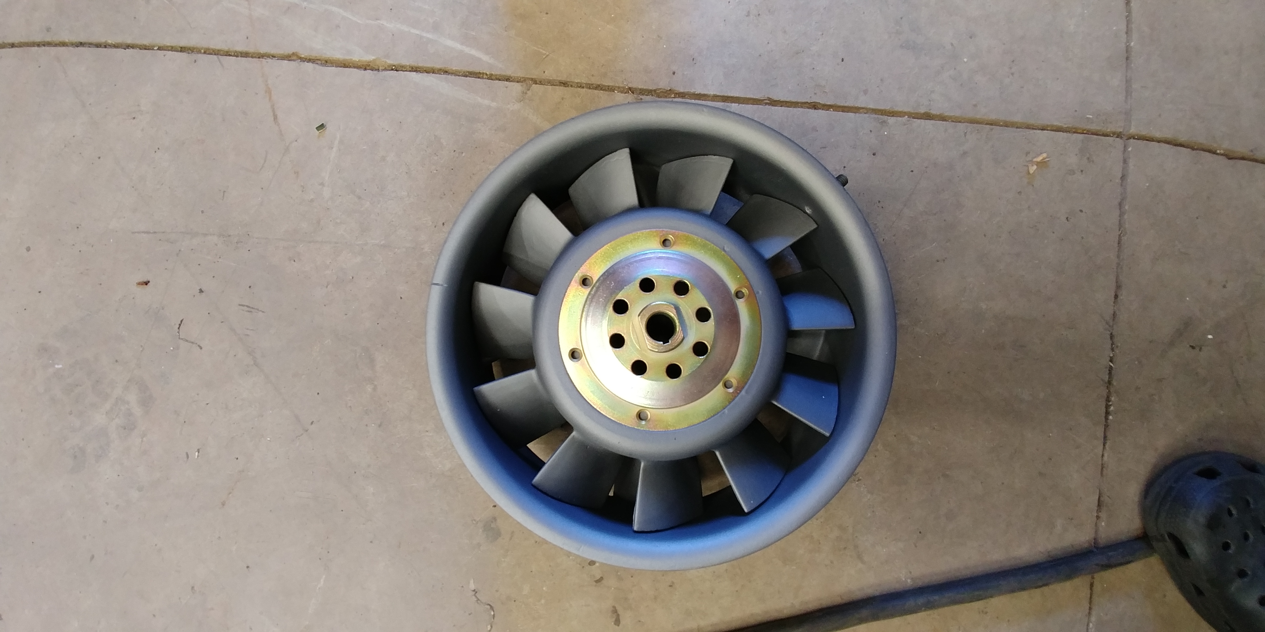

Sand blasted my fan shroud than power coat silver.

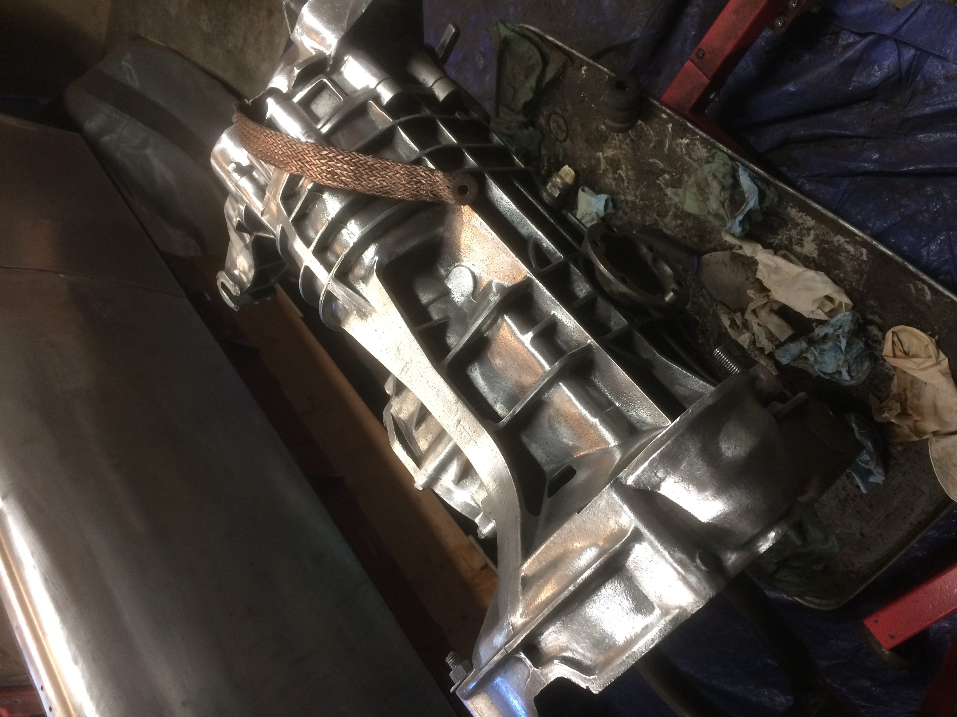

That fan shroud looks great (IMG:style_emoticons/default/shades.gif) Here is my trans getting the treatment... lots of elbow grease to remove road grime.

This is cerakote on magnesium.. It is a ceramic paint.. Very durable..

QUOTE(altitude411 @ Oct 19 2017, 03:08 PM) *
Beautiful!
But you're gonna cover the surface with the wax Dr. E talked about?
We’ve been using it more and more at the shop. You do need a real respirator to spray it. Strong stuff.

I sprayed it with my sata automotive sprayer. I have a bunch more paint. If anyone needs something sprayed.

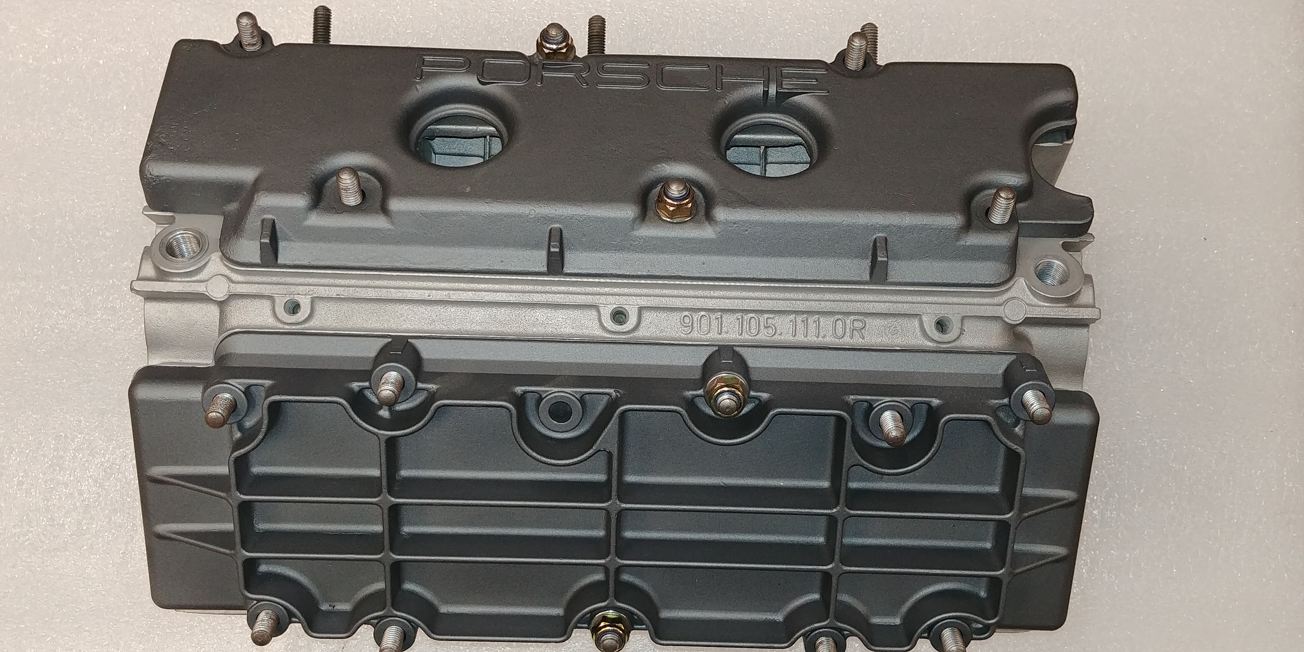

Here are my valve covers sprayed as well.. Attached Image

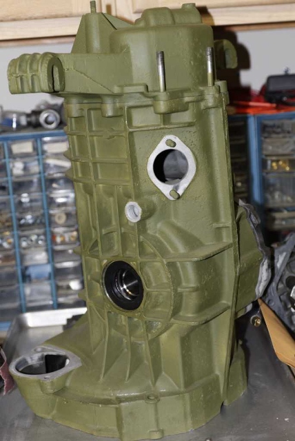

I did a little digging on what the aircraft and marine industry uses and ended doing the final wash on the raw case with Prekote surface pretreatment then priming with Zinc Chromate primer. Not sure what ill do for a top coat yet.Attached Image
Man, you are gonna be done pretty quick tomorrow as the cleaning is the longest part. I remember zinc chromate when I was working on aircraft and ships. The MSDS made it look like really nasty stuff. Should protect very well.
