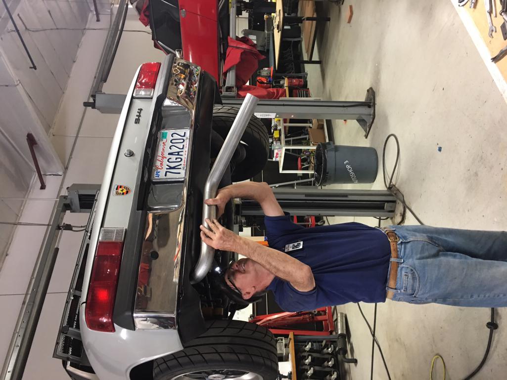

for general interest, a pic of our pal keith working on his car in the coveted upright position............
