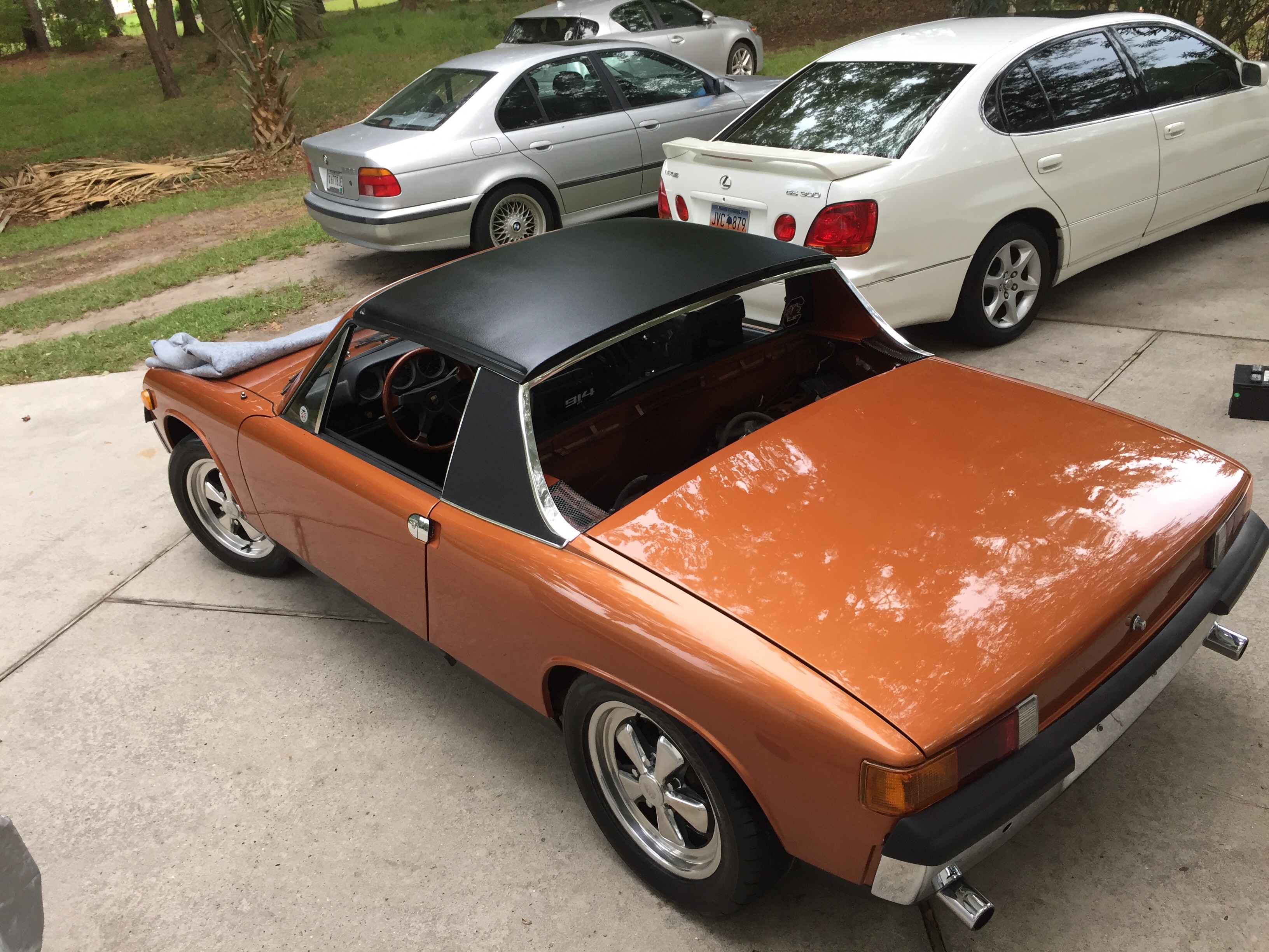

after 8 years of ownership, and 2 years of rust repair and other such stuff, i am fuinally getting ready to take it to get the fenders repaired the reat of the way and the crappy respray sanded off and car repainted.
i wantes to start a new thread apart from the failed entry into the first rebuild contest. with the help of BillH1963 and a friend of his (Mike) i hope to have this done in 2 months!
i am pulling this motor and transmission today.
stripping car down this week and next week taking bare car with windows out, interior out, up to Mikes shop up near Columbia SC.
They will be sanding it down by hand to the original primer and fixing and missed rust etc not repaired last year- as previously documented the floor pan rust jack points longs and pedal area were all repaired by Chis and Ed at Tangerine Racing in 2016. they also repaire the fender lips that were bent and damaged and massaged the rear fenders out to get room for the 7" fuchs. Now those will be smoothed out the rest of the way.
and a proper match of L99k copper metallic ( goimg with the PPG - thanks for advice on this from Bill Dunster!
will document this for fun and future reference-
car is original matching numbers 2.0 with appearance group car- but i decided this week
since i have 5 lug etc im goimg to back date the bumpers- none of this ruins originality as far as it cant be undone- i thint it will look better too
so here we go!!!

I'm glad you are getting the paint done. This car will look fantastic with a new coat of the very rare one year only Copper metallic!

That car looks great right now even with the primered fenders. After paint it will be fantastic. Nice job. Doing it right. (IMG:style_emoticons/default/biggrin.gif)

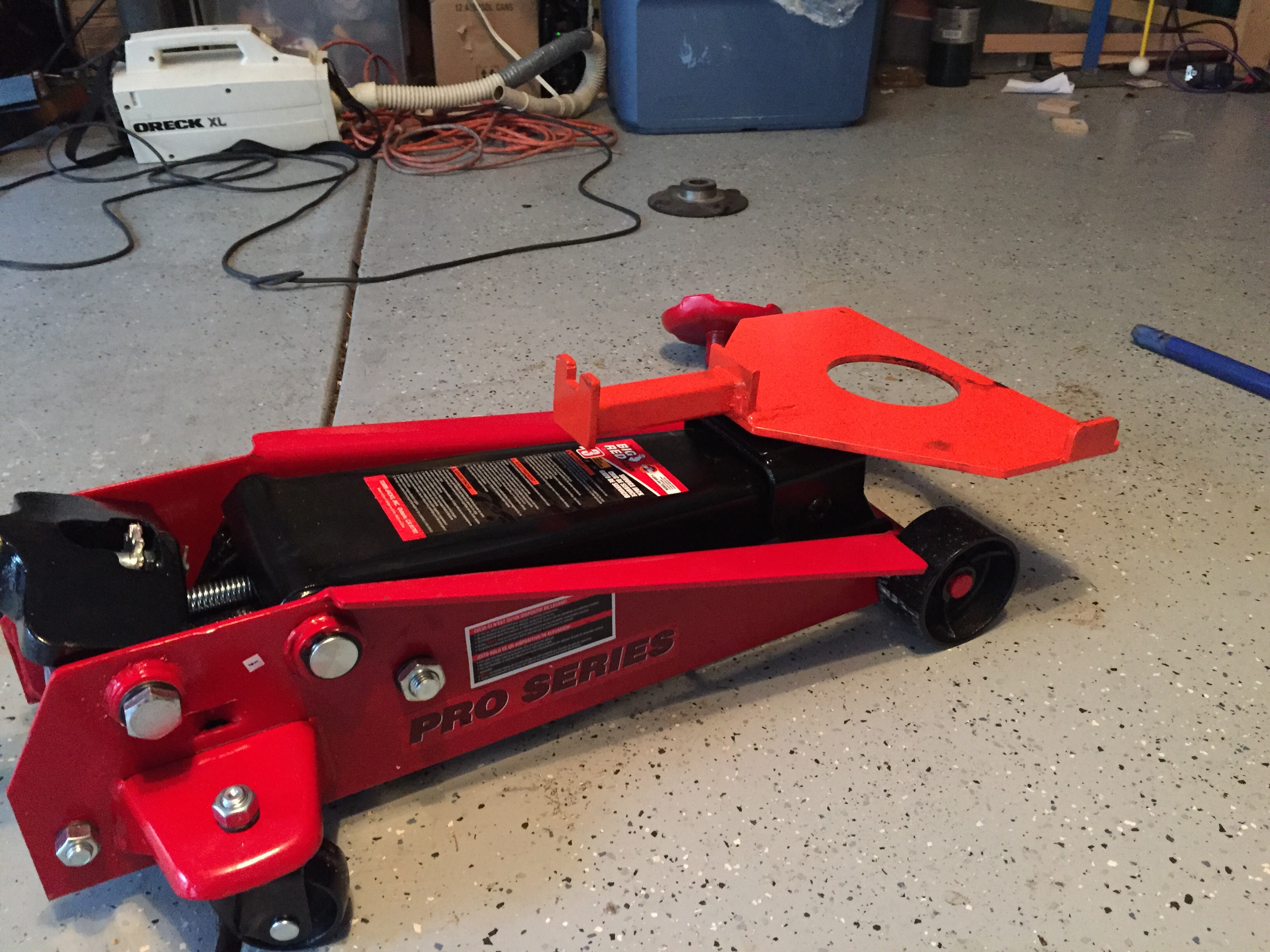

does anyone have a number for how high up i need to get car to get motor down and out? i have the motor lift plate from Tangerine.
and other than the jack donought where else can i put jack stands? they dont sit well on those jack points - wish the jack stands had a round support point to match up on there.

27 inches, rear fender to ground, I don't have a rear valance.

when i pulled the engine on my 4, i jacked up the car and slid an old set of car ramps under the rear wheels. They are probably only 12-18" high but with the rear tires sitting on the ramps, there was plenty of room to drop the engine. I did not have a rear valence on the car.
I wish I had used a tangerine lift adapter. I used one at Zach's house for his car and it makes it easy. Worth every penny even if you only use it a couple times.

so last night I did a dry run fit to see if jack goes up high enough- check! it goes up 25" , but the jack plate where the tuna can goes is a bit tight- I have the deep one and it was hard to get it lined up properly and slipped over the deep tuna can sump so I might remove that ( guess im doing another oil change). also I have plenty of leaks here and there, possibly the stock oil cooler and a few of the push rod tubes- I did new tubes and seals back when I did all my suspension and brakes a few years ago, same time I pulled the transmission and rebuilt it at an EVIL clinic, I also did the clutch pressure plate and flywheel and RMS at that time - I can happily report that the transmission and RMS are leak free still- so glad I don't have to go down that road. - I also hesitate to do much with anything else since the compression # were good- all 4 @ 135-140 when checked by CFR- chris said no reason to do anything there, leak down was good too., so makes me thing that this car with 153,000 miles must have had some type of refresh done at some point but I have no record of it ---
