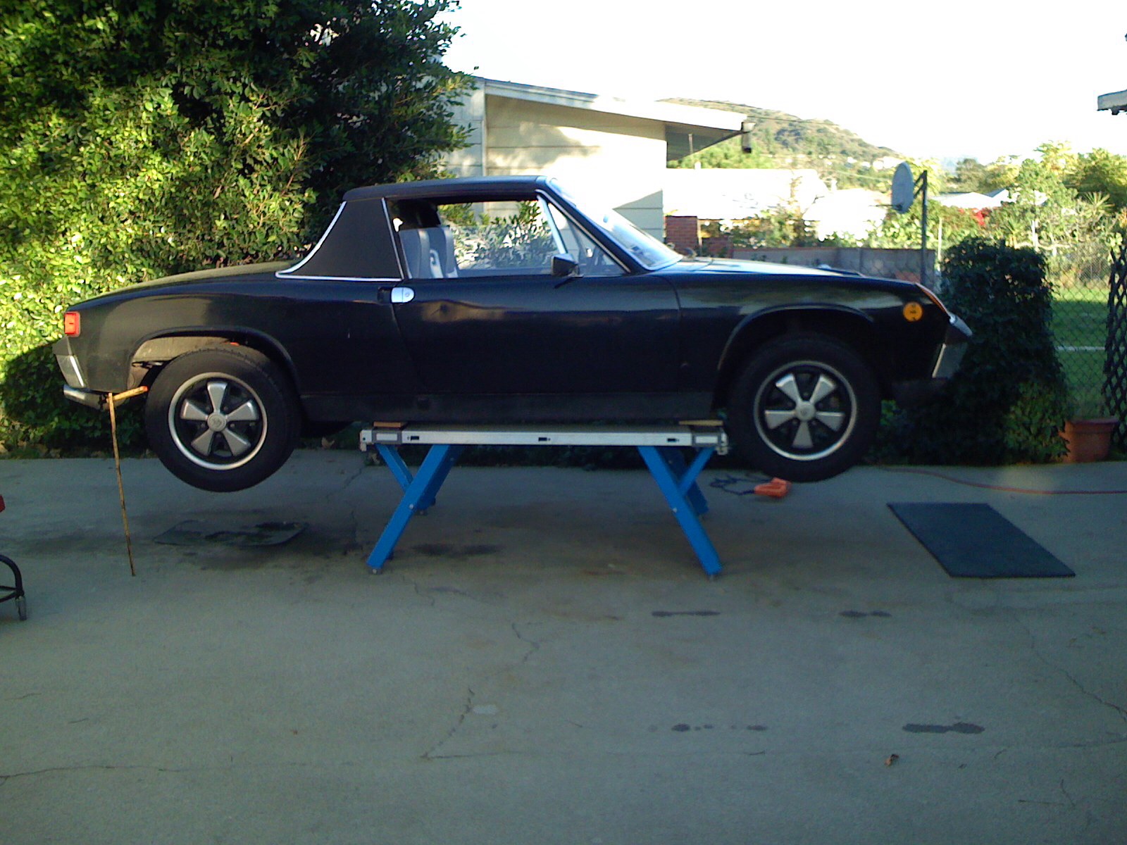

I used this EZ Car lift, the car spent 3 years up and down on this lift, I bought the wheel set so I could move it around.
Click to view attachmentPortable easy to move and store.

so last night I did a dry run fit to see if jack goes up high enough- check! it goes up 25" , but the jack plate where the tuna can goes is a bit tight- I have the deep one and it was hard to get it lined up properly and slipped over the deep tuna can sump so I might remove that ( guess im doing another oil change). also I have plenty of leaks here and there, possibly the stock oil cooler and a few of the push rod tubes- I did new tubes and seals back when I did all my suspension and brakes a few years ago, same time I pulled the transmission and rebuilt it at an EVIL clinic, I also did the clutch pressure plate and flywheel and RMS at that time - I can happily report that the transmission and RMS are leak free still- so glad I don't have to go down that road. - I also hesitate to do much with anything else since the compression # were good- all 4 @ 135-140 when checked by CFR- chris said no reason to do anything there, leak down was good too., so makes me thing that this car with 153,000 miles must have had some type of refresh done at some point but I have no record of it ---
